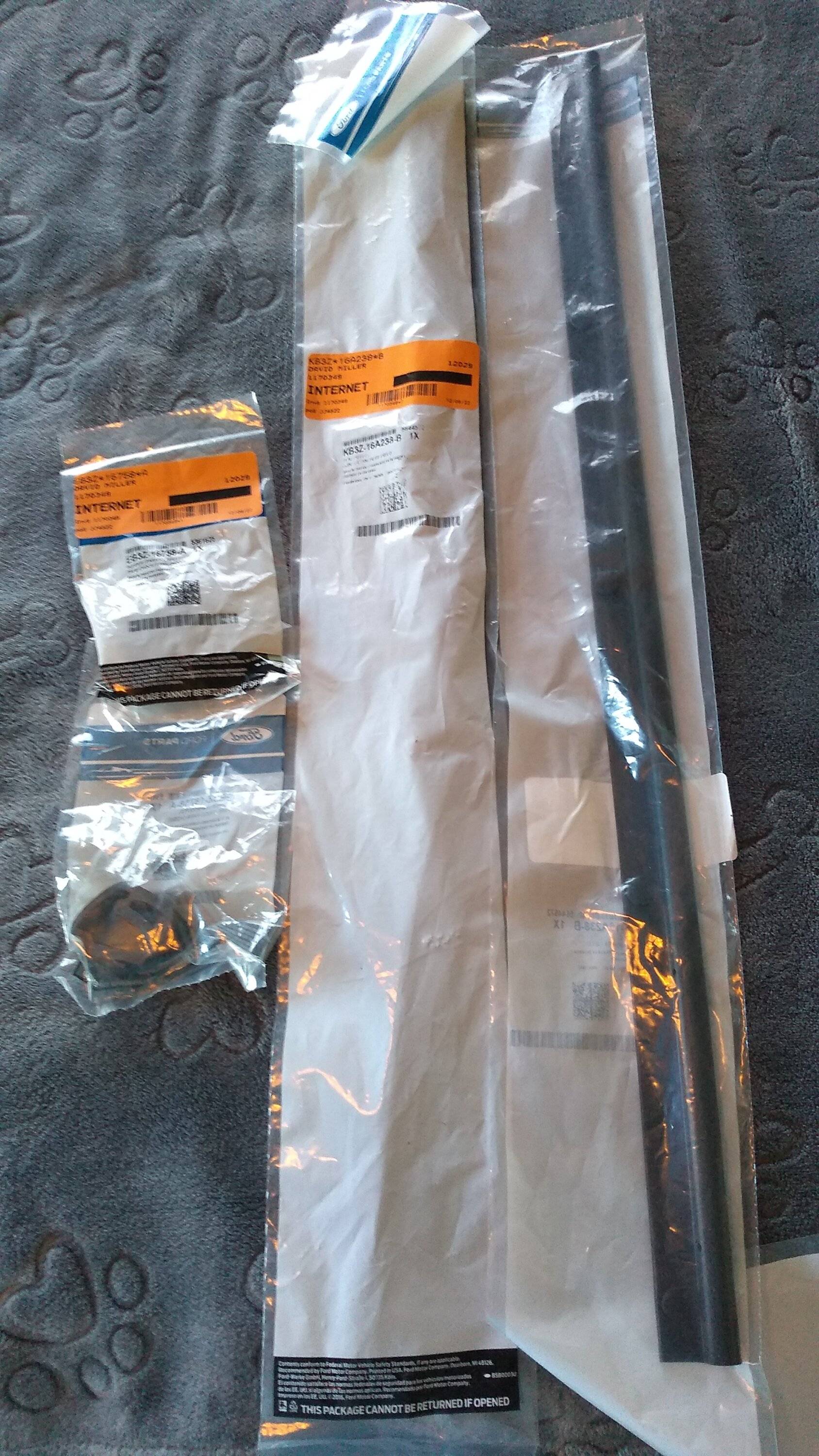

Good catch! Mine are missing too. Ordering them right now!
Edit: On the other hand,, maybe not. Can get two of them for less than $12. But everywhere I check wants another $10-$12 in shipping. I refuse on principle. Put the damn things in a padded envelope and mail it. Probably $4-5 total.
I wonder if Benny could get you a discount? @LevittownFordParts.com
And they came like this, I think in a skinny box:
Thx!
My truck has the weather stripping. Just want to add the bumpers.
I'll end up doing it. Shipping is just a sore point to me at times... like when it doubles the cost of an item.

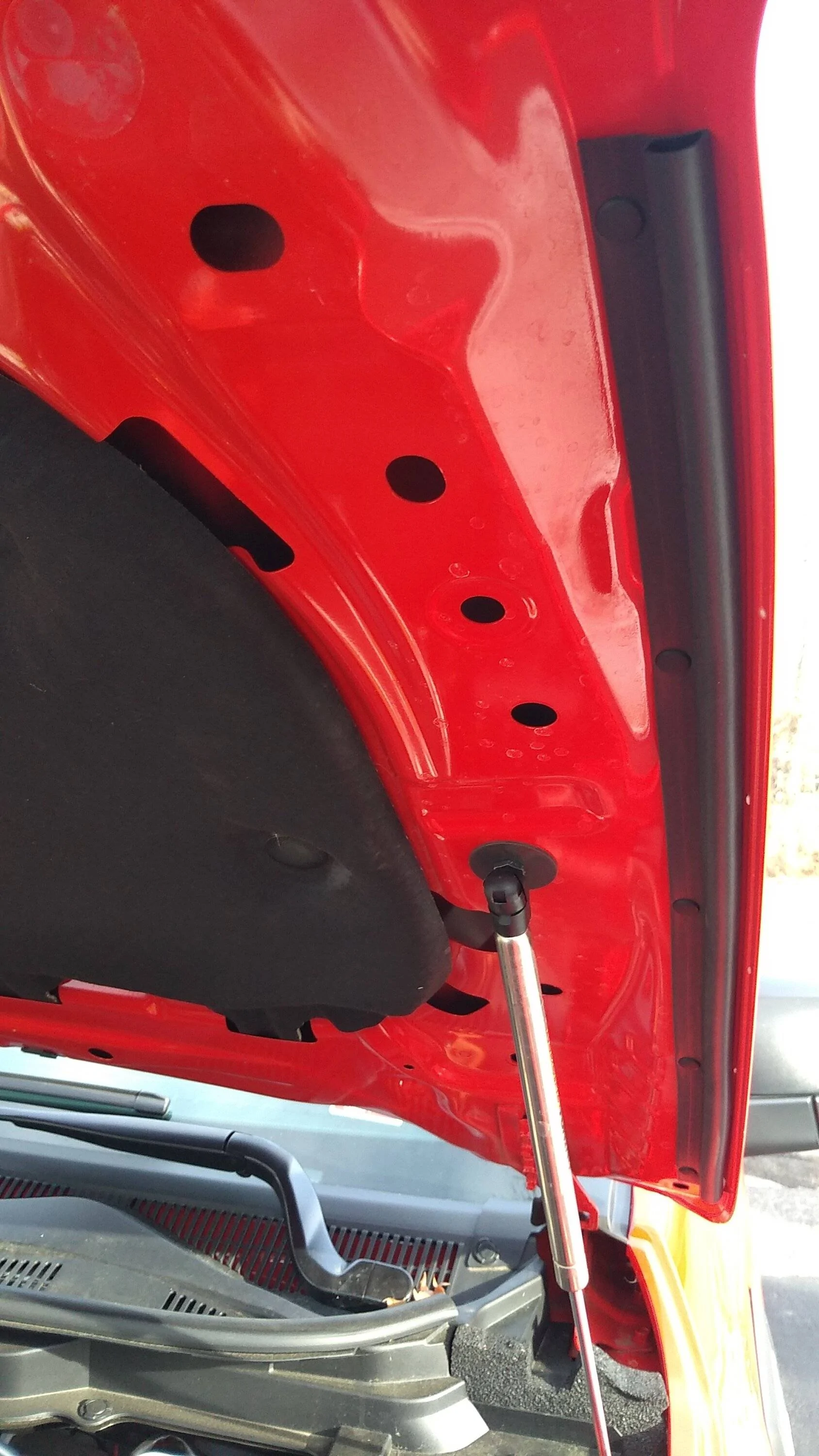

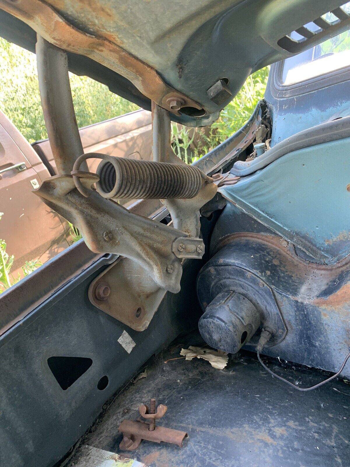

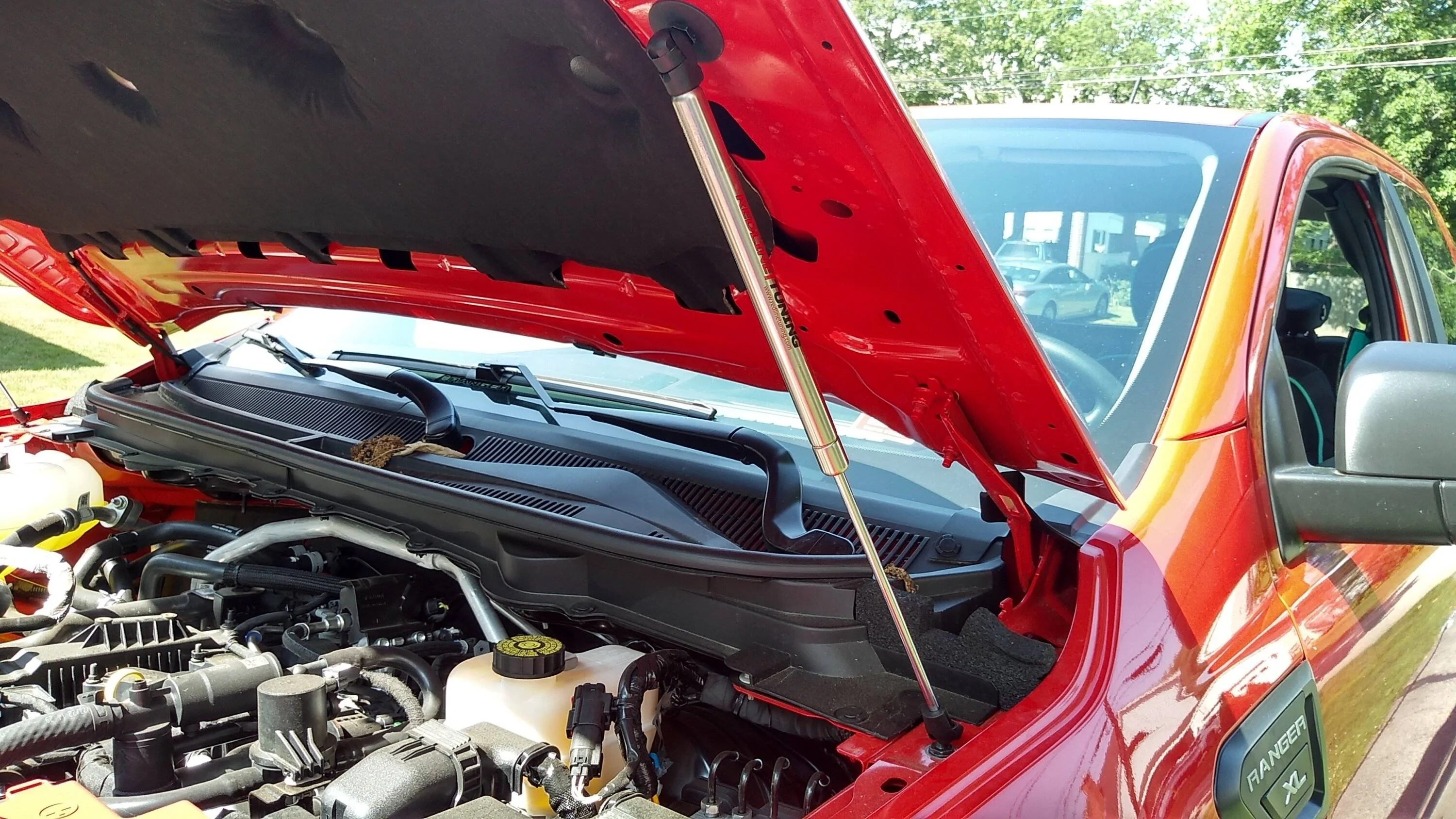

Sure rub it in, I suppose you also have the hood struts! =p
LOL, that was the deletion that I really affected my perception of the Ranger being a truck. I guess my frame of reference was old pickups and the massive springs they had.
The hood prop, even though that's all I've ever had on any of my vehicles, just felt wrong to me for the Ranger. So I added the Red Line ones ... =)
Of course, after adding the engine cover, I can just knock twice on the hood and the mice will open it! =D

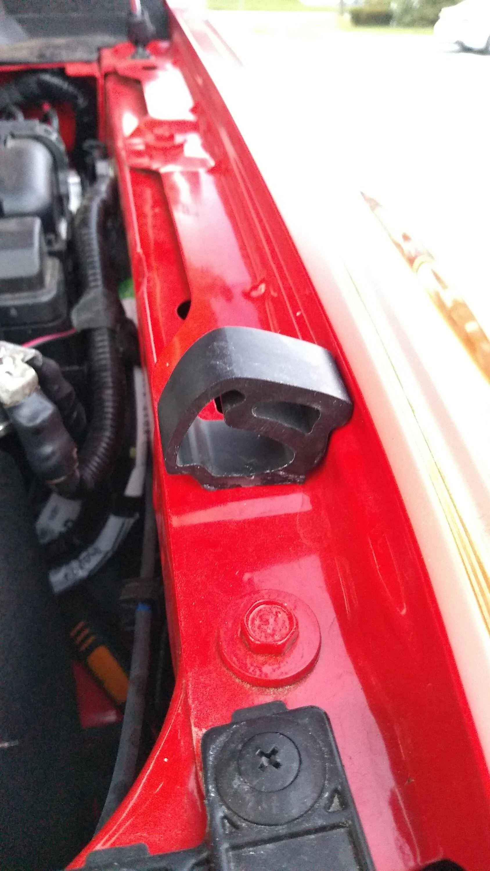

Can confirm that the MHU (Mouse Habitat Upgrade), or engine cover, does pretty much nothing for any engine noise. It's pretty small and lays flat above the engine with an inch or two of space to focus the sound out to the sides.
Now in my '22, I was missing the side weatherstripping and would suggest adding that along with the engine cover (if this was "decontented" from your '20). I can't really say that side weatherstripping makes any diff to the sound, but I'd think that has a greater effect than the cover (lol, one decibel decrease?).
Plus the weatherstripping is a whole lot cheaper than that cover! Side note, mine was also missing the hood bumpers and I added those at the same time and they were inexpensive.
Only sure fire thing I've found is to crank up the radio! =D
https://www.oemfordpart.com/oem-parts/ford-side-weather-strip-kb3z16a238b (2 needed)
https://www.oemfordpart.com/oem-parts/ford-bumper-eb3z16758a (2 needed)
I think the side seals main purpose is to help keep rain out.
On mine, that is missing said seals I'll occasionally see my relay block, battery, ect get droplets of water from heavier rains.
