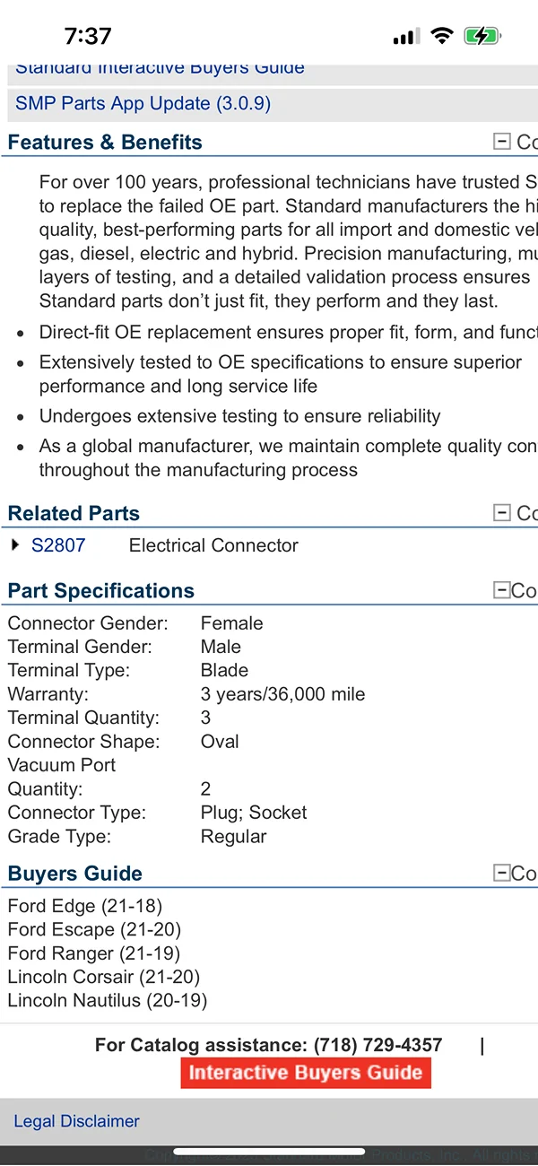

It’s probably because Standard Motor Products who is the supplier to Rock Auto lists it as fitting 2019-2021 Rangers in their catalog . They also list it fitting other Ford models too. We have a 2022 Escape PHEV that appears to have the exact same solenoid ( but has different hoses). And that’s not listed on Rock Auto or Standard Motors site either.
