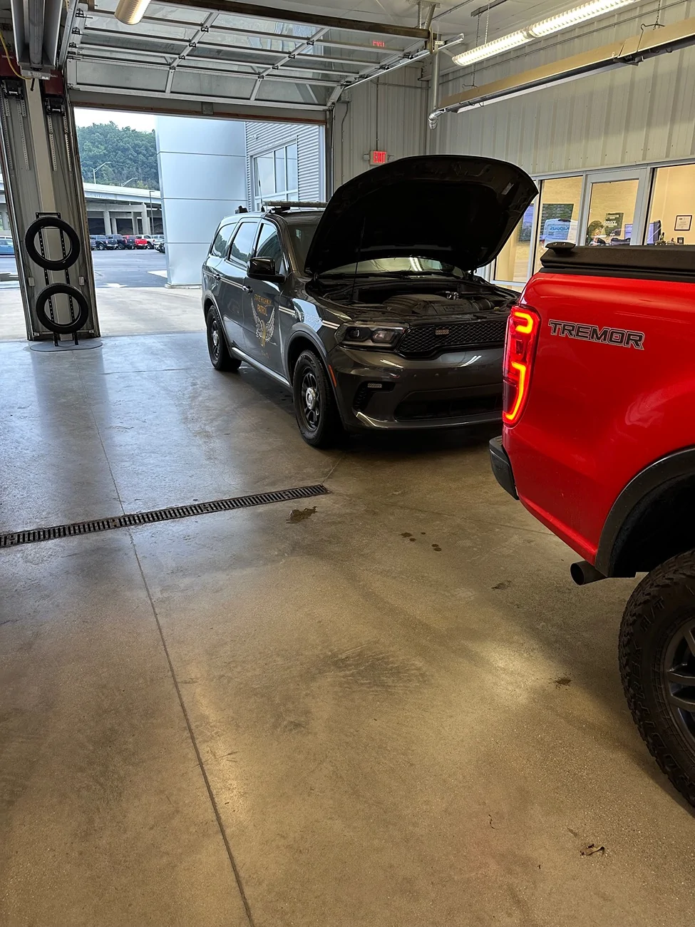

Ohio Highway patrol tried to pull me over I was running so good after the replacement, that they broke down trying to catch me šŸ˜‚
Those Durangos have v8s in them. OSP uses this ford dealer for maintenance the trooper I was talking to said.
