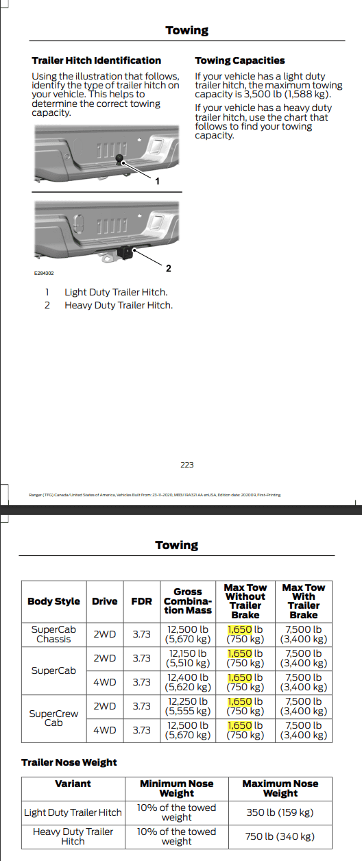

Any trailer over 1650 pounds needs brakes?
VAMike
Feb 22, 2019
3,390
4,414
Virginia
2019 Ranger Lariat SuperCab
I think we all can agree that If the bumper tow limit to 3,500 w/o brakes is correct
It isn't. The manual is just badly written. You need trailer brakes for anything over 1650lbs regardless of where you stick your ball.
The manual has actually managed to get worse--for 2023 the online manual points to the "ford towing guide" for weight limits, and that document doesn't mention brakes at all. But this is definitely an item for which common sense should indicate that the discrepancy is caused by ford's really terrible editors, and not that a bumper ball magically increases braking power.

Let me get this straight. Even though Illinois law states brakes are not required until you hit 3,000 lbs, Ford has it at 1,650?
ControlNode
1,736
3,758
Eastern NC
Computers
Well, that is my point. If the document is correct in that bumper tow is allowed to 3,500lb w/o brakes then tow package with hitch should be able to do the same, or bumper tow should have the same 1,650lb limit. Looking at the documentation that came with my 2021 it's not poorly written, it clearly states the 1,650lb limit is only with the heavy tow package. So, it's likely just wrong on that restriction, or wrong for not including the restriction on the bumper tow.
Yes.
Yes.
Again, this is an area where common sense should prevail. If you want to believe that a bumper ball magically increases the braking power of the truck it's not like I can stop you but I can call BS when I see it.
I encourage you to reread the manual. It does not "clearly state that the 1650lb limit is only with the tow package". AFAICT, it says absolutely nothing about trailer brakes when towing without the tow package. That is, it doesn't say that they're needed, it doesn't say that they're not needed, it simply neglects to say anything at all (because it's badly written and inconsistent). To me it's fairly obvious that they didn't bother putting the bumper ball limits into a table because the bumper ball capacity is low enough that the GCW of the various trim lines is irrelevant, but then they forgot to specify braked vs unbraked limits when they simplified the presentation. This is completely unsurprising as the number of errors and omissions in the manual is (IMO) excessive.

How have you misconstrued me pointing out the likely errors in the manual as me planning to go over the limits? I have no plans to bumper tow, since I have the tow package. I've been the one pointing out that restriction for heavy duty trailer hitch while omitted from Light Duty Trailer Hitch for a while. I read the manuals online before I bought my Ranger and had the dealer add in the brake controller with my purchase.
I've read it several times...
... The chart that has the 1,650lb limit only applies to heavy duty tow package. I don't believe one magically changes the braking ability of the truck over the other. I've stated either the restriction on the bumper tow is missing, or the tow package is restricted too low, I don't know which is the case since I'm not the engineer with enough data about the limits of the systems on this truck to determine that.
The simple, sensible answer would be to abide by the lower limit in the absence of data to the contrary, rather than act as though there's a deep mystery here.
But there is no lower limit provided for "Light Duty Trailer Hitch" in the Towing Capacities section, just the 3,500lb max towing limit. The 1,650lb limit is in a table that clearly is only intended to apply to "Heavy Duty Trailer Hitch".
