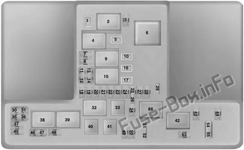

Actually, first thing I'd try is pulling the fuse for the trailer reverse light. Quick online search shows that it is 34 in the engine fuse box.

Update: BassRanger hit it on the nose. Pulled the fuse for the trailer reverse lights (#34) and everything works as it should. Thanks to all for your input. By the way, this thing tows about 4000 pounds like a champ!
