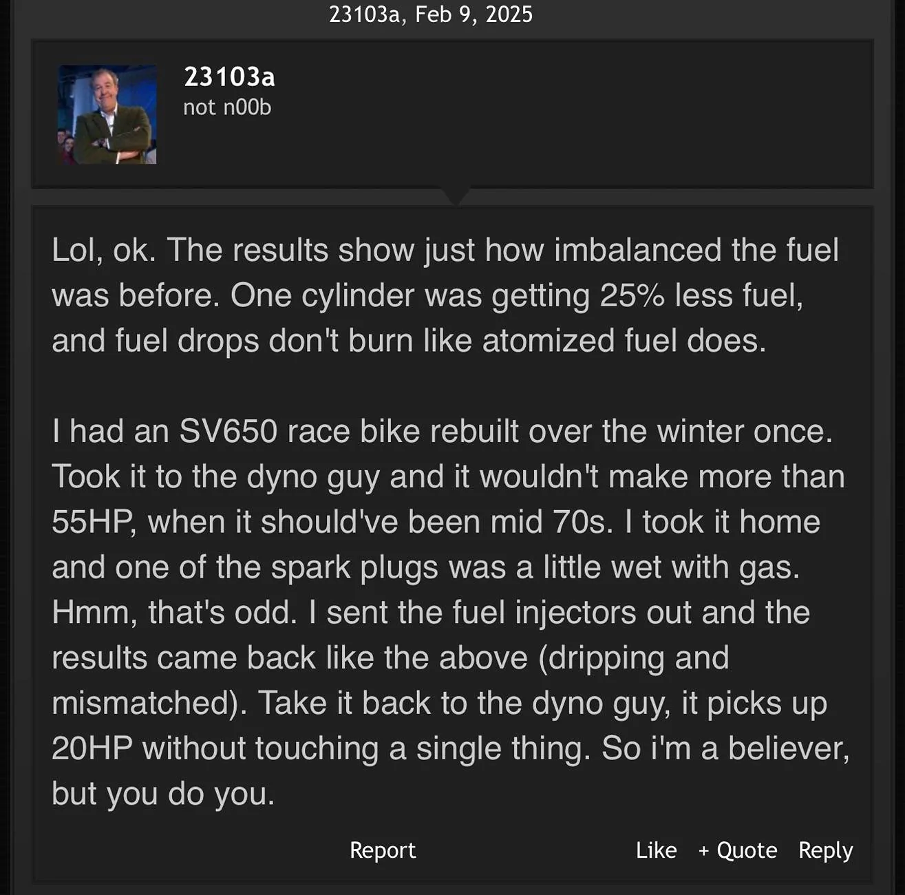

boy this topic came up on a motorcycle forum I’m a member of and the debate over whether or not it was a waste of money got sassy quickly. I appreciate everyone’s discussion here because this thread is productive.
For what it’s worth, one guy did share dyno numbers before and after injector cleaning on a Suzuki SV650 race bike. It made a noticeable difference on torque and horsepower. It was a bike tho. Our trucks are so different in design so… really to tough to say.
Here’s a screenshot of the comment:

Very Helpful info, thanks for sharing that post from another thread too. Good point with using sport mode every so often, fun stuff and helpful.
