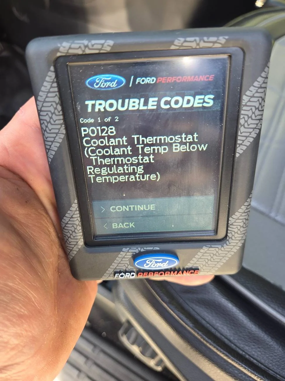

I just popped the P0128 code this morning and noticed on my OBD2 reader the ECT was staying around 165 170ish.
Potentially thermostat stuck open like a few of you.
Does anyone have a diagram for replacing or a view the housing?
Thanks

The shop manual says to remove the intake manifold first.

you do not have to remove the intake manifold, but you may need to remove the throttle body as the revised manuals call out - the intake is no longer required to be removed.
It all about how ambidextrous your hands are for access to anything earlier versions of the manual are not tweaked for some access points and have you remove items that are not actually required

I haven't had a chance to dig into it but that was my hope.
Will give it a shot once I get the thermostat in hand.
