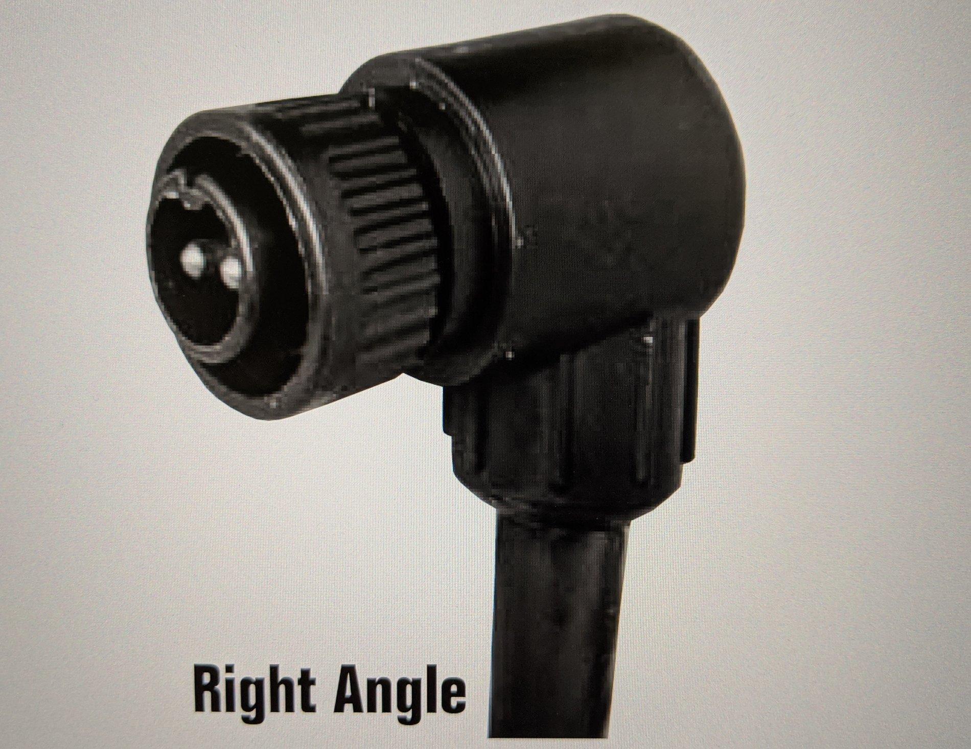

Received mine the other day. Very easy to put on. Many thanks
If an angled connection was part of the line up, I would have ordered that as well. Thing is, I'm not sure if there's 4 of them. (One pointing left, the others pointing right, up and down,) Or if one can be positioned to any direction.
I’d love one that’s pointed up, then you could easily mount the 12v connector under the bed rail.
