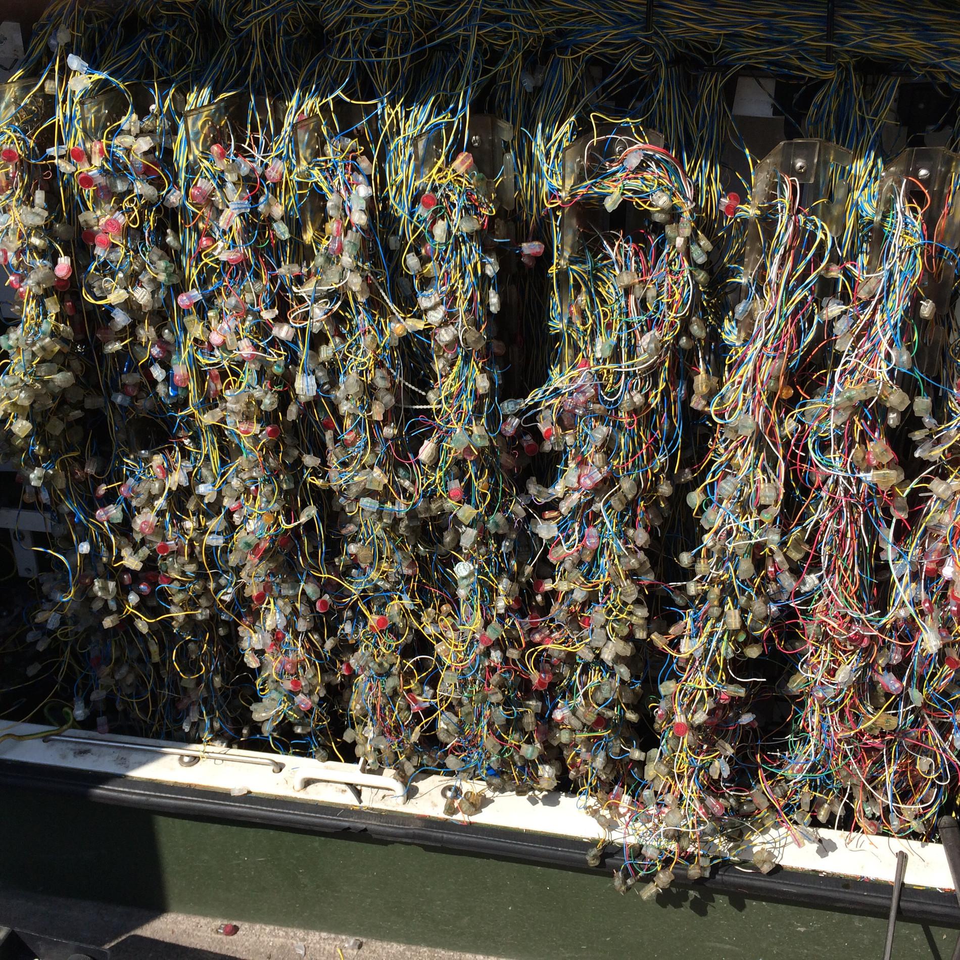

After I asked I read Daniel's post about the third brake light hack job and saw yours. Your mention of scotchloks conjured up this image for me.
OMG!
I am at a loss for words....
Reminds me of my younger says working as a field tech in a splicing can. Now that is a ton of bean splices....phone line pedestals, they are the worst!
It was actually a later experience for me in a small campus environment. Got to wear several different hats, which included sneaking down into manholes without a spotter or O2 sensor to chase fiber or copper OSP. Or popping the lid to find your splice cans under 6' of water.

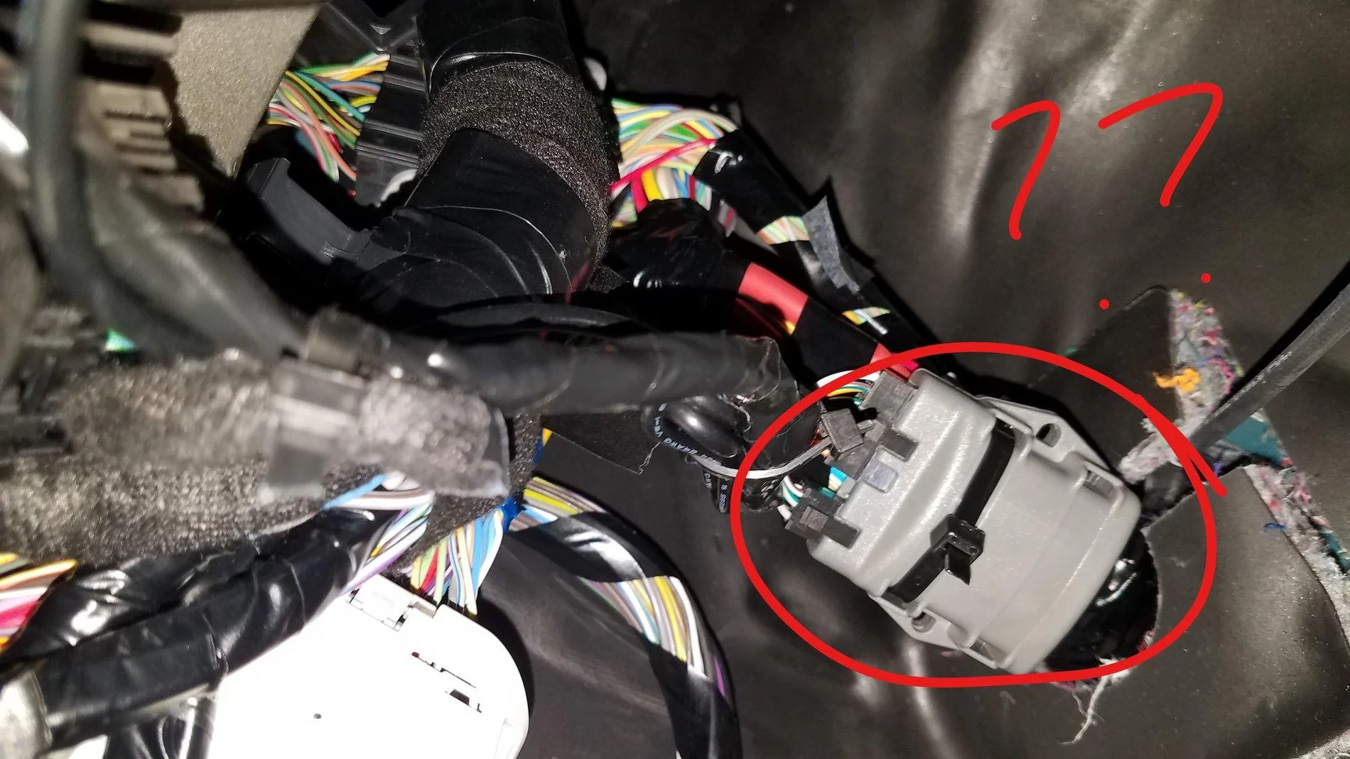

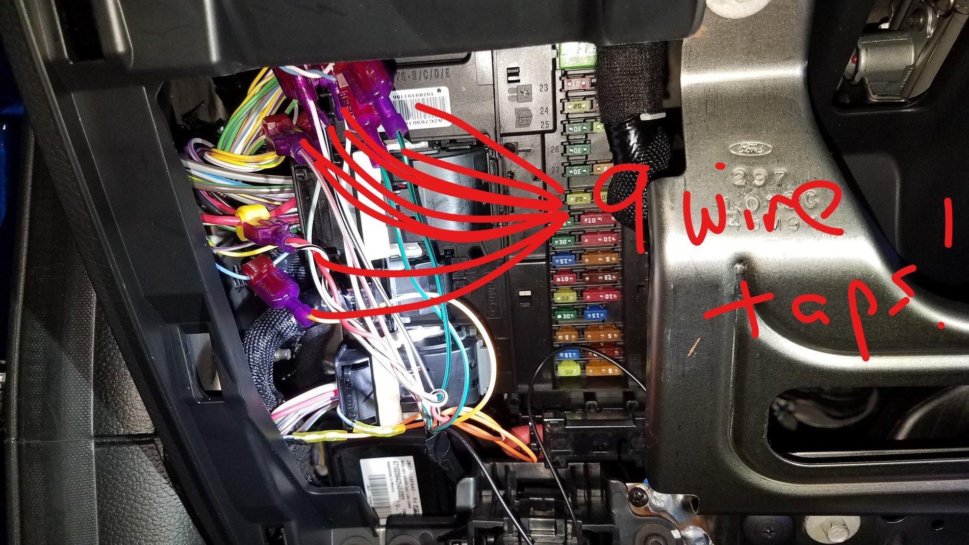

Hello Thomas, So I have some information for you per my Sales Manager. We are going to replace that panel that you took a picture of. We need a bigger picture that shows the panel's location. We want to make sure we order the right part. This will take a few weeks to please be patient with us we are on top of the situation. Thanks again for being a valued customer.
Sincerely,
Hmm. We went from you signed a disclosure and finance would have mentioned it to we are going to replace the panel. Um, not good enough. My reply...
Hi Shaun,
Obviously I did not receive a call from anyone today like I requested.
As for the panel, I will get you a picture that clearly shows the panel in question.
However, my bigger concern is the mess that may have been created with the wiring of the aftermarket alarm. I am hoping you overlooked telling me this would also be corrected. At this point if I ever decide to install an alarm of my choice, I would not have the original Ford wiring to work with. I would have to painstakingly remove the stuff your dealership installed and try to figure out which way is up. This is totally unacceptable. I will remove the panel tonight and take a look.
Please let all 3 of the people who chose not to call me that I will be on the phone with Ford Customer Service to see to it that I will not be pulling teeth to get this truck the way it should have been delivered to me...
No more than 15 minutes later I get a call from the Sales Manager. After listening to him try to explain to me the original factory wiring is not altered due to warranty requirements, I told him I would take a look underneath the panel. This was something I did not want to deal with last night. I told him that IF it was a simple couple of wires I may be able to live with it. What I found was at least 9 inline wire taps and an alarm module. Correct me if I am wrong, but you cant simple remove the wire taps. Now each and every one of those wires is compromised. Electrical tape? Not a chance.
I will be sending him an email tonight letting him now, according to Engineer Phil, that there is no practical was to replace the wiring harnesses. The "unbroken" wires from these harness run through the entire truck to the doors, the lights, the everything!
Below are 2 pictures. If anyone on the forum has a chance to take a picture, and post it, from the same angle as mine WITHOUT the purple wire taps it would be GREATLY APPRECIATED.

Hi KTM,
Yep...similar to what I found, however in following some wires, I had to remove the left front door sill trim panel where there was another splice. You will likely trace and fine a couple more elsewhere than the 9 you id'd. So your zip tied module looks different than the black one I found, the whole install is reminiscent of my horror. I too had to have the dealer replace the panel where the famous "jumper" module was installed as they could not even install this correctly as it was canted about 10° off level. This jumper module was to disable the "feature" for those customers declining this "enhanced" system... I told my salesman and he said "we have never had a problem" with the system installation...Yeah, Right! BS.
Good Luck!

Well today I received a call from the company that installed the alarm. He left a message asking me to call back so they could schedule a time at my house or at the dealership to remove the alarm system. I also have a call into to Ford customer service. Apparently to speak to someone in the U.S., they person in Manila had to elevate my issue by creating a case #. now I wait patiently for a call within 1 to 6 business days. I will practice patience and wait for that call before I contact the alarm company. I don't think I should settle on simply removing the wire taps and covering everything up with crimps and tape.
Thanks Phil for your input!
I'd expect them to simply unplug the spade lugs and remove their stuff, leaving behind the t-taps. At this point they're likely helping to maintain some integrity to the original harness wiring. I also wouldn't think they'd use high quality butt connectors if they do remove the t-tap. What are your expectations at this point?
