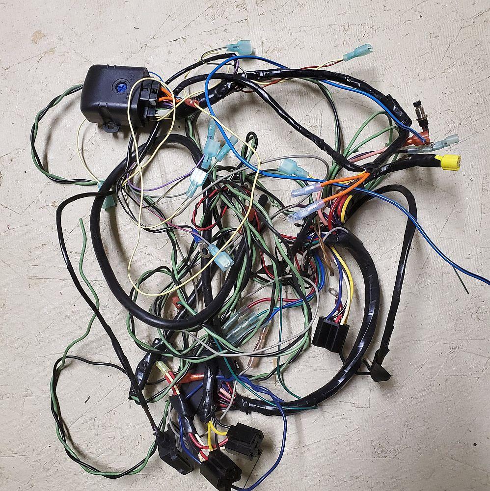

My local dealer does something similar. The install looks if done by ax. The OEM system cannot be restored due to wire splices etc. I pulled this out of two vehicles I bought from them and repaired the wire splices with pricey but robust butt crimp splices we used in off road racing. As a result, when I purchased my Lincoln (Tucson branch of Jim Click Ford here in Tucson), I demanded that the alarm not be installed or there was no deal, so I got a vehicle off the haulaway. As for my Ranger, I purchased from a dealer 50 miles away which does not do this crap. The takeaway here is that the vehicle cannot be returned to OEM due to wiring harness damage and you do not what to have the complete wiring changed out as you will have warranty return after return as it is almost impossible for a dealership to get it right and they would likely decline. You best bet is a local buyback and find another dealer that does not do this BS.
Here is a picture of the rats nest I pulled out of my 2011 Escape

Hi KTM,
I can see that freakin' mess leading to a different perspective from mine. Why'd you go butt connectors instead of solder with some heat shrink tubing?
These butt connectors are same as approved by FAA for repair of Airliners. They are not autostore parts. I have a special crimping tool that goes with them. I get them at Terminal Supply. The outer sleave is shrink tubing with a hot melt glue that glues to the wire sheath making a robust connection.
Solder on the other hand is a big no no on automotive wiring. The solder is solid and where this solid solder stops creates a stress concentration in the wire and can and does lead to internal failure of the copper. Shrink tubing that does not bond to the wiring sheath does help a bit but why take the risk... When I started managing offroad racing The Ford racetrucks failure rate was about 75% and most electrical. We instituted a requirement to switch to the type of butt connectors sold by ReyChem or Terminal supply...It is now very uncommon for the race teams to have electrical failures due to wiring.
