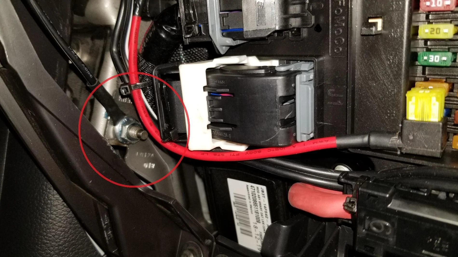

Fuse 37 - in cabin fuse box:
Grounding point used:
Power to battery backup ran under the AC blower:
Backup Battery in the glove compartment:

Is this the factory ground point or just what you used?
I didn't dig around too much for a factory grounding point so I just used what was nearby. I presume you'd find one just below this area in the driver's kick panel. I just didn't wanna take it off if I didn't have to.
