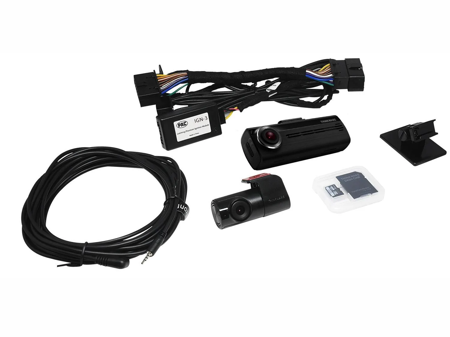

I don't see enough cable length to power the main dashcam, assuming it's running from the passenger fuse box. Makes me think the harness plugs into somewhere under the headliner or A-pillar.
Found some install instructions - searched for the part number and it appears that this cam was originally designed for the Edge. And unfortunately it's prewired to use the OBDII port.
Thanks. I will definitely not go the ODBII route.
