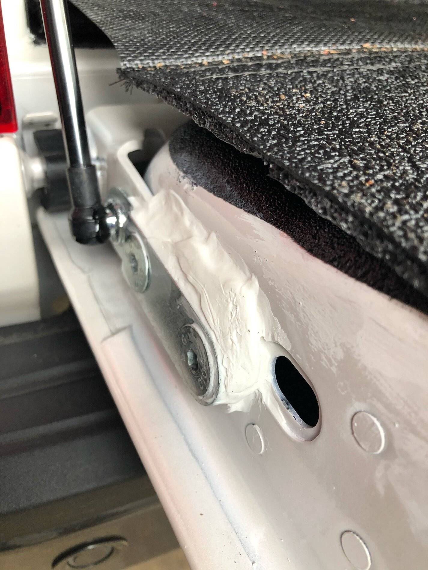

OK, here is my damper mod. I tried to build up a little 'ramp' using caulk for the cable to slide down, but after about 6 layers it still didn't work, the cable just hung up on the lip of the bracket. So, I gave it a huge bead of caulk, and it works. It's difficult to see since I used white caulk and the truck is white, so hope you get the idea.
The idea is the cable needs to be trained to go the right of the damper, and then it needs to not get stuck on the damper mounting bracket.
And, yes, it looks like hell, because of so many layers and trying to smooth it out with my finger, but hey, deal with it. :)

Full marks for ingenuity. I didn’t notice at all that it looked like a bad icing job on a cake. ? Here’s a small trick of the trade - dip your finger in liquid dish soap before smoothing silicone caulk - it won’t stick to your finger and it stays where you want it to. ? Also, you can still add a bit more caulk and try out the soap technique.

Thanks for that. I may do another coat to clean it up a bit, just because I'm anal. I will try your trick of wet fingers or possibly with a bit of soap, thanks for that.

Have you tried the velcro mod? It's a lot simpler, takes literally 10 seconds and 100% effective at keeping the cable from getting bound...anal's fun but this is less painful... ?
