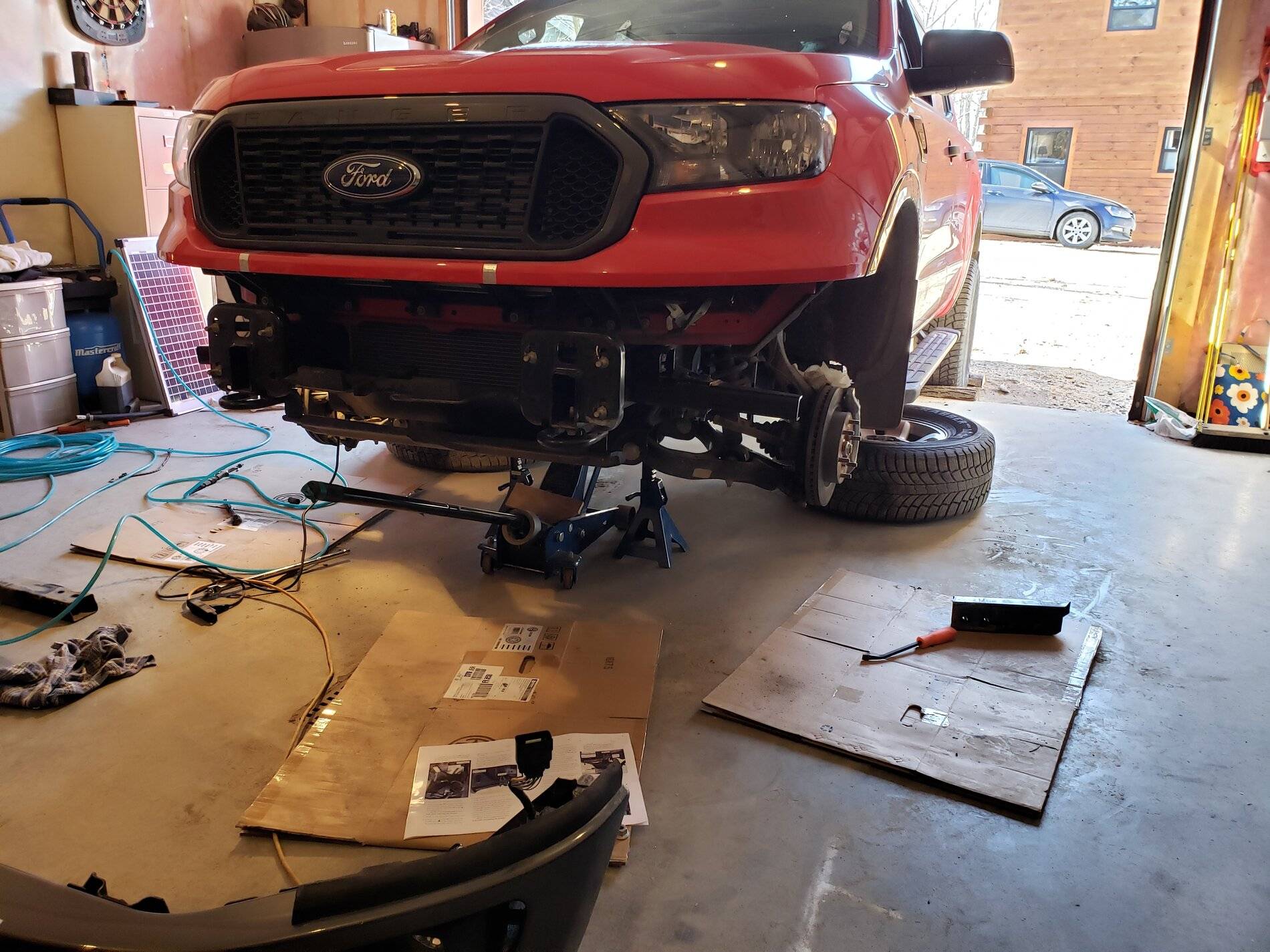

I did remove the front bumper, not a tough job at all and I'm glad i did. You can see from the pictures in my showcase ( https://www.ranger5g.com/forum/showcase/canadian-2020-ford-ranger.570/ ), I put some tape to mark the location on the bumper to make sure I was reinstalling at the same location. With the bumper removed, you just remove the bolts and slide out the beams, very easy.
For the rear beams, I cut as much as i could with a cutting wheel and finished them with a sawzall. I went thru 4 blades...not easy but doable.
