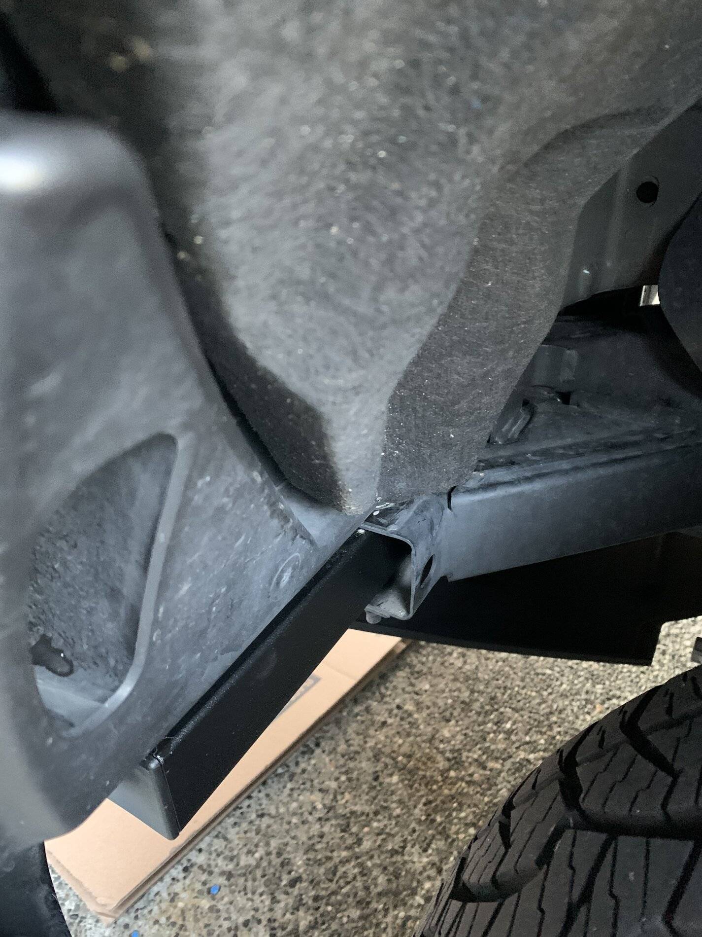

K got the fronts done but ran outta light, so will have to do rears tomorrow. Removing the bumper was a pain in the ass….. i hate any manufacturer that uses those cheap flimsy clips that break and fall off so easily lol.
