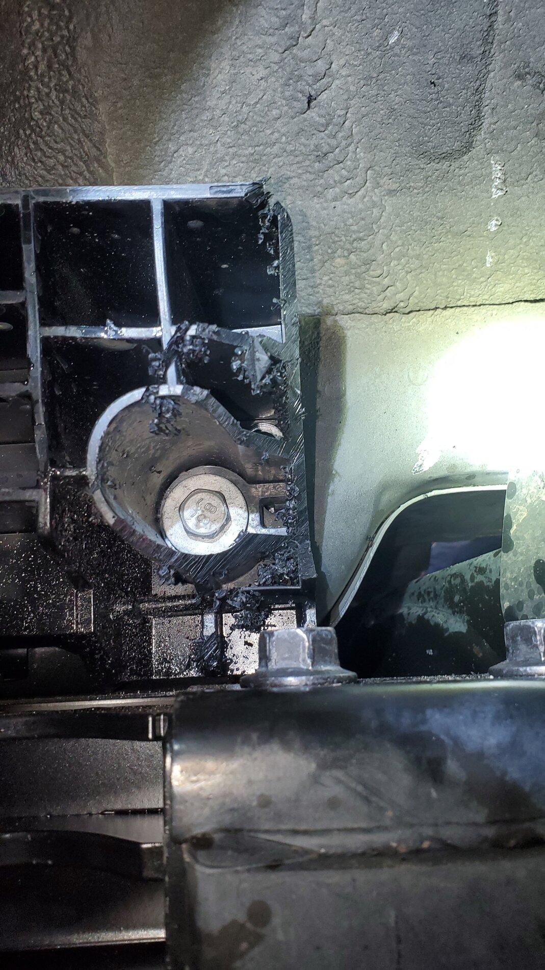

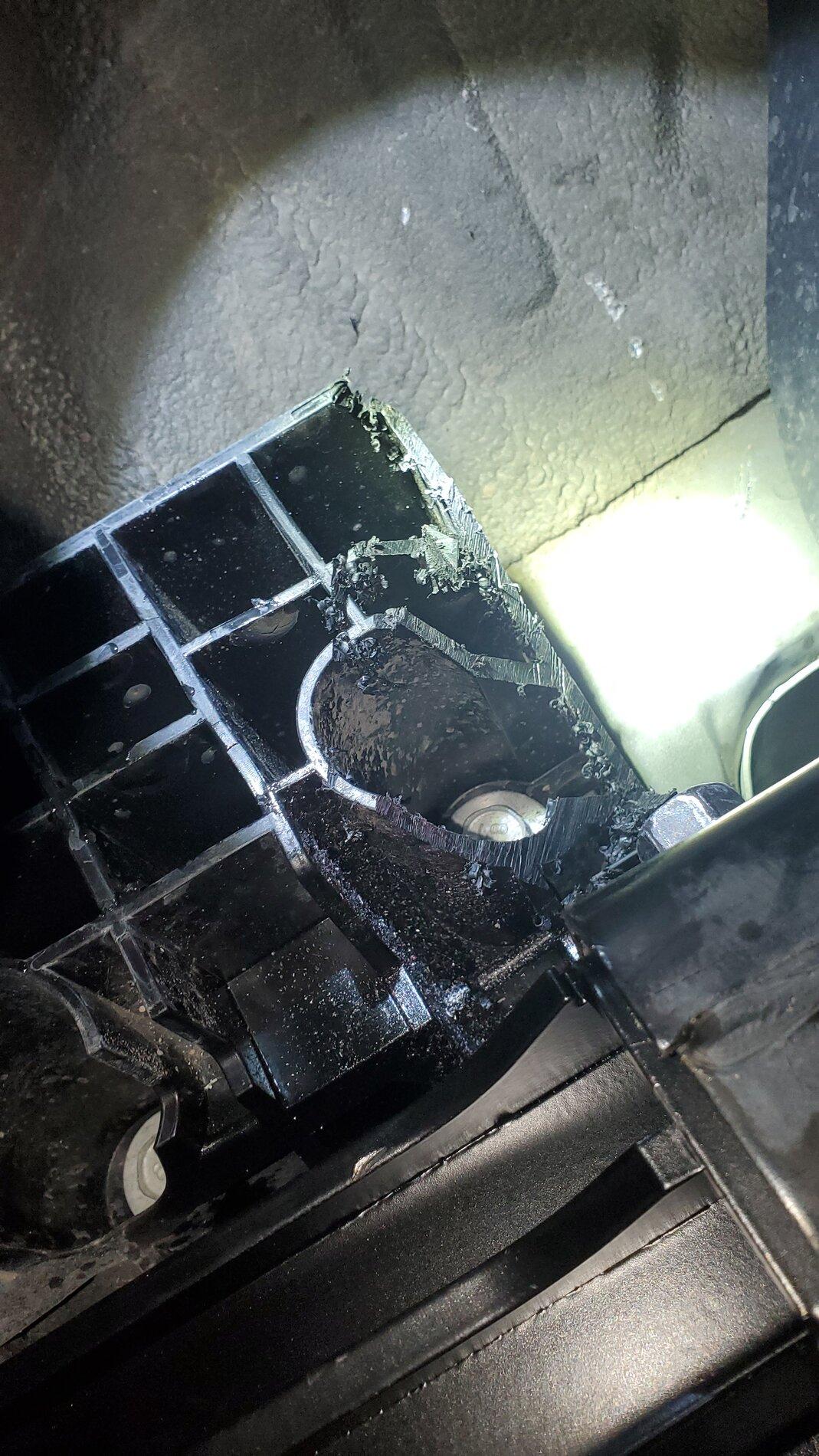

No I had to cut the plastic crash plate things on the rear ones. The outer most bolt hits them. I've already done enough to void my warranty so I wasn't worried about cutting some of the plastic away to save me from having to take apart the entire wheelwell. Here's some pics of the damage...
Not my proudest hack job, but it got the job done.
Thanks for getting back to me. I was actually able to remove that plastic crash plate (4 bolts) after removing 4 plastic push pins in the fender liner so I could pull it back just enough to gain access to it. Then I was able cut through the metal with ease and slide the crash bar out once I removed the 2 crash bar bolts.
I figured you could probably get it out by removing those pins and pulling it back, I just didn't wanna test the rigidity of the liner and end up ripping that or creasing it. Glad you got it out the right way tho haha

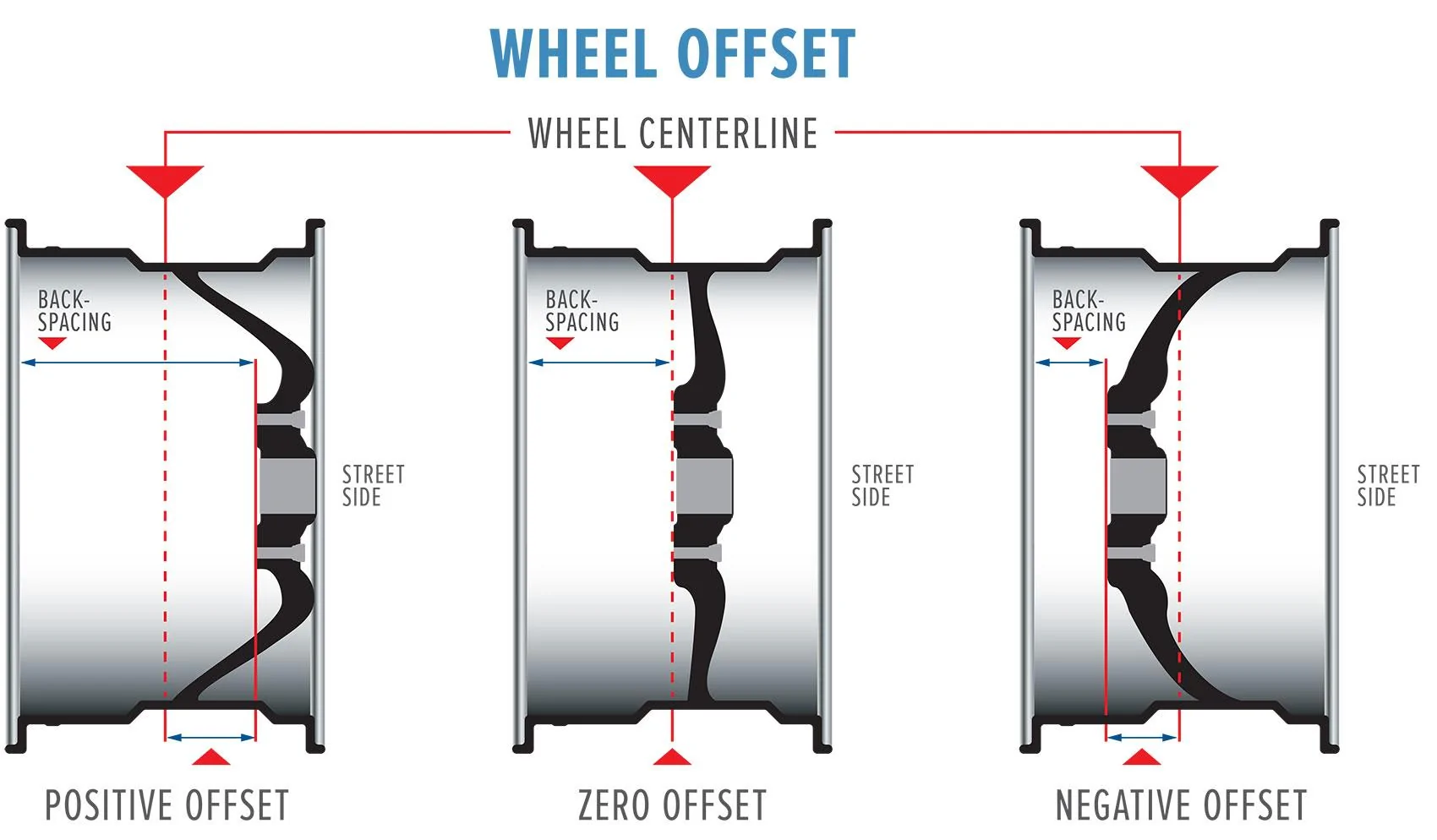

I have zero offset with 4.75" of backspacing. If you have less backspacing or more offset you probably won't rub, but should still get intrusion beams in my opinion.
so would I want to go with a +12 or a -offset?

I got a tremor and a set of Method 703 17x8.5 +35 offset and 6,2" backspacing that i will install this spring.
Even stock, it is very tight with the factory crash bars. I will keep the same size tires (265/70/17).
The new setup will push the tire only a 1/2 inch out. It will definitely rub on the front crash bar but not sure for the rear. So i purchased these Readylift beams.

I'm running 265/70/17 on a 17x9 wheel with +20 offset.
No rubbing on stock crash bars.
Since you'll be running +35 wheels I don't think you'll experience any issues.
While every truck may be a little different and YMMV, I don't think you'll really need the aftermarket crash bars with your setup.
Quite surprised you don't get any rubbing. I don't even see an 1/2 inch of space between the tire and front bar at full turn on my stock setup. Thanks, i might wait and test fit before and ask for a refund on the crash bars if it fits perfectly without it.
