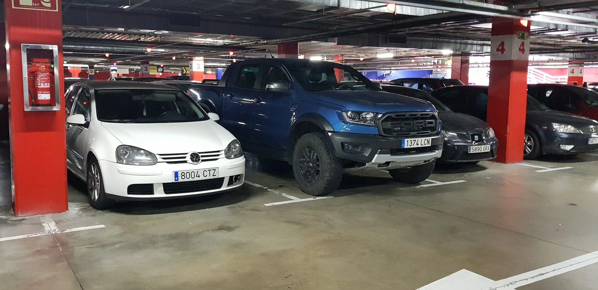

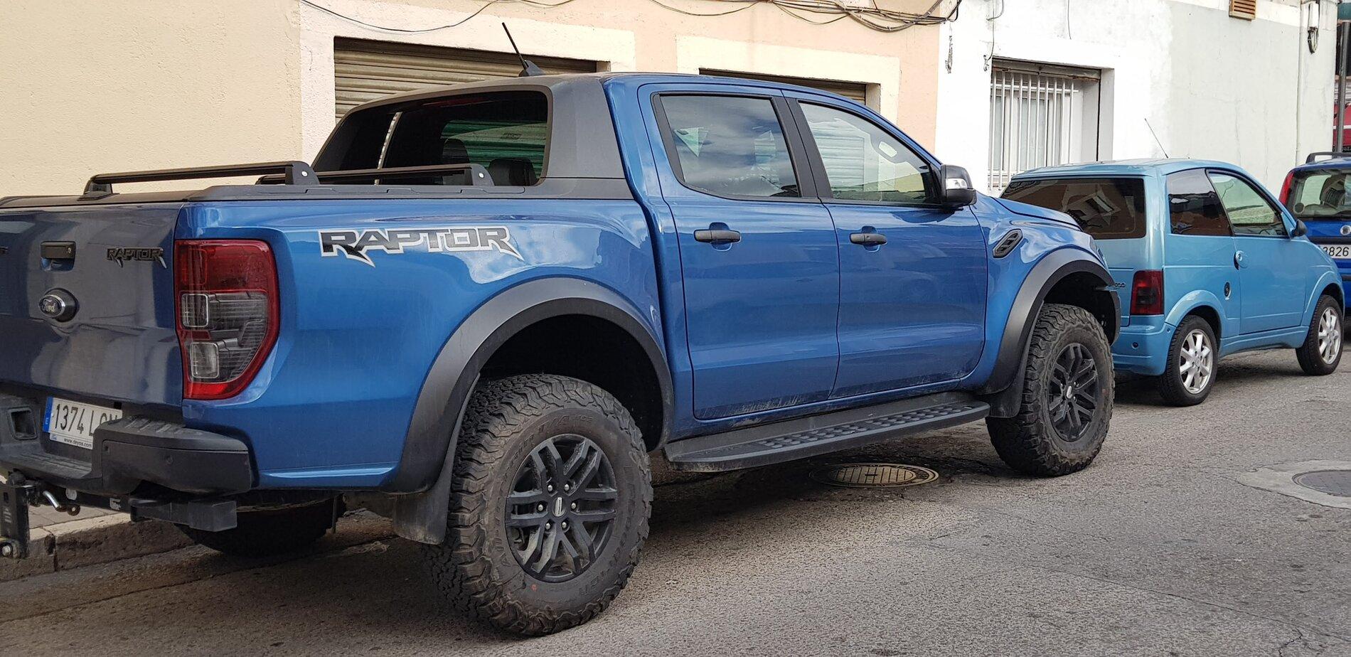

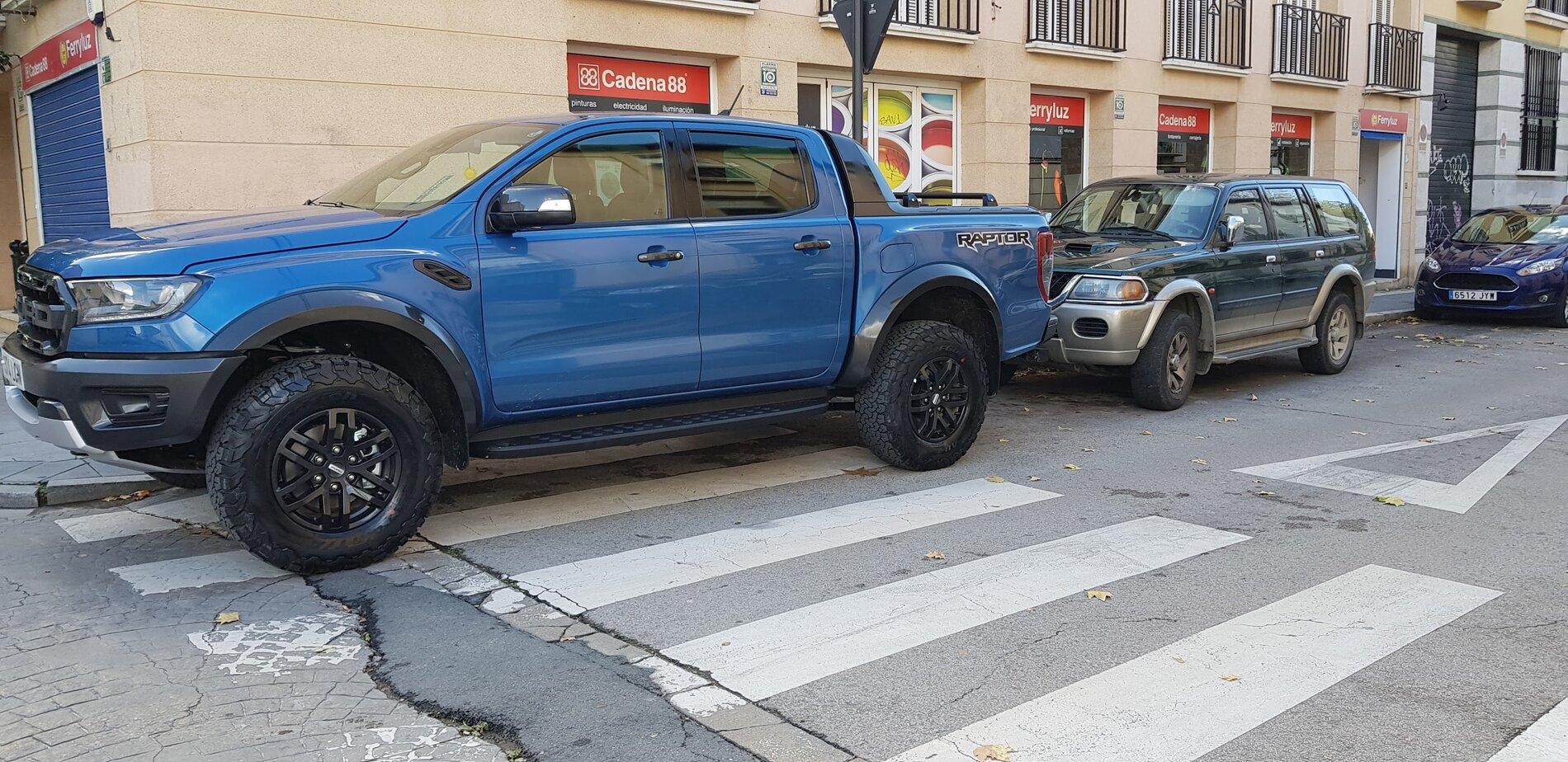

Same issue here in Europe, but then again I con look on top of almost any cars roof. Hey the other day a Porsche followed me and when we stopped at a traffic light, he was suddenly nowhere to find. Nor mirrors, neither by looking over my shoulders. LOL.

I pressed like, but you understand that it is not for the dangerous situation.
