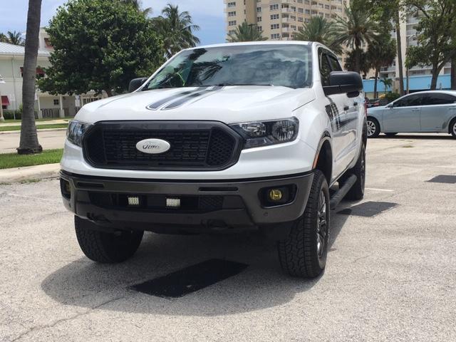

I've got a set of side shooters mounted under bumper. Holes already exist for mounting.
Are those the ones in the middle? If so, do they interfere with the sensors on the Lariat?
Nice. I'll check out that option too.

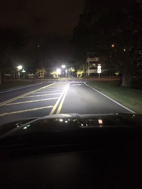

Hi. I find that I am constantly getting flashed that my brights are on when they are not on at all. I have a Lariet, which I believe comes with some fancy lights or something. I'm getting flashed by like 50% of cars that pass me. Even many semi trucks are flashing me. There's got to be something wrong.
It seems maybe they're aimed incorrectly? If so, how can I aim them down a little?
If not, what else can it be?

If you're creative and resourceful enough you can mount them anywhere. I was going to suggest either below the grille or inside the lower bumper as already mentioned. I have a pair of lights mounted to the lower slot of the XLT grille. No drilling required for that, and they're on the same level as the other low/high beams so they do essentially act like an extra set of headlights. If I didn't do that, I would've mounted a set in the lower grille opening as others have noted, which would essentially act as extra set of fog lights.

I have a 2019 Lariat and was getting the flashing light response from oncoming drivers. I had the Ford Performance leveling kit installed by the Ford dealer. The work statement from Ford requires headlamp adjustment. The document from the dealer stated this was accomplished. Yesterday, I checked the headlamp adjustment per the shop manual. Both sides were significantly higher than the target bar which was 41 inches from 25 feet distance based on the height of the center point of the light lens. Easy adjustment using an 8mm socket and ratchet. I was going to take the truck back to the dealer at first and have them check and confirm adjustment. But frankly, I don't trust them doing it correct.
FYI, I also checked the adjustment of the fog lamps per the shop manual. Both were about 4 inches below the target bar.....and this after the leveling kit install. And this from the factory ! I have to wonder if they actually alignment the fog lamps in production but just some rough setting and hope its right or wait for the Customer to complain. Its an easy adjustment once you find the adjustment wheel. I turned the wheels full hard in one direction and then felt around the light connector for the adjustment wheel.

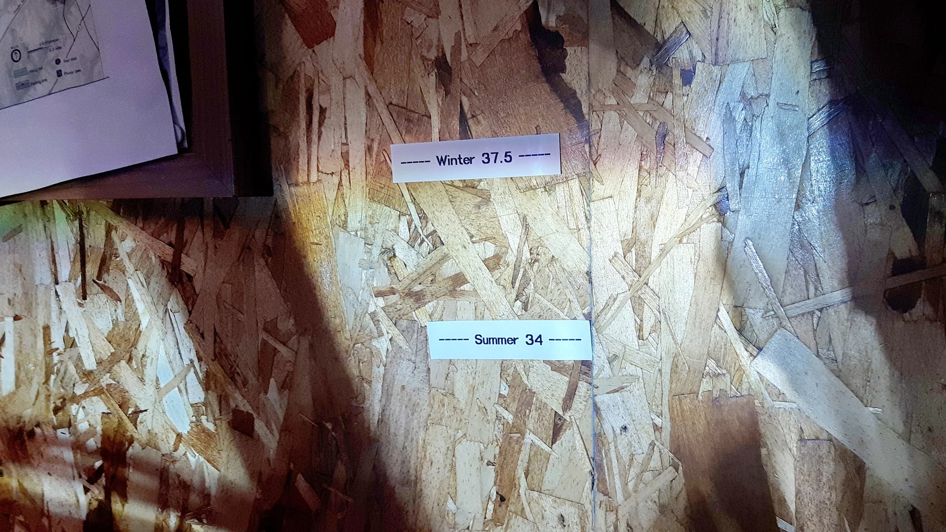

Each spring at the beginning of camping season and fall at the end, I re-adjust the aim of my headlights to accommodate the squat from the camper, or lack of. On the back wall of my garage, I've placed a set of stickers to aim at. Takes about 3 minutes to do the chore.
