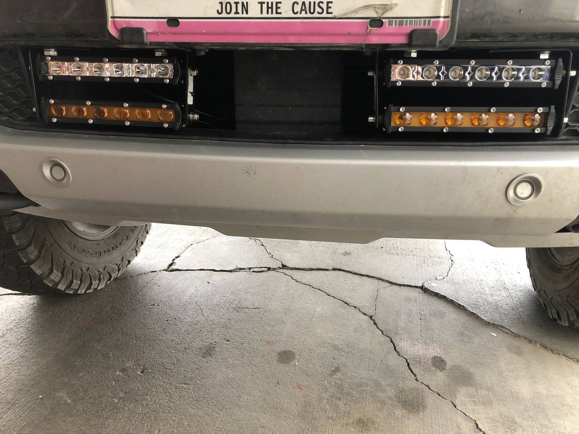

Next safety upgrades: more lights!
Cheap Amazon 7” spot light bars (white and amber) mounted with four 3” L brackets using existing mounting points. Have not wired them up yet but will eventually be tied to my Lightforce Switch Facia. Test fit for compliance with the ACC sensor. No issues.
