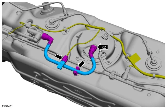

The (Quick Release) coupling is just a locking collar that you pull up or squeeze

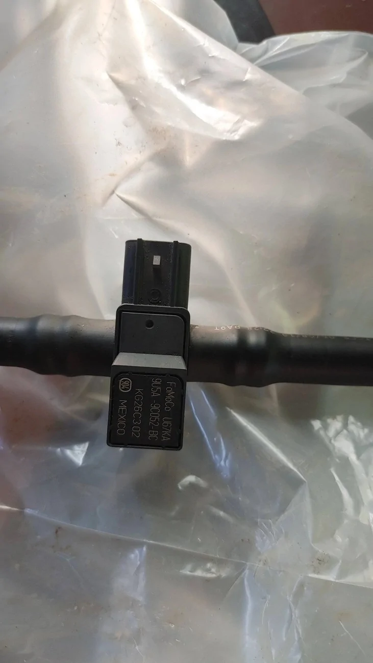

Another note - If I recall - the FTP sensor comes as an assembly (Tube Assembly)

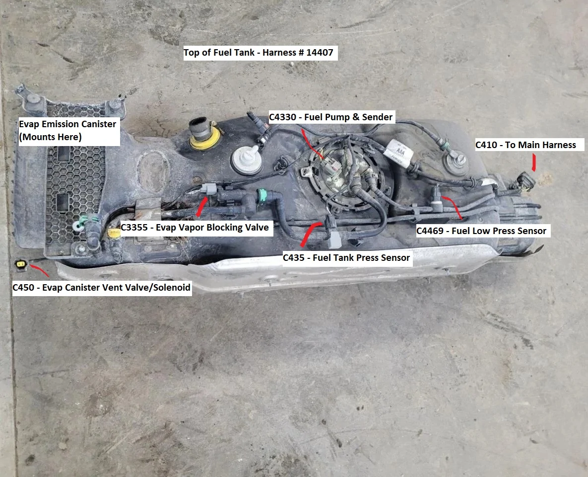

Tank Ref:
Fuel Tank Press Sensor - Detailed
Note: The small hole on the housing - This is the Atmosphere Press (Ref) Port - check for blockage
Have you had (Undercoating) applied or been off roading (Mud)? this may be blocked
