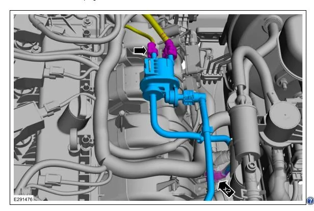

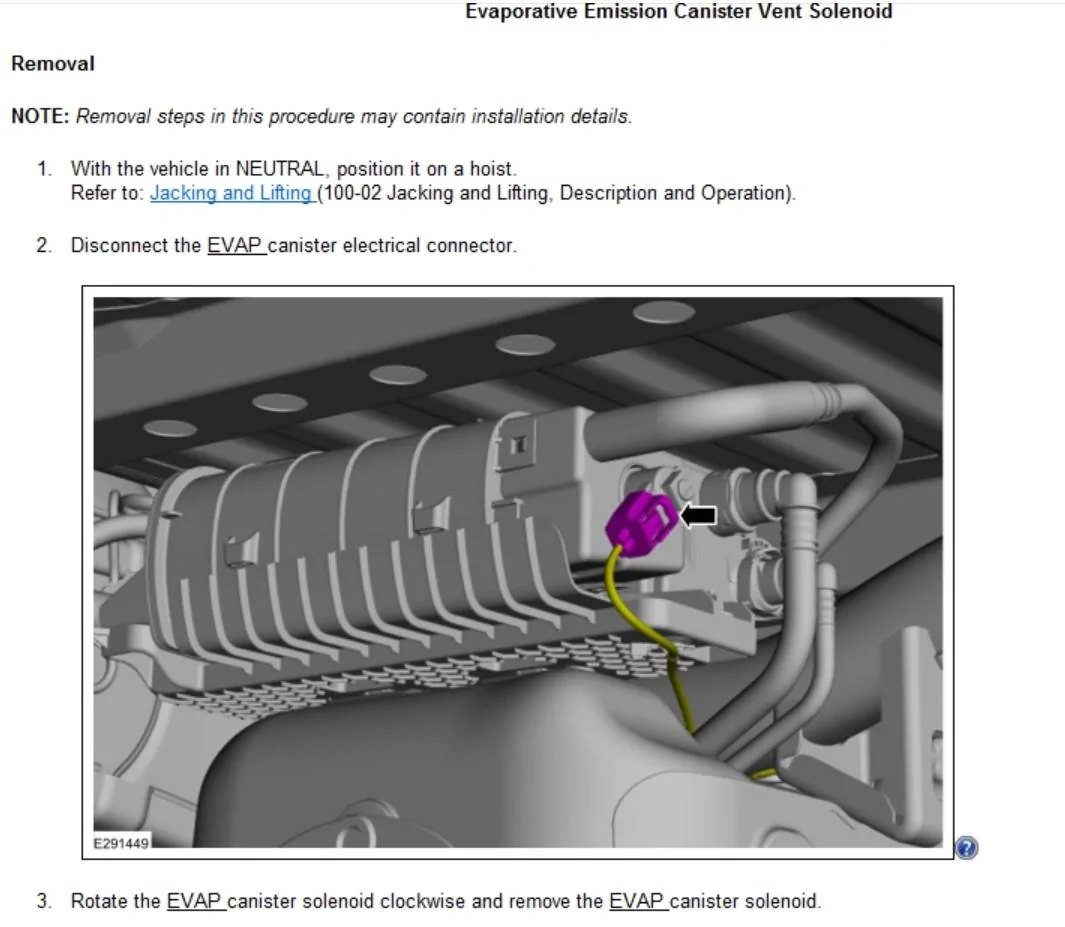

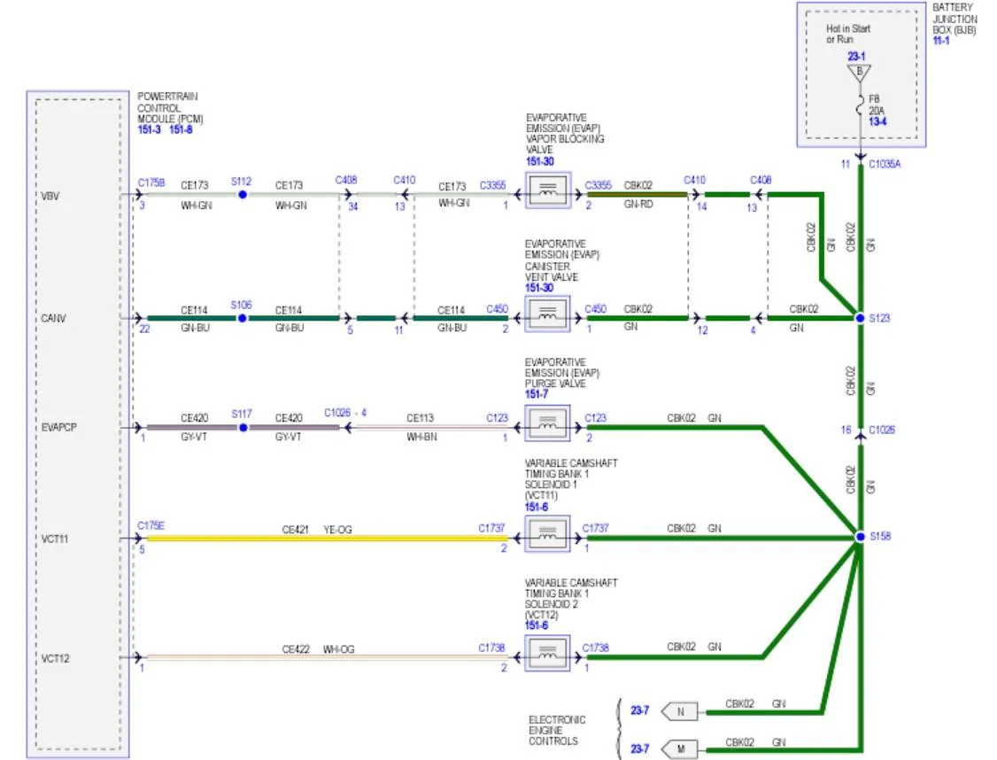

I believe that code is not referring to the purge valve. It refers to the canister vent valve. It is the second from the top in the electrical diagram.

  • VPWR circuit open
  • KAPWR circuit open
  • CANV circuit open
  • CANV circuit short to ground
  • CANV circuit short to voltage
  • CANV circuit short to KAPWR
  • Damaged EVAP canister vent valve

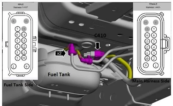

It needs a wiring check, or you can possibly (Pull and Inspect for Corrosion) on the following connectors.
To properly check its easier with a High-End Scan Tool with Bi-Directional Control
But can be done (Old School) with a Meter.
Note: C408 is a known problem connector for (Moisture & Water) intrusion and the contacts get corroded.
Ref: The Following Connector Pinouts for wire checks:
Let's Check for Voltage:
NOTE: Power Checks are with Key On Engine Off (KOEO)
Ensure Key is OFF - when you disconnect any connector and then turn the key back on to perform the checks
Canister Vent Connector disconnected
Meter: (Voltage)
Note: Pinout for C450 (Canister Vent Valve)
Pin #1 - VPWR - Green
Pin #2 - PCM Control (Ground) - (CANV)= Green / Blue
Note: Pin # To Ground = Red Meter Lead to Connector Pin and Negative Meter Lead to Body Ground (Frame) a good clean ground
Disconnect C450 (Evap Vent Valve Connector)
Pin #1 to Ground = Battery Voltage
(Yes) stop here, and we need to check the PCM output control of the valve (Pin #2)
(No) Proceed to next step
Disconnect C410 and Measure (Upstream) Side - Inspect for corrosion or pushed pins
Pin # 12 to Ground = Battery Voltage
(Yes) - Wire issue between C410 & C450
(No) - Proceed to next step
Disconnect C408 and Measure (Upstream Side) - Inspect for corrosion or pushed pins
Pin # 4 to Ground = Battery Voltage
(Yes) - Wire issue between C408 & C410
(No) - Wire issue Upstream of C408, need to dive deeper and check Splice (S123)
For the PCM Output Control (Ground) (CANV)
Have all 3 connectors disconnected
and Measure (Ohms Scale)
C450 Pin #2 to C410 (Fuel Tank Side) Pin #11 = 3 Ohms or Less
C410 (Harness Side) to C408 (Downstream) Side Pin # 5 = 3 Ohms or Less
If both voltage and Ohm checks are good, then we need to dive deeper for Voltage (S123) or Ohm checks (Disconnect the PCM Connector) and meter between:
C175B Pin #22 to C408 (Upstream Side) Pin # 5 = 3 Ohms or less
Splice (S123) is located in the driver's footwell just after the harness comes into the cab (Firewall) is the general location, will have to open harness to locate it.
