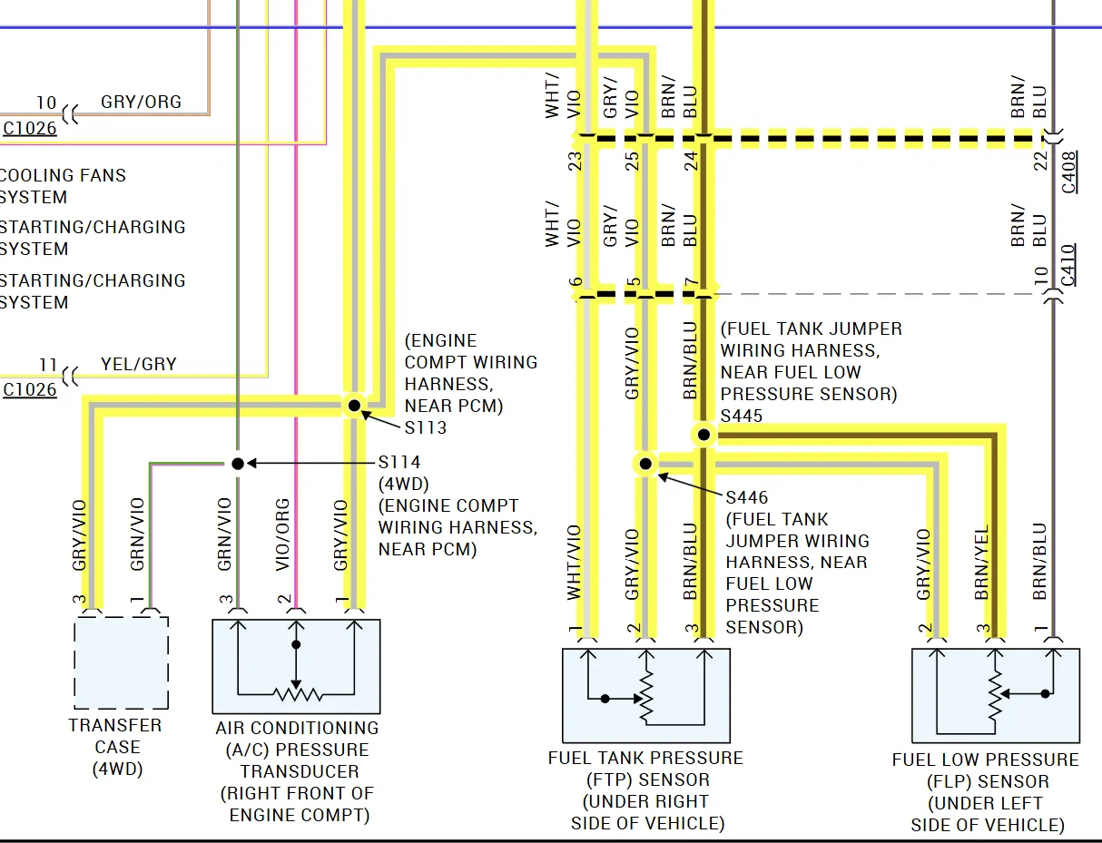

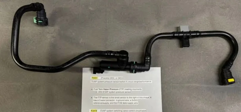

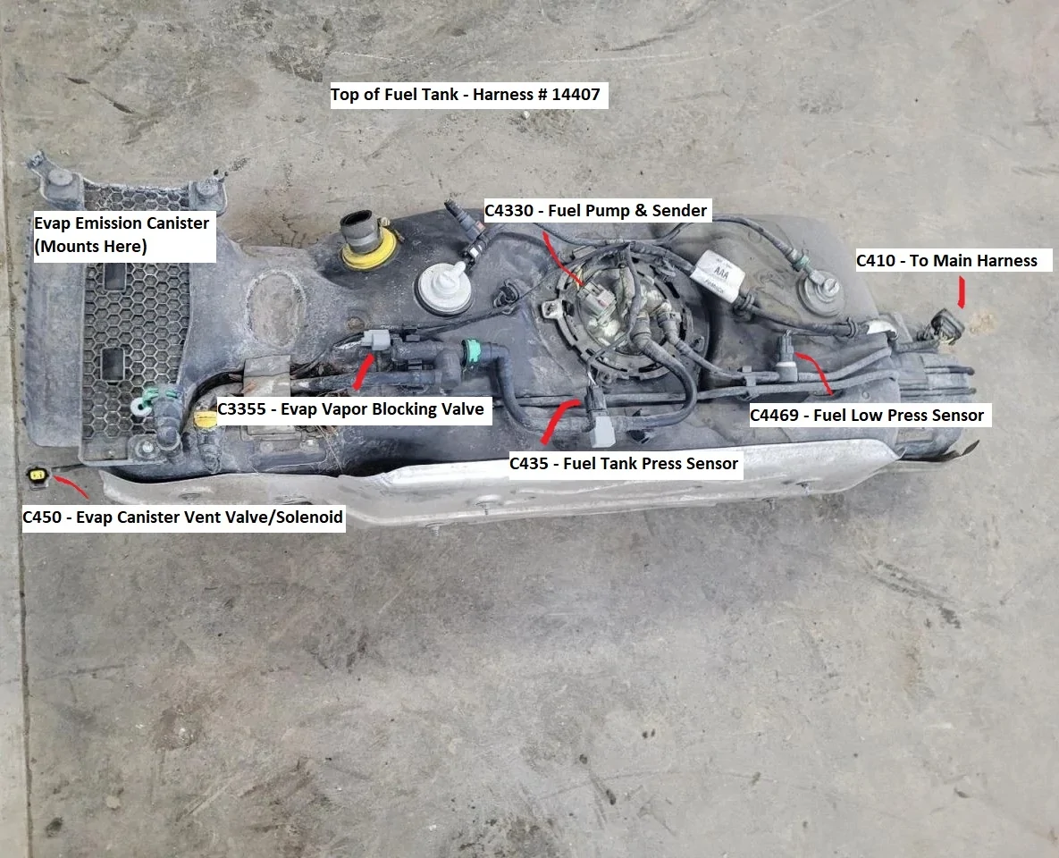

If it stays consistent - reset code and it returns - (after resting) - next day (start-up)

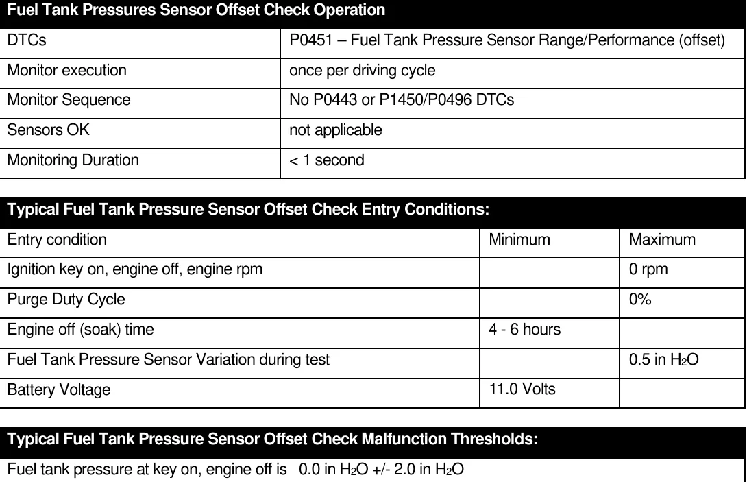

Then for me - its failing the (Rationality Check)
Sometimes - the entry conditions can be confusing (chart above)
I read this as (The test will run - Once Per Driving Cycle) only (IF) the entry conditions are met and if they are not met (the test aborts)
Note: They do not list a voltage (in this chart) so the actual pressure reading is the most important
So - at first start - Key On Engine Off
Measure: FTP (Pressure & Voltage) - Note Readings
Install The Funnel - and Note Readings
If stuck at 2.08 Volts - the sensor thinks there is a vacuum on the tank and it expects to see (0-H20) or close to 2.65 volts
