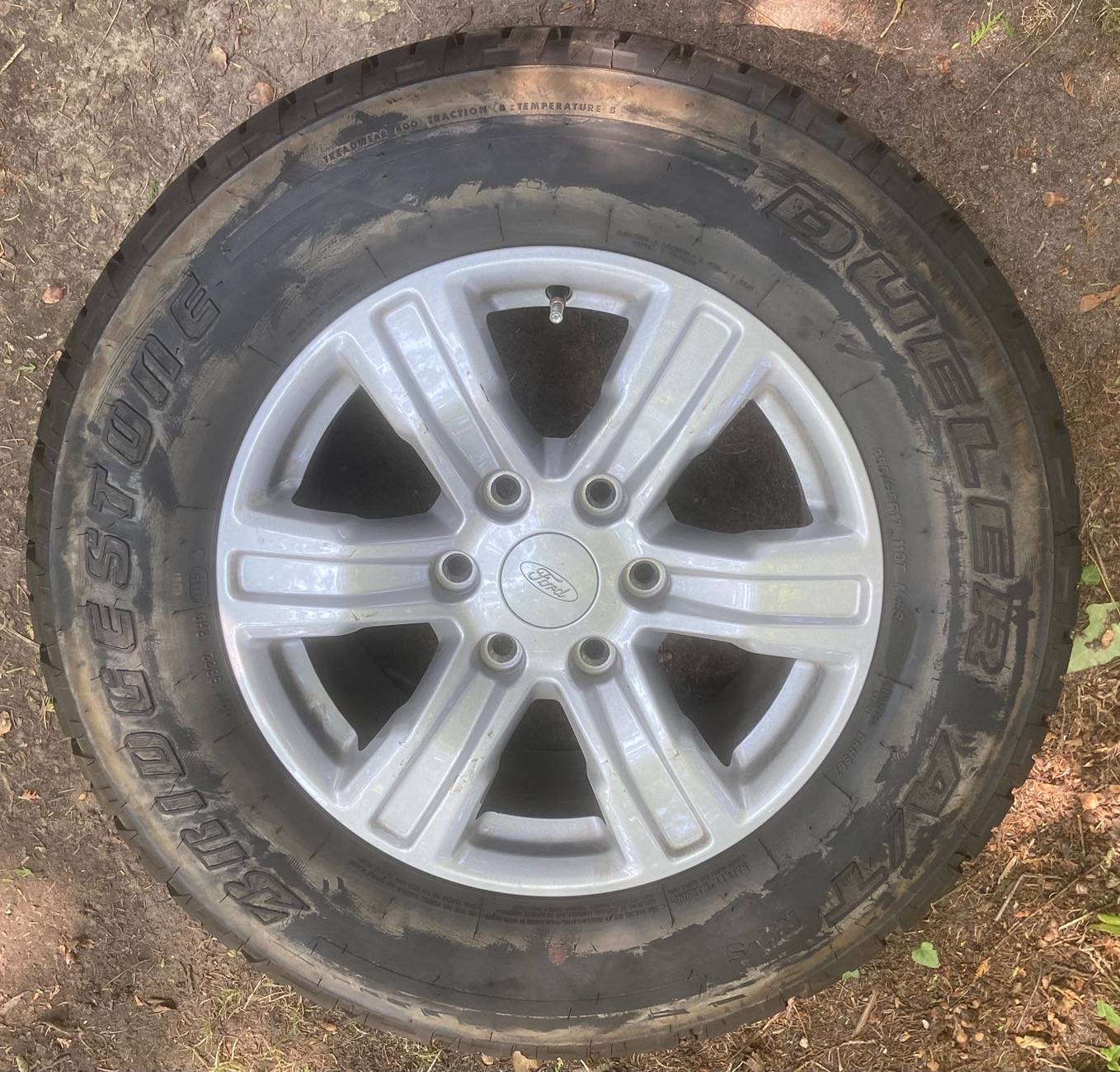

I recently swapped my factory wheels back onto my Ranger and after they sat in my garage for the past four years, there was a ton of “browning” on the sidewalls. More than I’ve ever seen on my truck’s tires. If you don’t regularly clean your tires when you wash your truck, you probably have a bit of this and wondered what causes it, how do I get it off my tires, and how can I keep it from coming back?
What causes it?
The common thought is that it’s caused by tire dressings but it’s called antiozonant and it’s added to your tires‘ compound.
“Tires bloom because antiozonant pushes its way to the outer edge of the rubber casing with time. As the element comes into contact with oxygen, it leaves a brown residue on the surface of the tire. Antiozonant is organic and helps tires last longer as it slows deterioration due to oxidation. This is what makes it possible to manufacture long-lasting high-mileage tires.“​

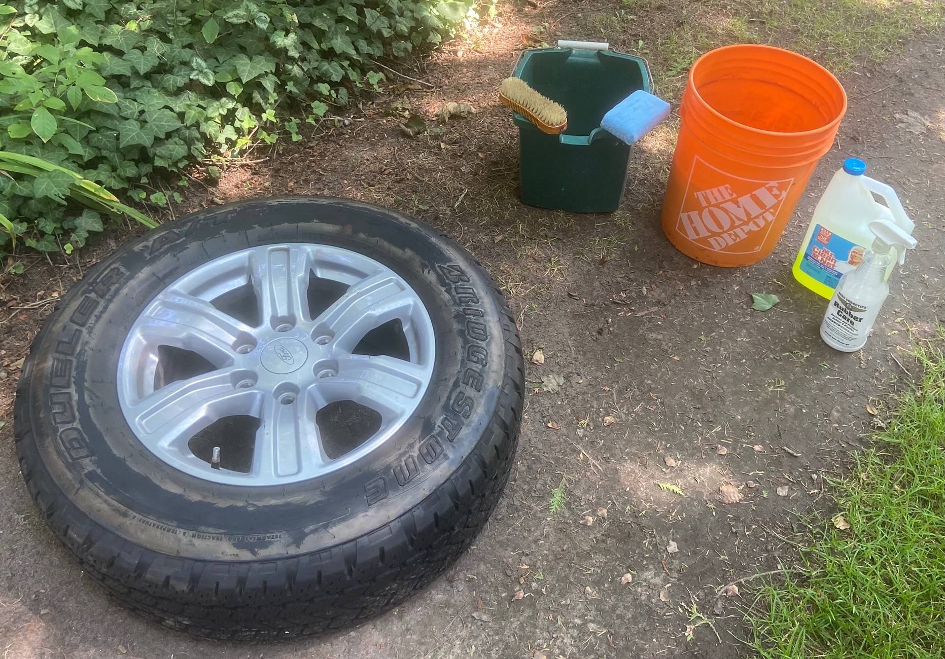

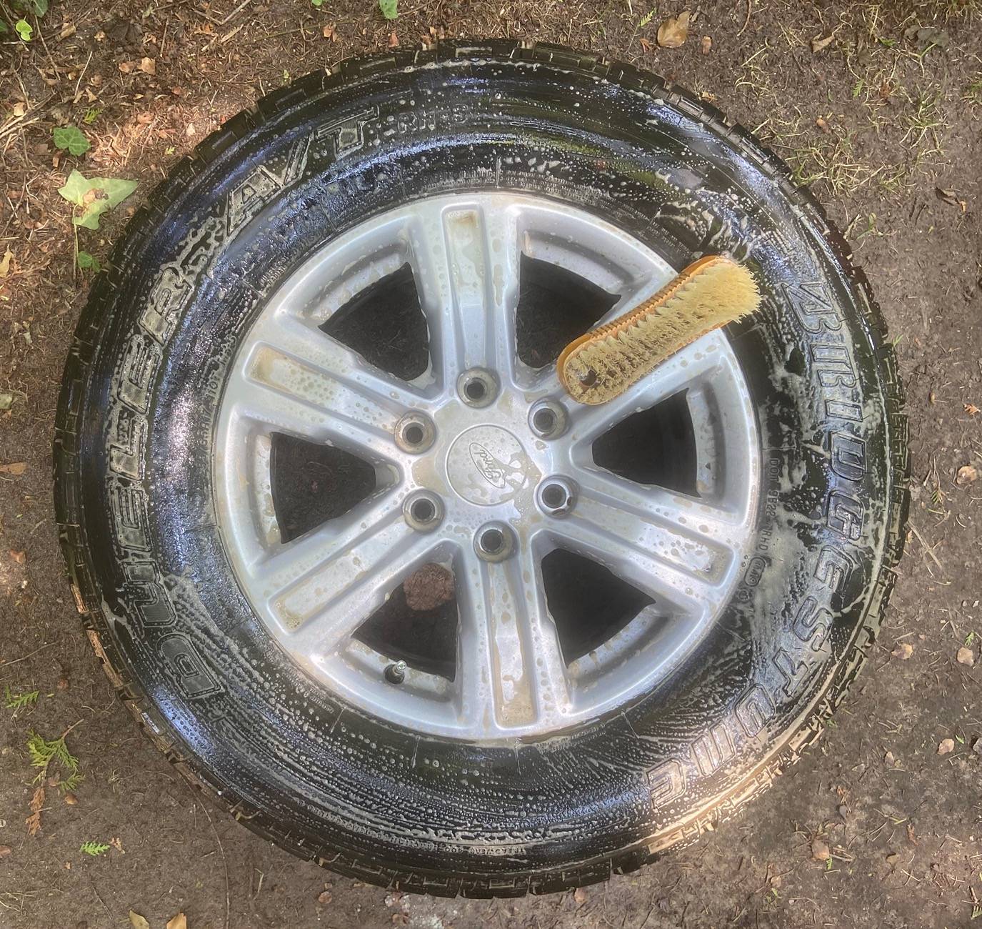

The answer is simple, you clean your tires with a good strong cleaner - you don’t need a fancy wheel and tire cleaner. All you need is a household product like Mr. Clean, Simple Green, or any of your go-to household cleaners. I used a 1:1 solution of Mr. Clean and water and a basic scrub brush. Don’t be shy with the solution and don’t try to save time. Get after it and scrub away and when you’re done, do it again.

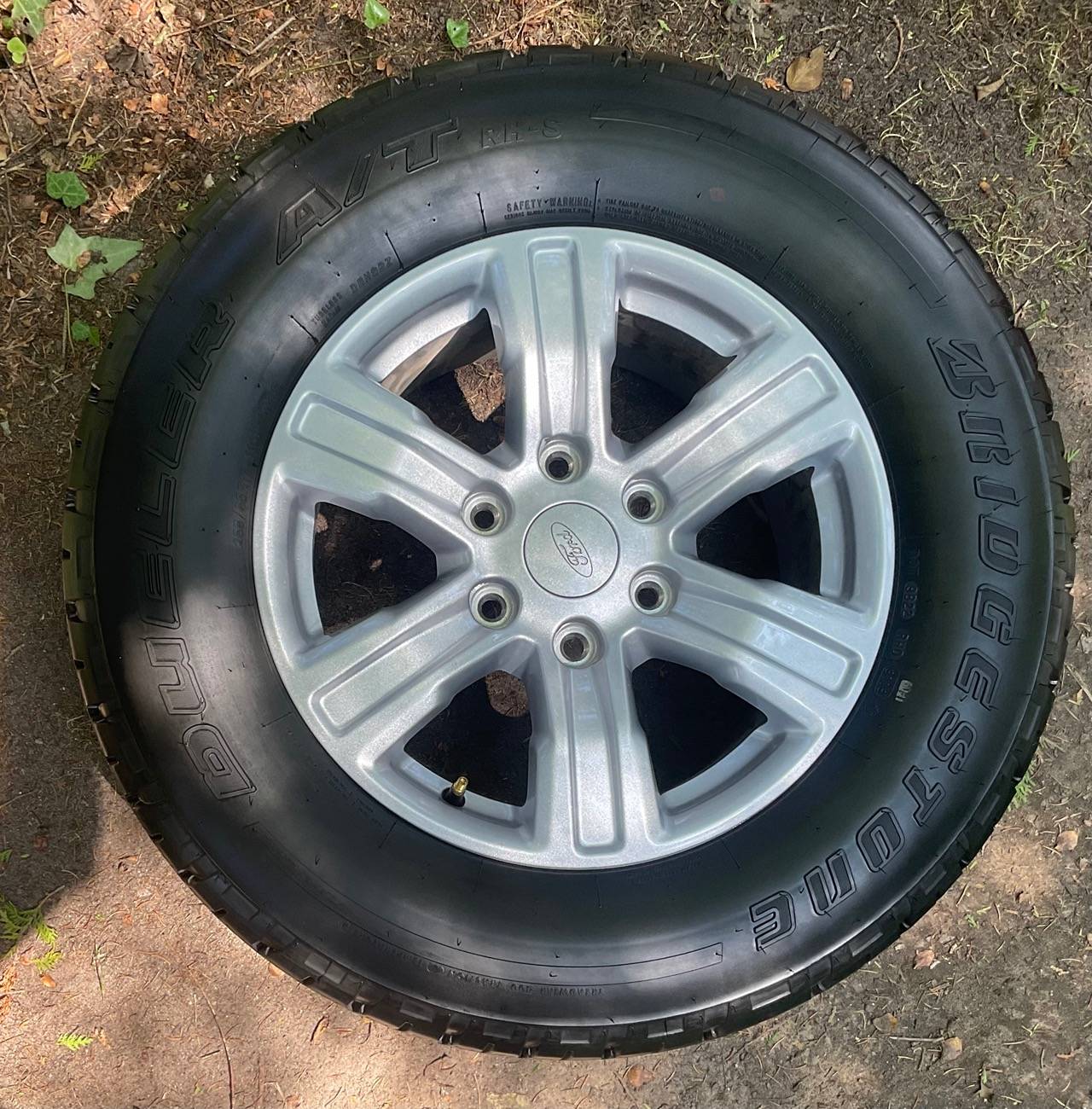

Rinse with clean water and dry everything with a microfibre towel. It’s going to look pretty good but you’re not done yet. Check it out - not bad so far, right?

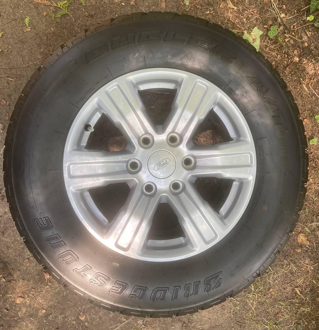

You’ve done the heavy lifting so keeping it under control is super easy. All you need to do is make sure you clean your tires every time you wash your truck and treat them with a good quality tire dressing or rubber conditioner.
Now, don’t just clean them with some spray-on, rinse-off tire cleaner. Scrub them with cleaner and a scrub brush or wheel brush. If you use the coin-op car wash, Spray the pants off them and take that foam brush to them. If you’re using the drive-thru type, you’ll need to clean them on their own.

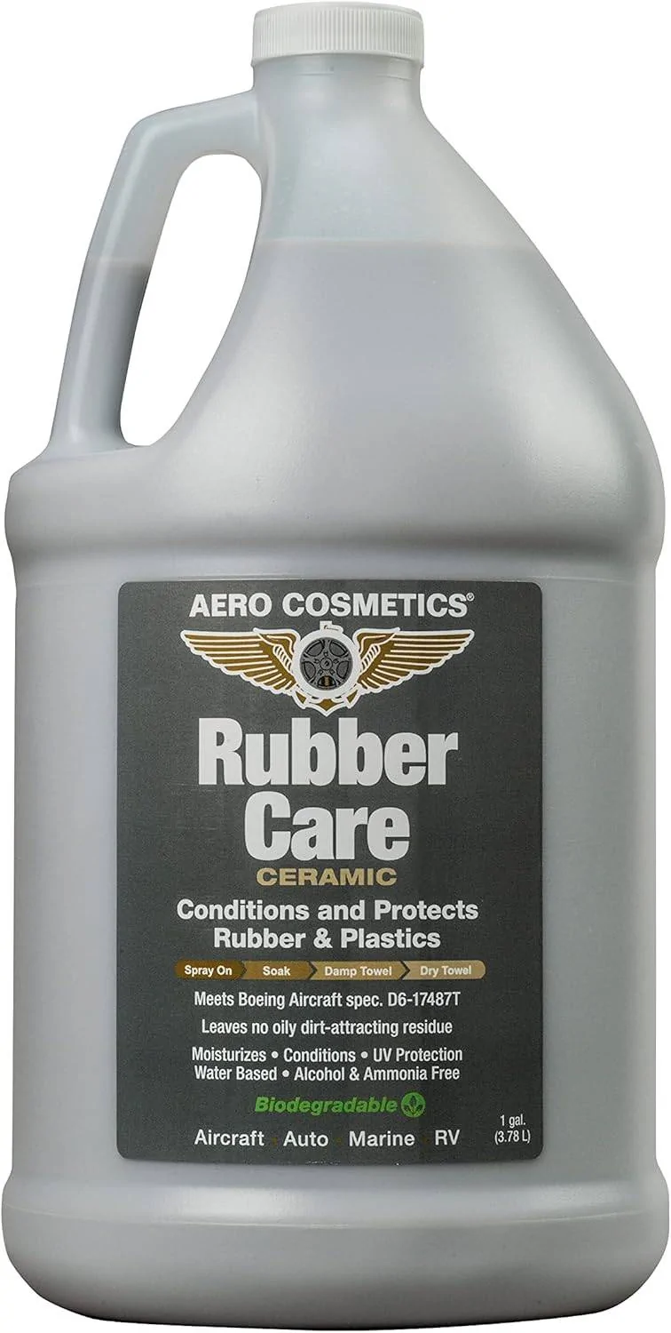

Most good tire dressings can make your tires look good and protect them from oxidation. I use Aero Cosmetics Rubber Care because it’s the best product I’ve found - it was designed for use on aircraft tires, if that means anything. Spray on a liberal amount and work it in with a detailing sponge. When you think you’re done, spray a small amount on the sponge and rub it in again - it’s a conditioner and helps prevent the oxidation that causes the browning.
If you want shiny sidewalls, Aero Cosmetics Rubber Care isn’t for you and I’m sure there’s a product out there for you. If you want a matte black, like new finish, I recommend Aero Cosmetics. It also protects plastic, so run that sponge over your rear bumper caps while you’re at it.

PS... Them tires look pretty good cleaned up! Nice work.

What I use...
Ooooh, Ceramic - fancy like.
I'm definitely trying that as soon as my supply of the regular formula runs out. I may or may not have started a small hoard after you recommended this product a few years back.
Only the regular stuff was available here then but now I can get both.

I bought the gallon and keep it in a spray bottle...
