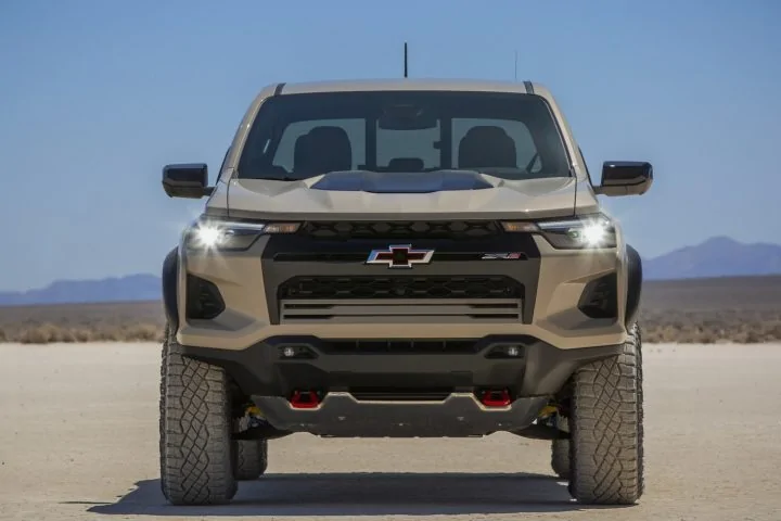

I'm about to ask a nuclear war question. You thought inquiries about wheel spacers was a bunch of purse fighting? Well now lets move on to a actual official slap fighting competition level question; bolt pattern adapters. If I get them am I going to die?
The ZR2 is 6x120 and the only wheel choices out there are the mainstream Method / KMC choices, or a bunch of random brotruck designs.
I still love RTR Tech6 wheels. Looks like Bora makes a 6x120 to 6x138.7 adapter and if I get the 30+ offset version of the wheels this will get me to around 0+ offset all together. Kind of pricey at $300 - but I would be able to return to my beloved RTR design.
If you look at the front end design of the ZR2, no crash bars to contend with and its already lifted 3".

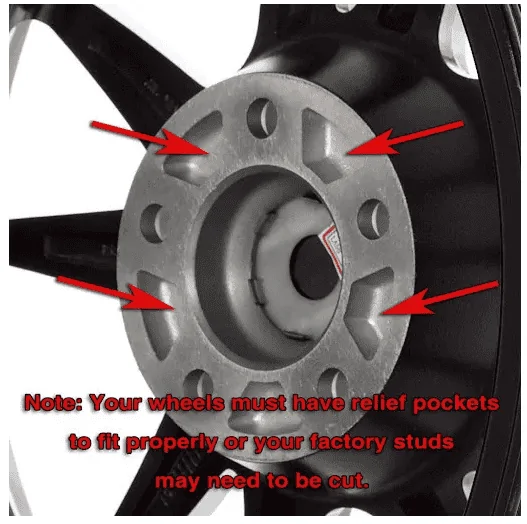

Are the studs on the Colorado long enough?
The factory studs on my Wrangler rear axle were too short for my adapters.
I could've put longer studs in but I replaced the axles with higher strength aftermarket axles that had longer studs.
My adapters are also 1.5" and with the factory studs the nut was a few mm higher than the top of the stud. Not good at all.
Now I have about 1/4" threads of the stud extending past the nut.
I won't know until I try.
Regarding the factory studs sticking out (or the attached nuts) above level with the adapter, if a wheel has recessed pockets, then you are good to go. If not you either don't do it, or take more drastic measures.
80
6,842
41,767
Living The Dream
With a 1.5" adapter I don't think you'll have to worry about the studs sticking up too far.
