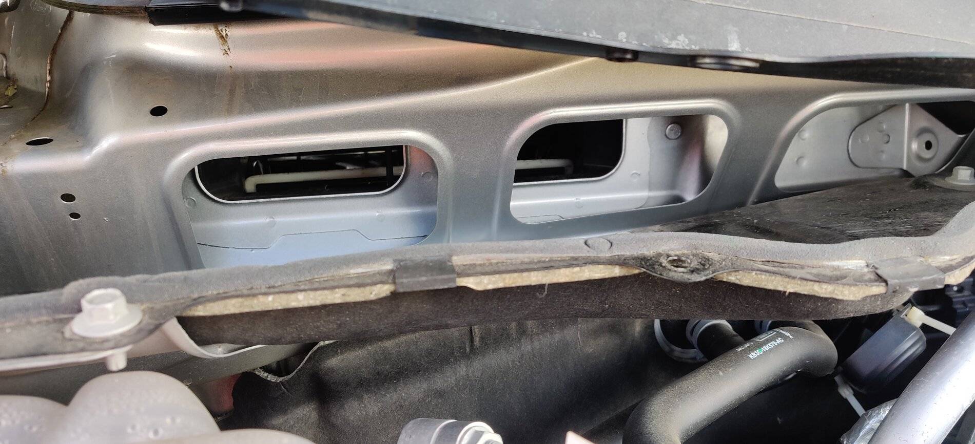

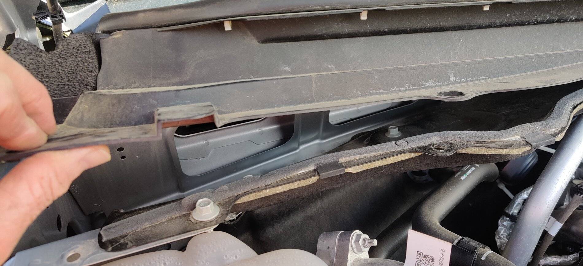

Okay I figured this out. The fresh air intake for the cabin is above the filter slot in the cabin wall metal. 2 big holes, you can't really see if you look up behind the glove box. If you pop the 3 plastic retainers on the cowling and separate the passenger side you can see them easily. Shit, 12 rats could fit through these holes at once!

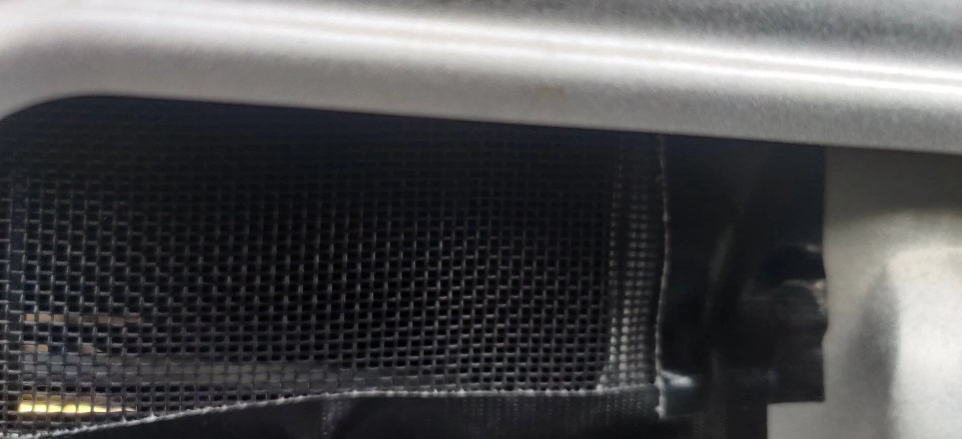

It's a pita getting in there and I'm probably going to have to revisit the situation but I was able to gorilla tape some heavy coated metal screen to the outside of the holes.
I'll definitely be checking on this spot to make sure debris doesn't collect but it should be easy to stick air wand up in there and blow anything out.
I'll keep everyone updated.

sorry that makes sense now. isn't that air usually coming from the area below the windshield?
Yes. The chicken wire in question will keep mice out of the engine, if anything.
I've had a mouse in mine chewing on napkins in the glove box. Lived here 20 years, never had that problem before. No idea how Ford managed to make this thing a mouse house.
