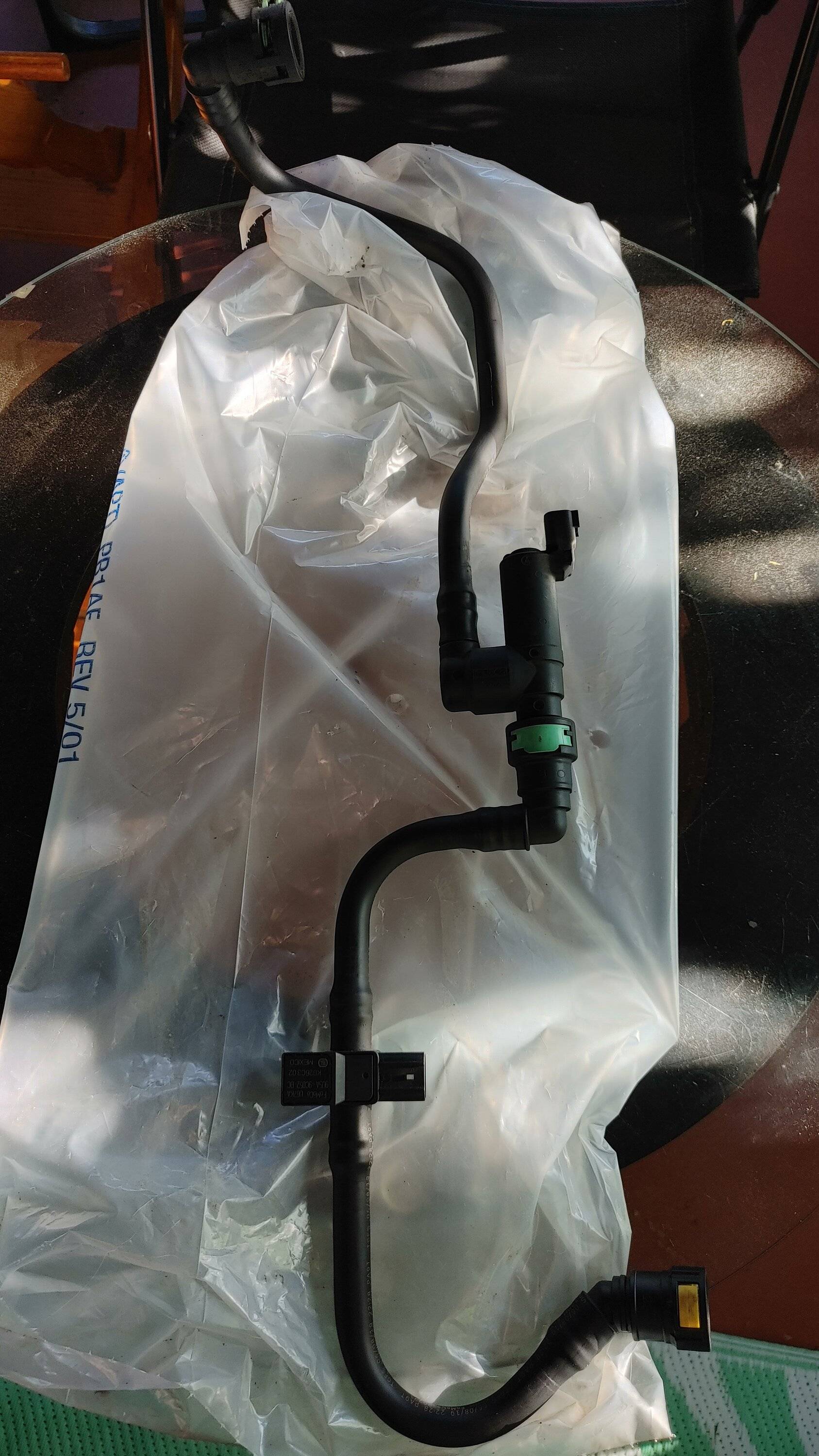

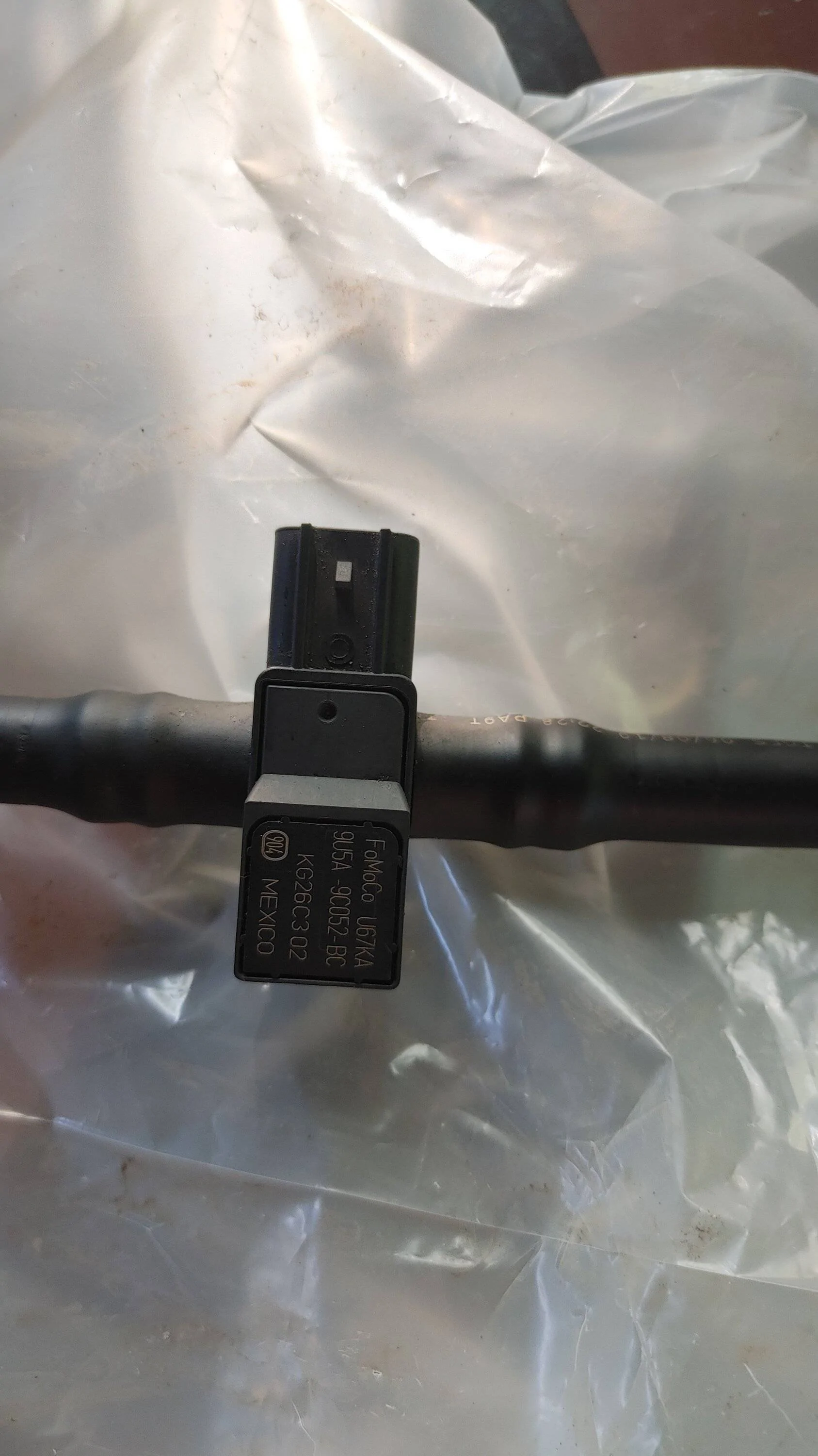

Sorry about the LONG delay, I got distracted at work thats day and didn't think about it again until I went back into the garage to work on something else and seen this on the able. Pretty sure this is the part (the small sensor), last time I had it replace, the said "they replaced everything including the lines." When you run the part number it says its from a Crown Vic, but that it is a fuel sensor. I just assume its the same part.

Can you give me a little more detail about the shroud? I have been thinking about 3d printing something to put around mine to try and solve the issues...

Hi. The shrould is just a piece of regtangle plastic like an open box that fits over the side of the sensor without wires.
The previious picture shows the sensor up close. underneath the writing is the intake for the sensor where the oil enters and contaminates the sensor.
I disconected the pressore sensor and replaced only it. The other part apperently never fails.
I'm not sure whty they send the line with both parts.
wish I had taken a picture of the new shroud before I installed the sensor.
