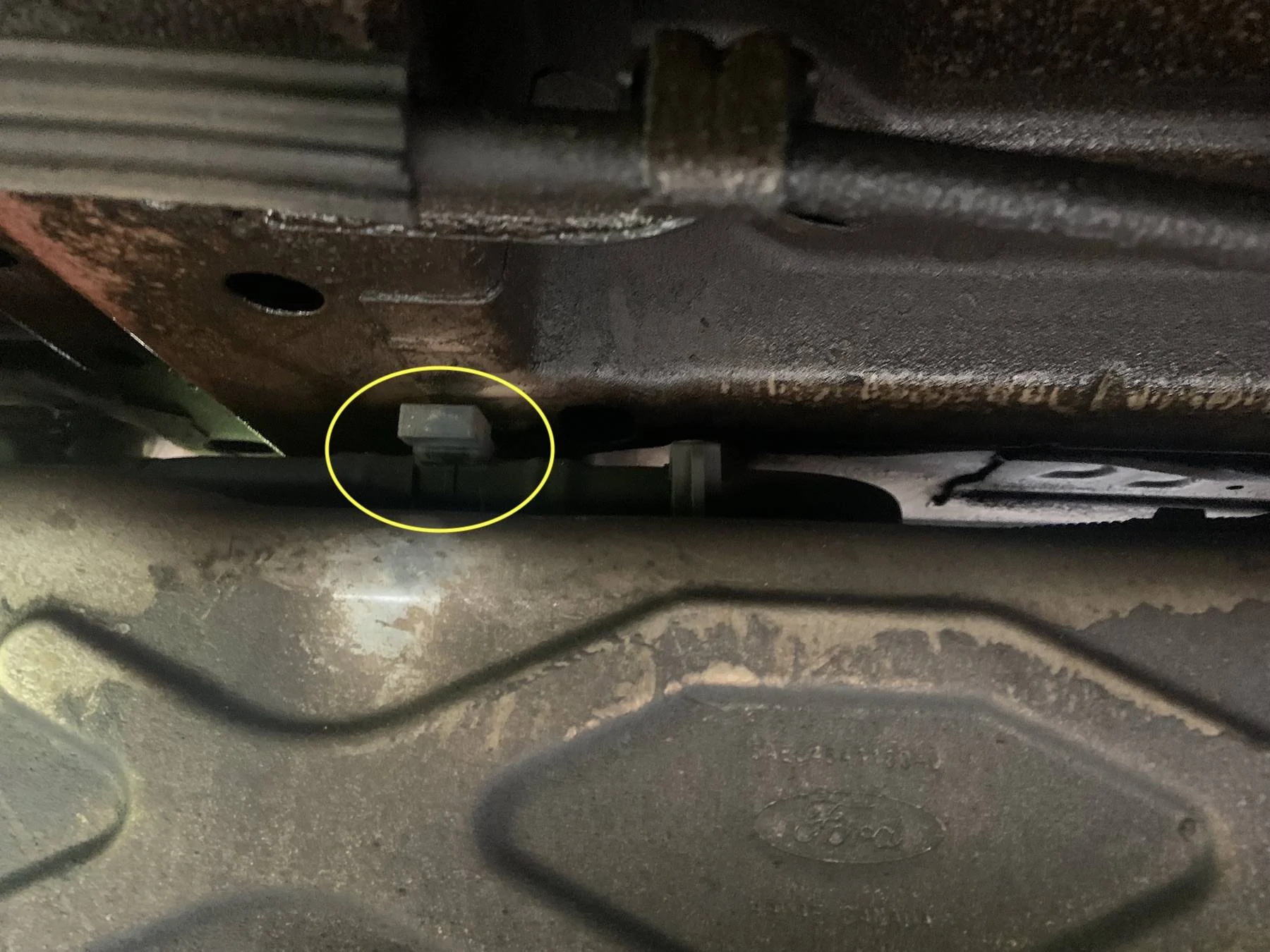

Here is a photo of the troublesome FTP sensor peeking out from the top of the fuel tank. Photo of the left side of the tank looking toward the back of the truck. I gather that techs first hose that sensor with water if the voltage is low. That can clear the sensor, restore normal voltage and clear the trouble code. But I also gather that eventually the undercoating can damage the sensor requiring replacement later. It is very exposed right there.
