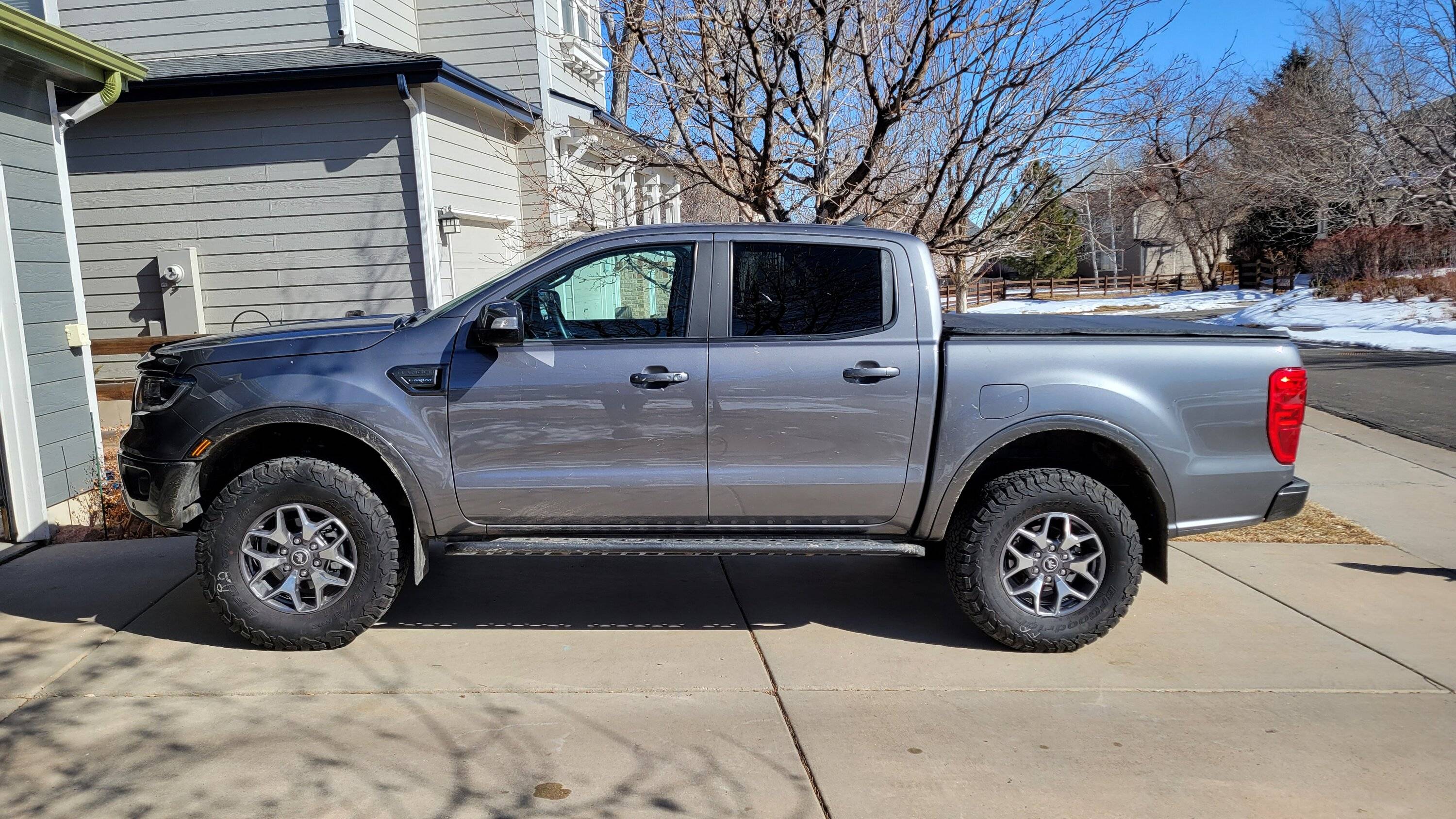

As long as the wheels are the same offset as the factory you should be fine. When I ran my 33s on my Ranger with the old man emu lift all I had to do was remove the plastic cover off the front crash bars and a loosen and push them forward. After that it was fine. I say go for it
9,729
46,552
You might have to max out your FOX coilovers or remove/replace/adjust crash bars bars, but it’s not like it’s major surgery to get it done.
I had 32.2” on +15mm offset and didn’t rub with 2.5” level - angled bars like @Frenchy above and was fine. I think there’s room to play.

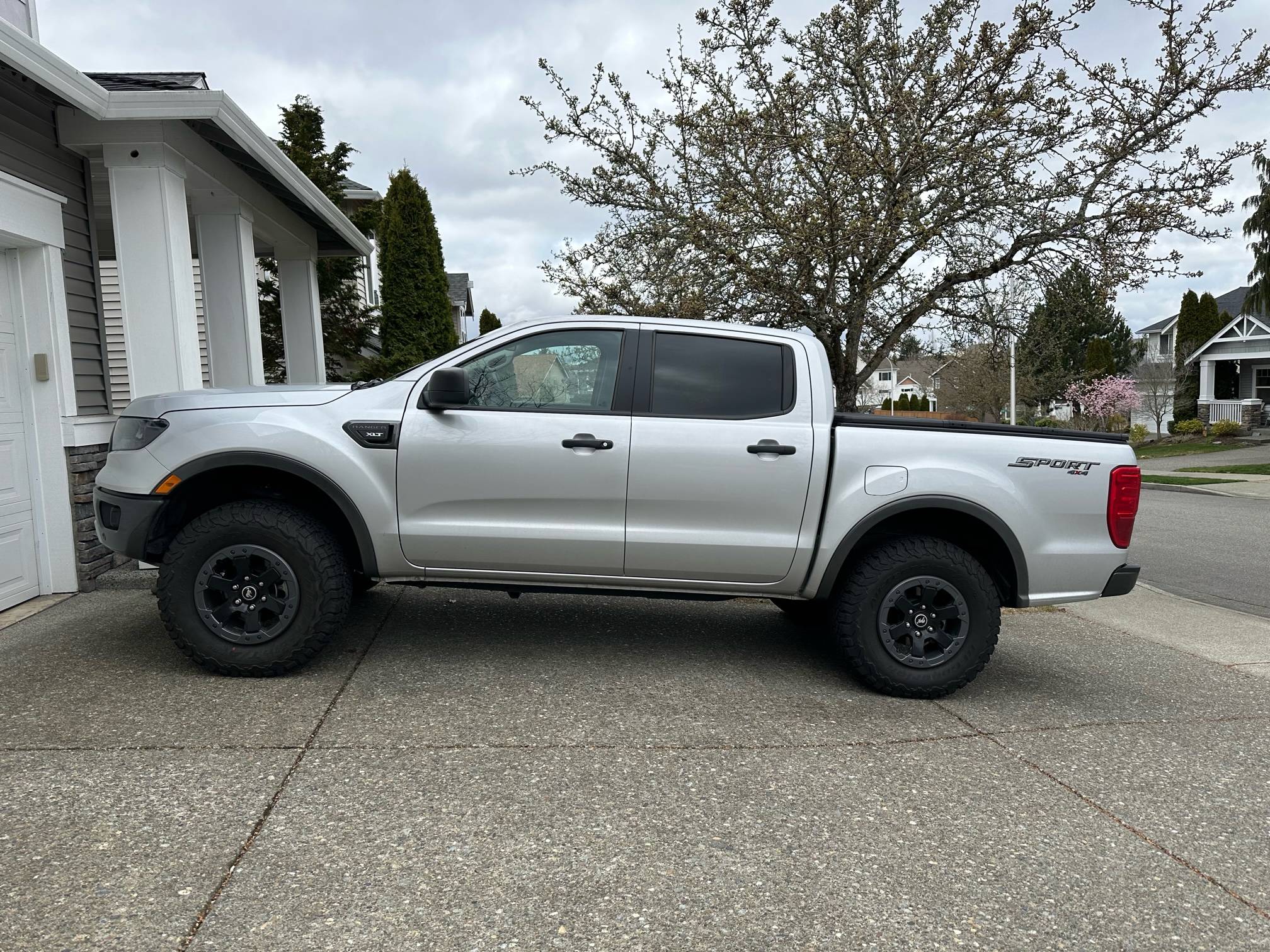

I have a set of Badlands 33's on mine, also with the Fox 2.0 kit. They mostly fit. Little rubbing on the inner fender/framerail. Looks like they should have come with these from the factory.
