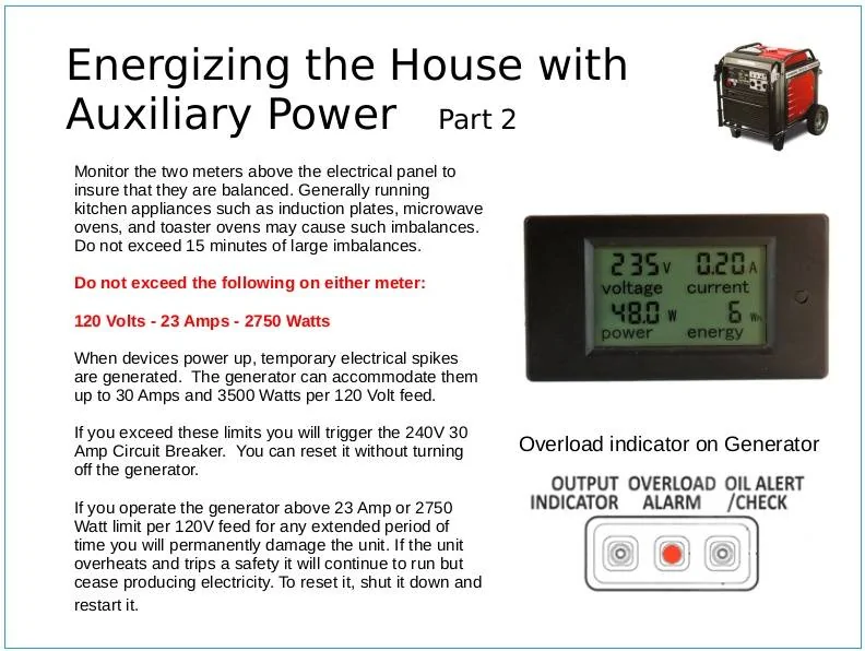

Quite possible. I'm not tearing mine apart to find out.
Although, there wouldn't ever be heavy current going through there, or shouldn't be, at least not on a constant basis.
Good point though. My 500 amp shunt in my trailer certainly isn't small.
That is a lot of heat that would need to be dissipated if it was inline (series) instead of a Hall effect sensor.
I use Hall Effect Sensors (with voltmeter feeds) on my Home Main Electrical Panel when I'm running my back up generator to balance the load of the 220v Feed. This helps me keep my load on my inverter generator balanced and healthy. The wires are minuscule and the info supplied is great. The displays are located just above my breaker box allowing me to simply turn on/off circuits until I see a balance or I'm below the max wattage threshold. Keeps me from running outdoors then back to the panel box multiple times. Here is an excerpt page explaining how to use the two meters from the manual that I created for my wife.
I suspect the BMS sensor in our Rangers is collecting the same data plus temperature.
