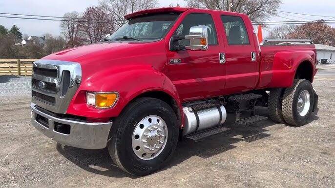

How's life in a big truck? I bet the added cabin width is really nice. I'm a bit portly but the inside of the cab feels about as wide as my 2005 Scion was! =D
how John looks when he pulls up to Soupie! =)
