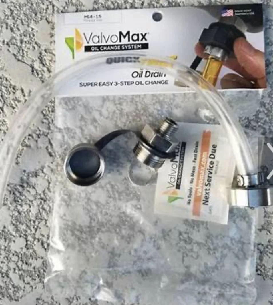

@moorejl57 - I guess my memory is faulty, imagine that, because it looks like the official ValvoMax packaging is also a blister pack, but different. I went looking on google just to see if by chance I could find a photo of the unit I was sent and I did! On ebay!
FAKE UNIT:

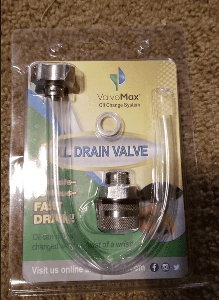

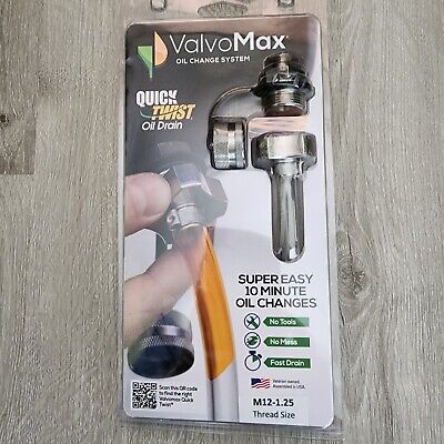

REAL UNIT:
I’m not doubting you got a counterfeit one and I’d be hesitant to buy from eBay myself. But what I noticed is Valvomax must have changed their packaging over the years. They also have a metal version and plastic version. Here’s a similar picture of the one I purchased directly from them around four years or so ago. Also if you go to Valvomax’s site and scroll almost to the bottom you’ll see a YouTube video Scotty Kilmer made six years ago and his had the similar packaging of the one you say is counterfeit. Moral of the story is just buy direct from the company whenever possible to be sure.

This is how mine was packaged as well. So far it is working great. I keep the tube in a ziplock bag in my Swing Case.

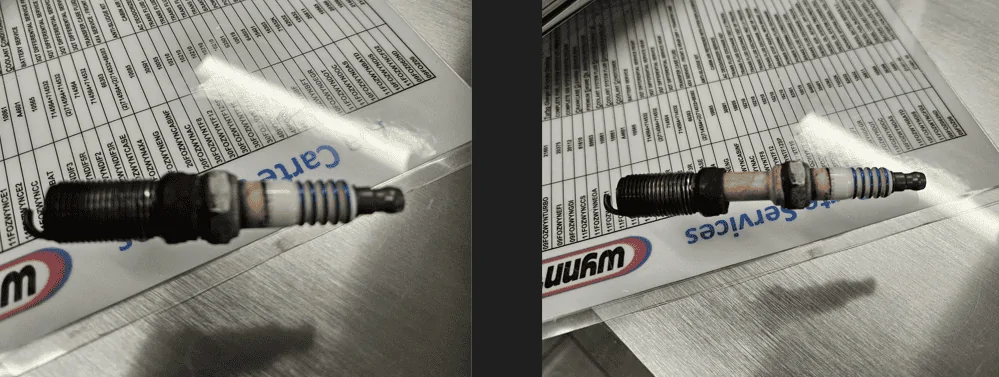

Yes, and the water sitting in the wells, leads to this if you are not careful removing them.
Baby step them out and do not just exert all force trying to remove them or you could possibly experience this.
This is why some have had to replace the head as the techs could not get the plugs out, if you are lucky, you could get them out via (Easy-Out)
Do some prep before you attempt removal, soak with Kroil (My Preference), blow out with blow gun then use Brake Clean and blow out again - Reinstall the COP and get the engine WARM not hot. Then lightly soak the well again with Kroil, just enough to coat the threads as you back it out and turn back in - you need to wet the threads, this helps break up the corrosion on the threads.
Then use the Baby Step method to remove the plug, (1/4 turn CCW - 1/4 Turn CW)- (1/2 Turn CCW - 1/2 Turn CW) - continue this method advancing 1/4 turn each step.

So, you saying our plugs can separate as in the photos?
Thanks, for the info on the process to remove a frozen plug.
I have no problems my plugs (yet).

Yes, the pics are from a member of this forum who had a broken / stuck plug issue, caused by the water in the wells on his Ranger.
So, the corrosion weakens the integrity of the base and what seeps down into the threads only increases the torque required to remove them (dirty threads).
By using the Baby Step method, It MAY help in a successful removal without the need of alternate methods and hopefully the base will hold strong enough to allow removal as the goal is to get them out with the least resistance possible.
On a good clean plug, once you have it loosened you should be able to remove by hand with the extension with some slight resistance when you reach the end of the plug (carbon build-up) exposed in the cylinder
On a plug with dirty threads, the corrosion builds up in the threads as you are removing them, and it will seize up, this is where one would attempt to use more force on the ratchet and with the weakened base - it just snaps off

So it's from water in the spark plug well NOT carbon build up on the plugs. Thanks for the info. If it were carbon I'd probably change then sooner. I'm now know for keeping vehicles for an extensive time. Four to five years is more common for me. I will probably swap them at 50-60K if I get that far on the Bronco
