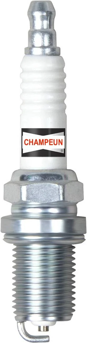

@moorejl57 - I guess my memory is faulty, imagine that, because it looks like the official ValvoMax packaging is also a blister pack, but different. I went looking on google just to see if by chance I could find a photo of the unit I was sent and I did! On ebay!
FAKE UNIT:
REAL UNIT:

Was the problem caused by counterfeit plugs? Because many people had issues with #4 after replacement because that COP is a bitch to get on correctly.
I was going to say the same thing. Misfire on #4 sounds like the COP problem.

Although truly possible in today's age (Counterfeit) products. I feel that due to #4 COP being somewhat difficult to guide down the well and get it properly installed. As it is a (BY FEEL) install, I think it is a high probability that the COP was not installed correctly, on the first stab.
This is not the (FIRST) time we have had an owner with this issue, and it is always #4, and if not being 100% attentive to the small (click/snap) feeling, it is very EASY to get the COP on, only the boot is slid down the side of the plug, this is all due to the fuel line being in the way of the direct straight on approach.
So possible (counterfeit) - YES but in this case and the plug #4, I think it was the install that is the cause of the misfire.
If you make #4 the last one that you install, you have the other 3 as a (feel) guide to use as a reference.
This is by far is no discredit to the OP, but I think that the auto parts store may be jumping to conclusions without actual proof, as they are not at the truck installing them and not noting the somewhat difficult install of the plugs COP (misfire) in question (#4)
The only proof would be to take the plugs in question and install them in #1 & #2, I highly suspect that they are just fine and a legit product as for you to get an immediate misfire on #4 after starting the plug in question would have to have a Visual Defect (Cracked) or way out of (Gap) range.
The shudder was a major misfire due to the fact you were only running on 3 cylinders, with #4 COP not attached to the end of the plug or not fully seated.
