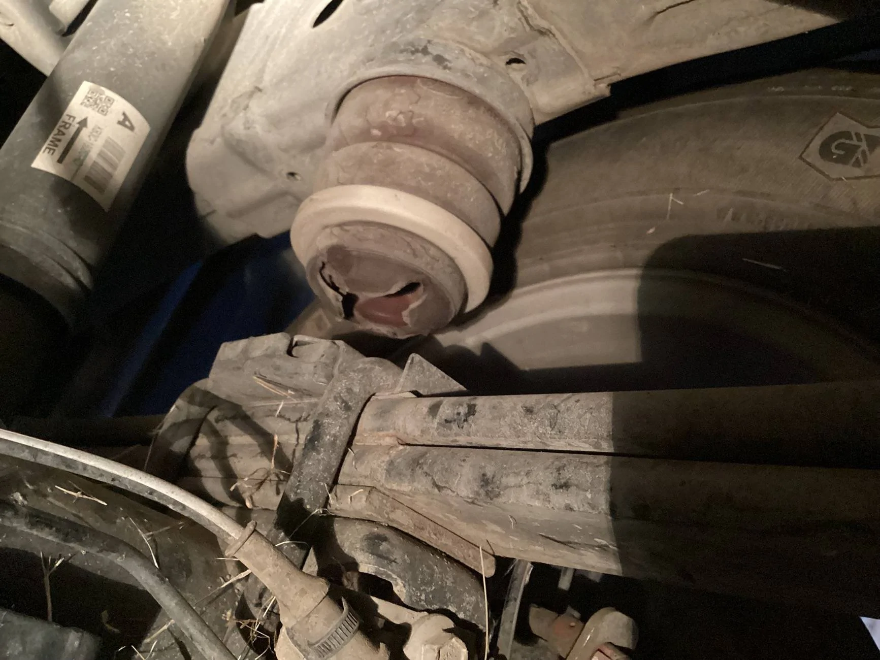

Is this deterioration of bump stop normal wear or an indication of suspension problem ? I tow a 3,800# travel trailer couple times a year and do not go off road. If it needs to be replaced, any suggestions ? Not looking to upgrade, just a rookie on suspension issues.
Just to answer the OPs question and hopefully end this. That is the way they are made. That cross shaped hole is molded in.

Regarding bumpstops in general...for those of us that don't tow and rarely haul anything heavy, do bumpstops wear out? Is there a reason I'd ever need to replace mine?
When I am doing an oil change/tire rotation, I inspect all the rubber bushings and boots to make sure nothing needs attention. The only time I remember hitting the bump stops hard is when I went over a speed bump too fast, so I suspect they rarely get used unloaded.
Probably not. That material is pretty long-lived. Should last way longer than a rubber style one. Although, those usually fail because of rust jacking.
You are on them more than you think.
If you want to experiment, mark either the axle or the stop with chalk or something that will transfer easy. Go for a normal drive and look afterwards, most likely you will see transfer between the surfaces. You might not have been on them hard, but they come into play more than you'd otherwise think.

That's the way they're supposed to be, they're hollow and if the air couldn't get out through the slots as they compress, then they would pop.
