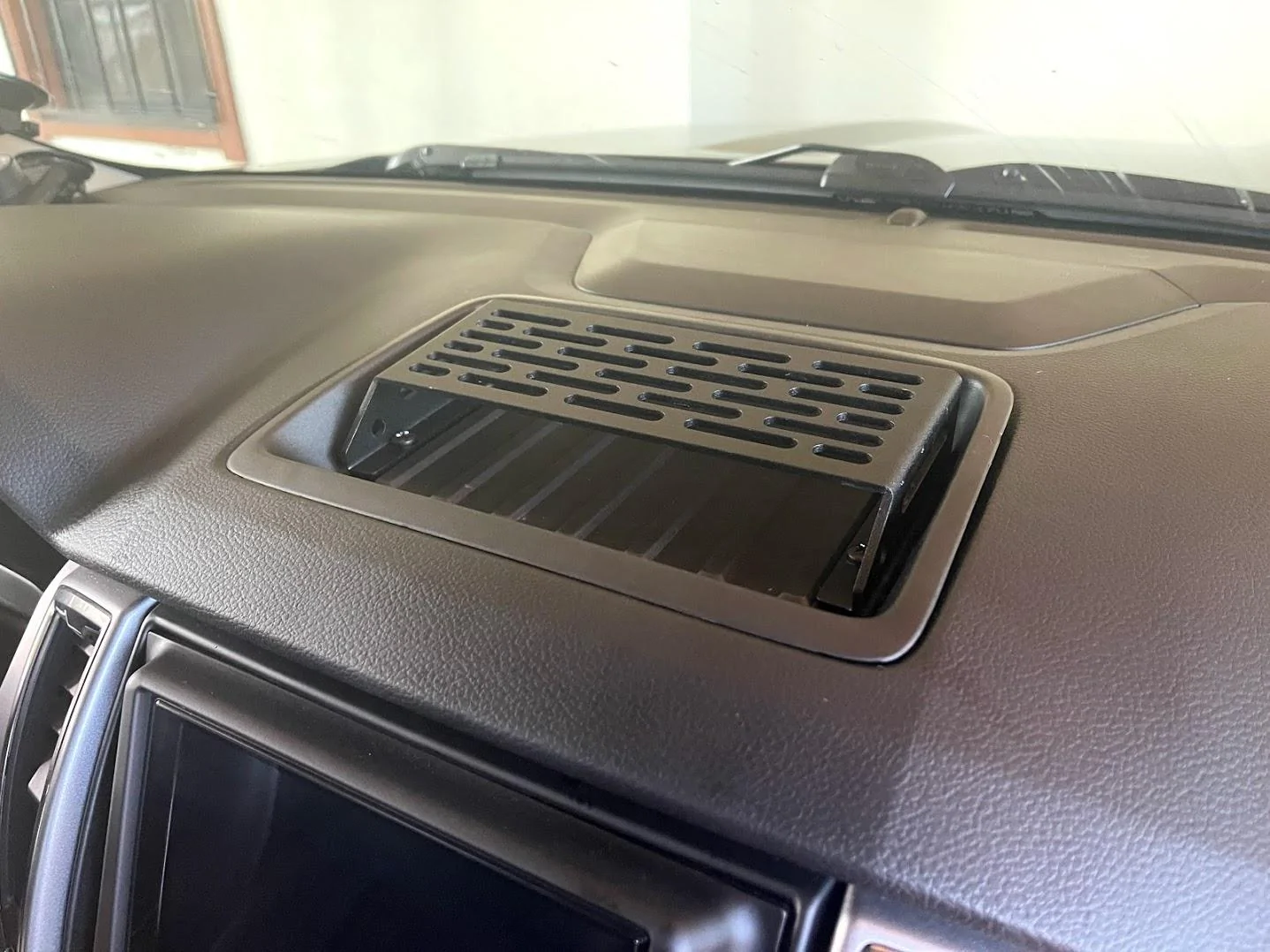

I just spent the last hour trying to get this to clip in without success. How did you all get this flush again? My side clips and back clips just wont go in (I've even hit it with a rubber hammer). I'm able to get the center spring clips in and the front clips but that's it.
I ended up ordering another "Finish Panel" (KB3Z-2104338-AA) as I ended up scratching this in the process of trying to get it in...

Looks like maybe the screws you used to attach to the dash tray are hitting some plastic underneath. That’s what happened to me, so I used a step drill bit to clearance the portion under tray. Used a grease marker on bottom of bolt to figure where to drill. Worked great. PM if you have any questions. Hopefully described it good enough.

I installed mine like this too. I had to notch farther forward (towards the driver's seat) than I thought. Once I did that, it dropped right in. I fought it for a long time. Lost one of those stupid blue pieces in the process. No rattling though, so I think it's okay.

The plastic dash is not even, you have to move the bull right closer to the cab or radio, if you mount it closer to the windshield it won't mount back in cause the bolts will hit the plastic panel.

I thought my clearance issue was towards the windshield, but it was actually away from the windshield. I fought with it for about an hour until I notched farther forward. Fell right in to place after that.

I'm puzzled. What's the clearance issue? My problem is the the front clips are not engaging no matter how much I press

The rear bolts wouldn't clear the plastic at the rear of the tray mount. I had to trim farther towards the seats than I expected. I couldn't get all the clips clipped at the same time as it would rock on those bolts. Just something to check.
I thought slowly wiggling might free it from the blue things. nope! I lost one as well into the abyss (they disappear fast!). Fingers crossed it doesn't cause a rattle.

Mine doesn't rattle (at least the clip in the dash). The tray isn't as sturdy as I'd like though, so I am looking up a replacement. If they aren't too expensive, I will just get a new tray and reinstall the mount. I also know it would be easier to install the ball mounts without the mount mounted to the tray. I'd be able to readjust my balls (hehe).

Just so everyone here has it, the part number is 044B78B from Ford and cost $27.32 (at the time of this comment). Mine will be here Tuesday and includes the blue clips on the bottom.
I got the part number from this parts diagram.
