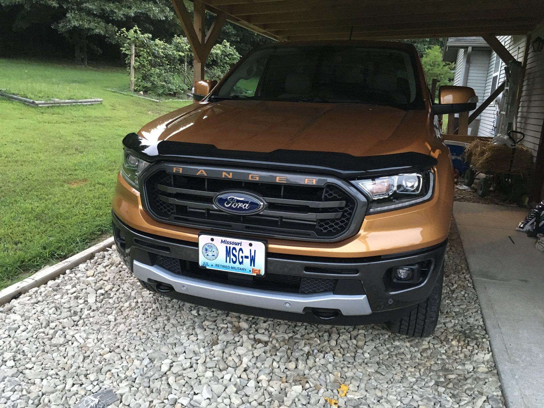

Getting close to dark but here are the photos
Thanks for the photos but I think that's a different one. The one I linked to is called aeroskin 2 black textured, it looks like it has a little lip on it. Your truck looks nice tho....the grill letters are a nice touch.

2019 Ford Ranger Lariat everything on it but Chrome Package
Thanks this one deflects not just protects. I think it does deflects when u are up on speed

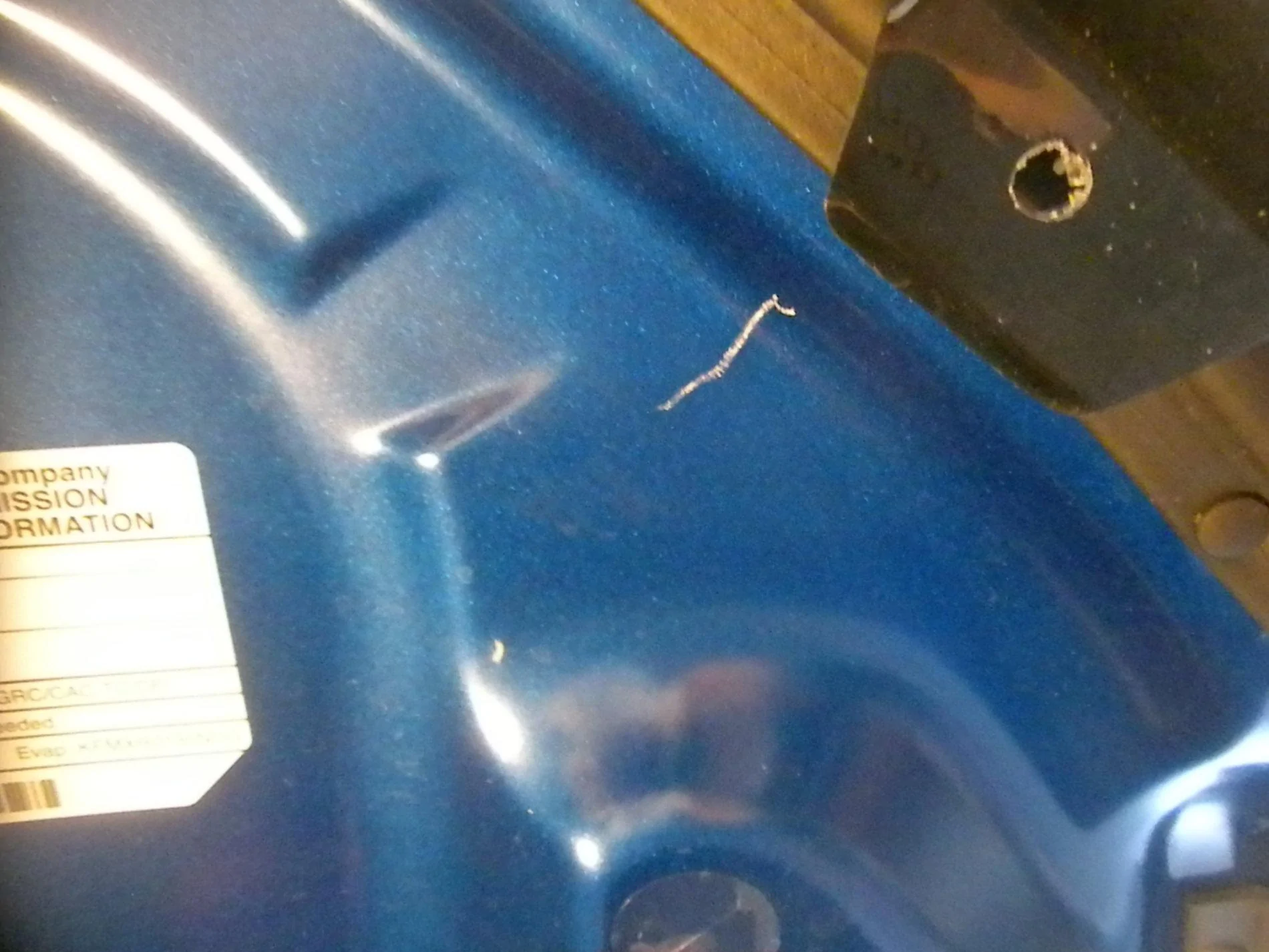

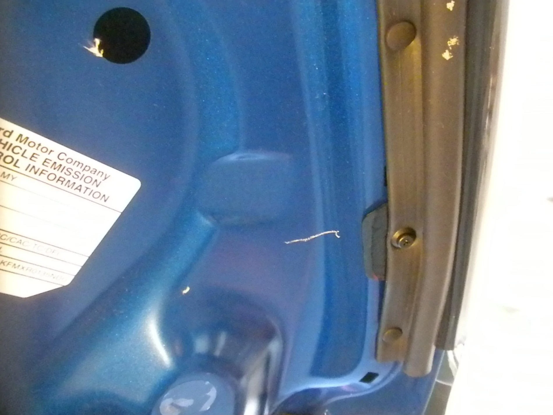

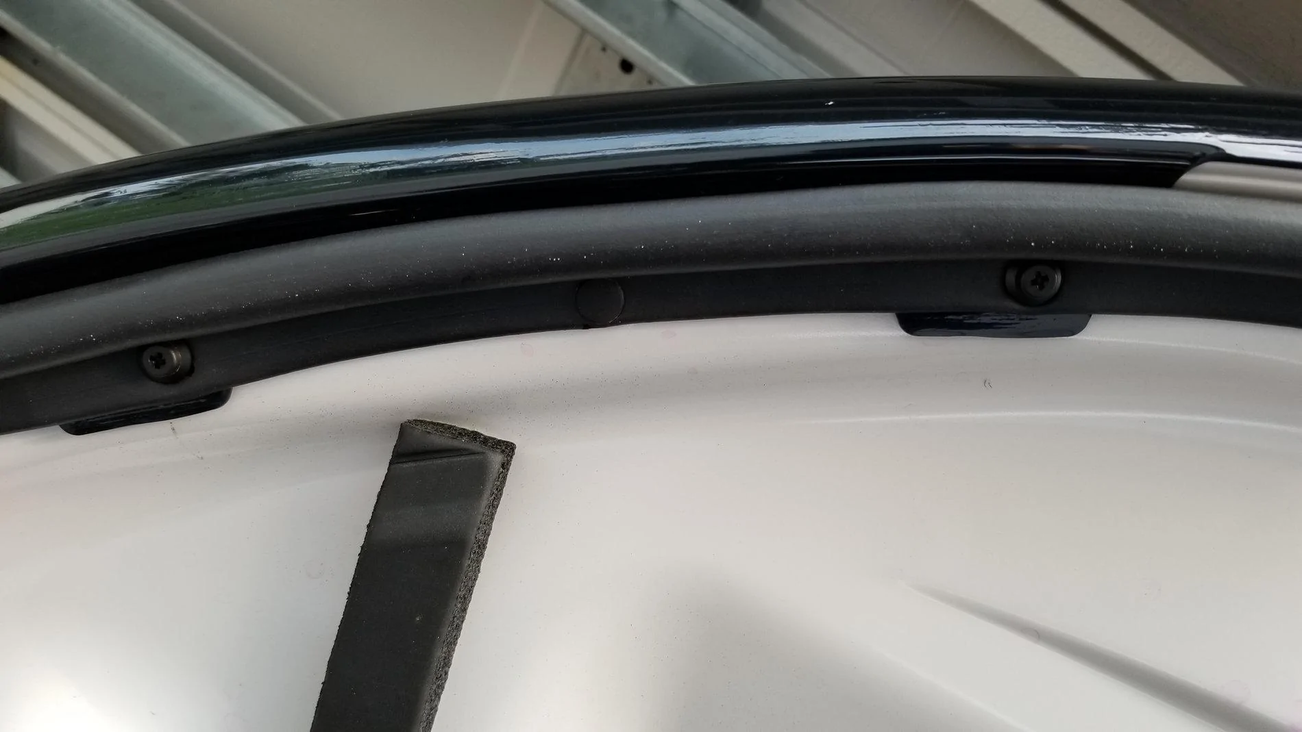

AVS install update Ordered my AVS bug deflector ll on Tue 23, estimated delivery 7-30/ 8-2. Received yesterday 7-25. Did install this morning. Install time less than 1hr. This was my procedure.
1 deburred holes on bug shield
2 cleaned leading edge of hood.
3 placed moving blanket over engine bay, if you drop a pin it may be hard to locate if ever located. They only supply 8 that are needed.
4 test fit bug shield and marked hood with calk at locations pins needed to be removed
5 remove needed pins
6 reinstall bug shield under rubber seal and locate the holes, rubber will hold it in place
7 insert new pins, make sure pin is completely inserted in hole before setting the screw
8 clean chalk marks off hood
As far as I am concerned the pin removal tool is a must have.

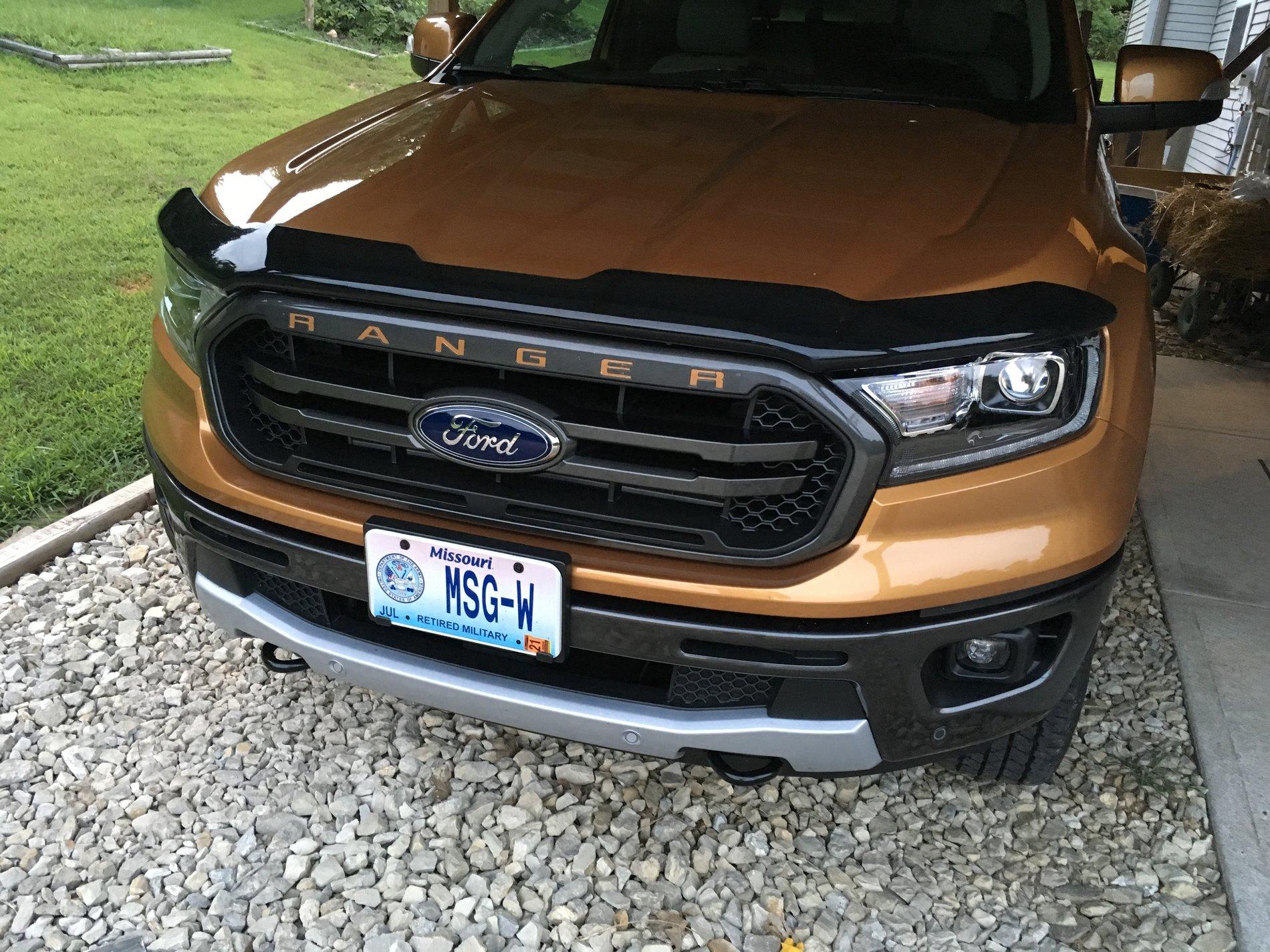

That's not the one that was shown earlier. The other has the lip to deflect flying objects. Yours looks like it will catch rocks at the leading edge but may not deflect the air over the cab.

Same one different view

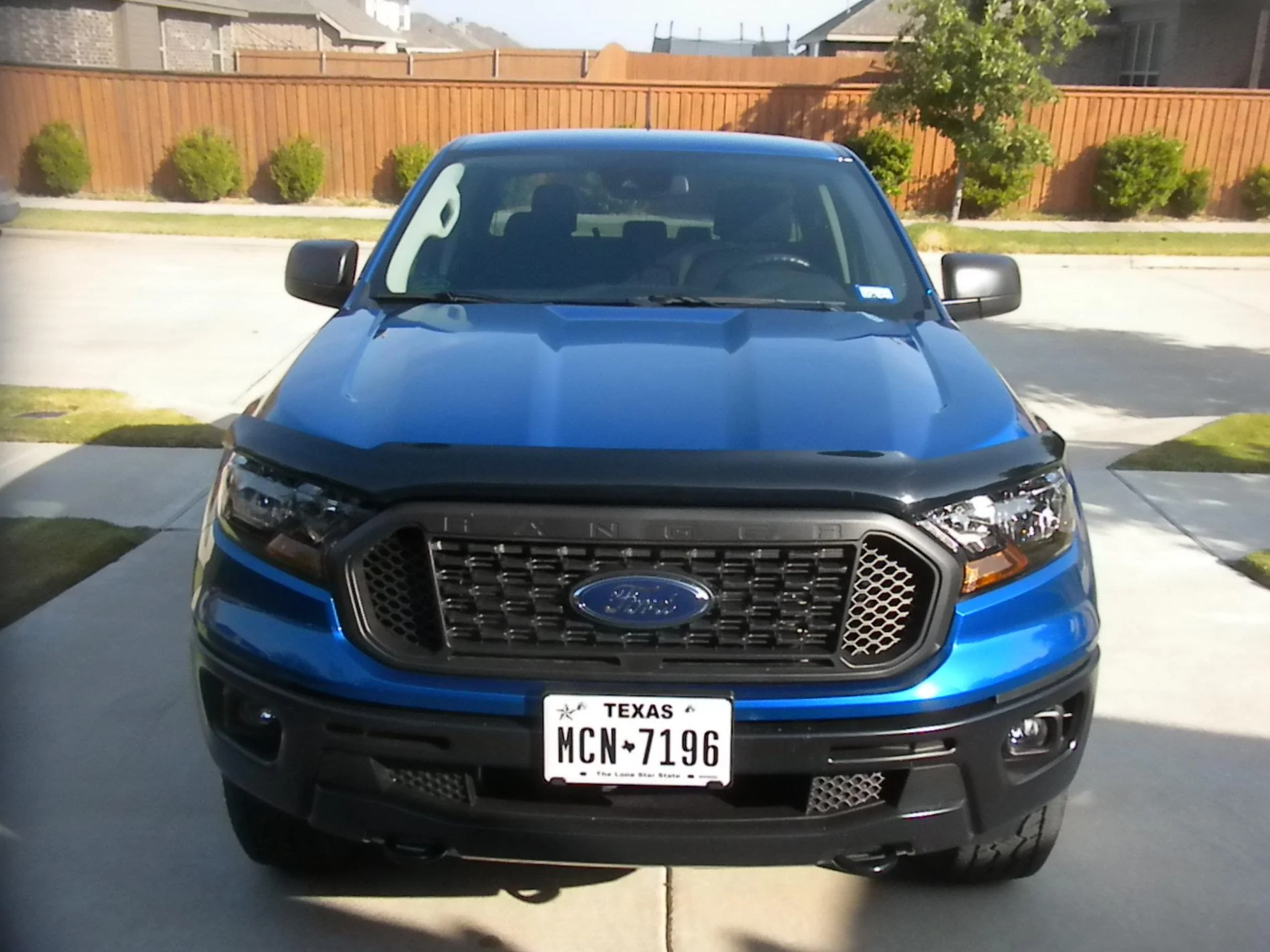

Thank you! When I get it in the mail, I will report how the install went.
So I got it today but it is slightly different than yours. Mine was adhered with tape on the top and bottom. The install sheet says "AVS Aeroskin II". I guess it is a different one.
It went on fine. I think it looks pretty good and will definitely protect the front of the hood (which already had two rock chips in it).
Mine is the AVS Bugdeflector II. It has the lip on top edge to push bugs up & over the roof. I believe yours is just a straight edge more of a protector than a deflector.
