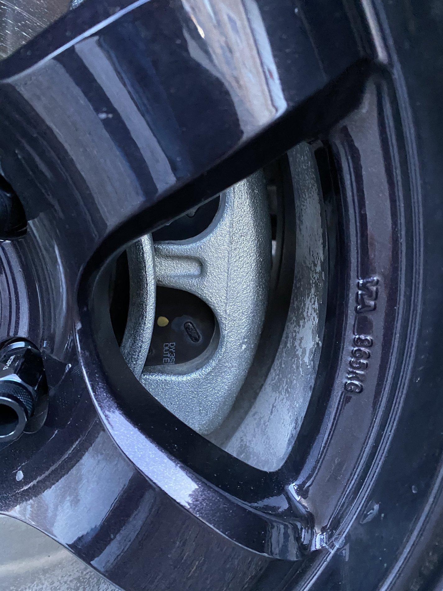

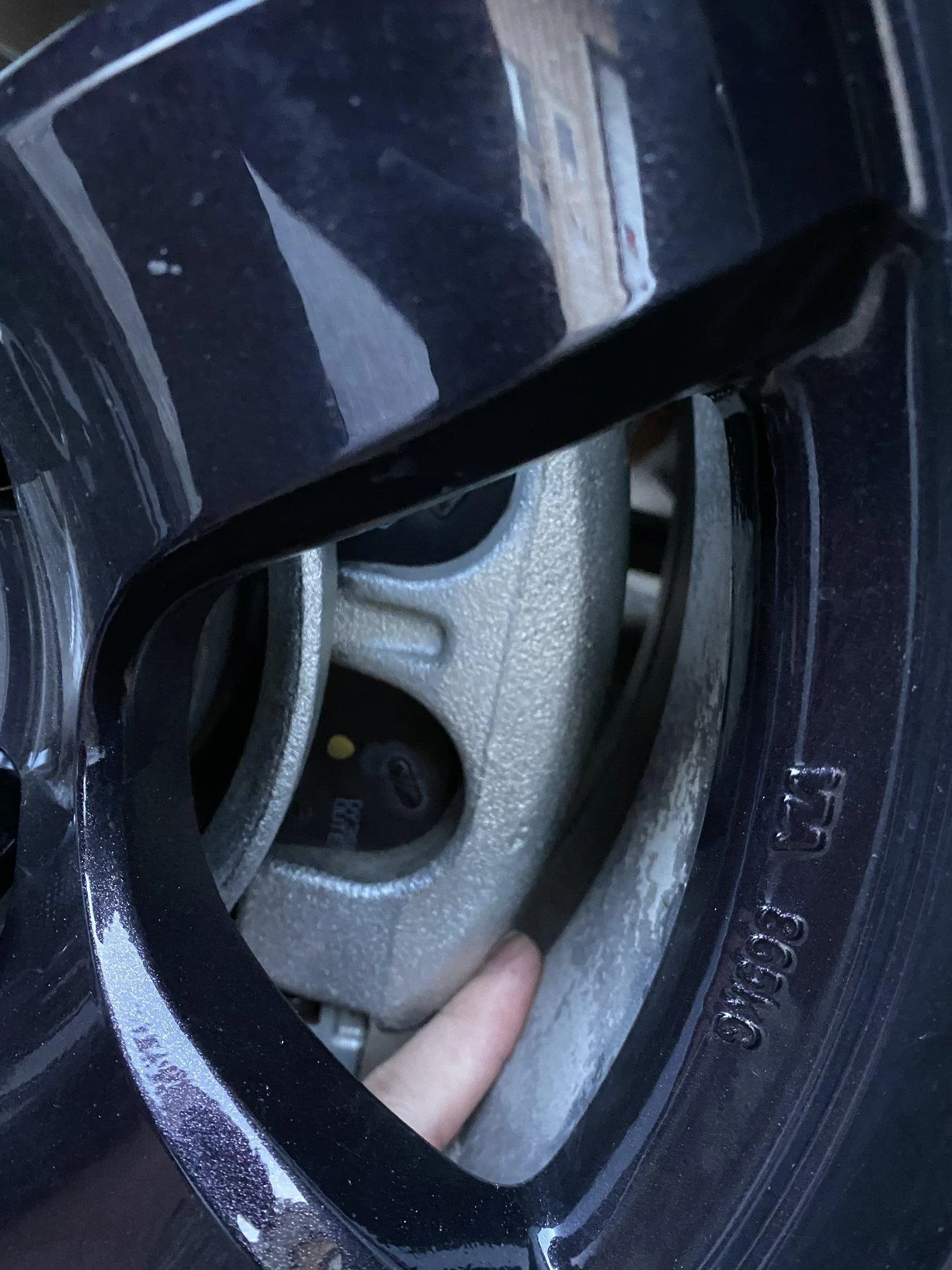

Here’s a couple pics of how much clearance there is between a 16” aftermarket wheel and the stock brake calipers. As you can see there isn’t much room so you’d definitely want to test fit a 15” wheel before making a decision.

Exactly the info I've been looking for, thanks! Looks like its 16" x as wide as I can get & still leave a little room to not rub on anything haha.

XLT FX4
