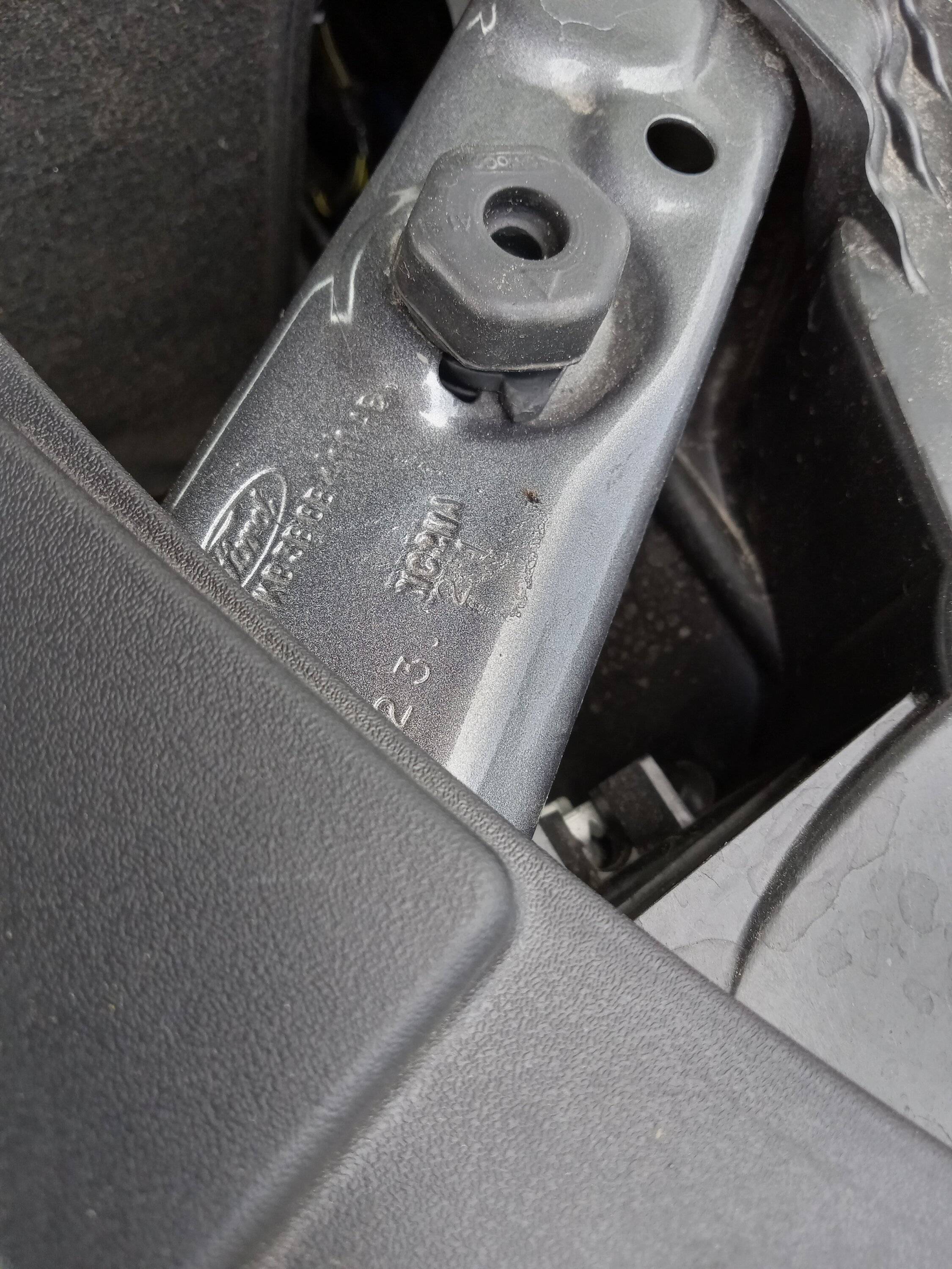

Bug shield will tighten it up too. As it goes behind the gasket. Plus there is something to press on to close the hood. Just an idea if you already wanted one.

yours won't unscrew like mine ? (2021) mine were cranked all the way down ...
not really threaded , the rubber itself is cut deep and threads into the slot of the core support ...
Well I’ll be. I just learned a new one today. They “do” adjust. Just have to crank the snot out of them. Who ever put them on has a grudge with someone! Max torque ?
