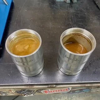

Hey guys, this is one of our test vehicles for one of our catch can setups installed with about 4k miles on it. As you can see there is a TON of blow by (moisture/gas) which ends up bypassing the PCV system and gets thrown back into the engine. A catch can will help clean keep the engine significantly cleaner and the valves from being caked with unburned fuel.
