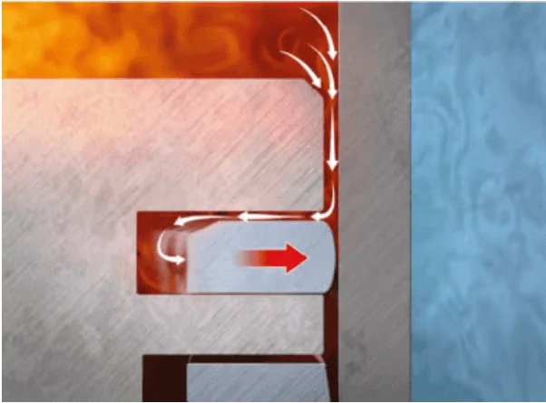

In the racing world they drill a very small hole in the top of the piston to the back side of the top ring land. The compression puts pressure in that hole and forces the ring against the cyd wall.. Not sure if ranger has them holes or not…

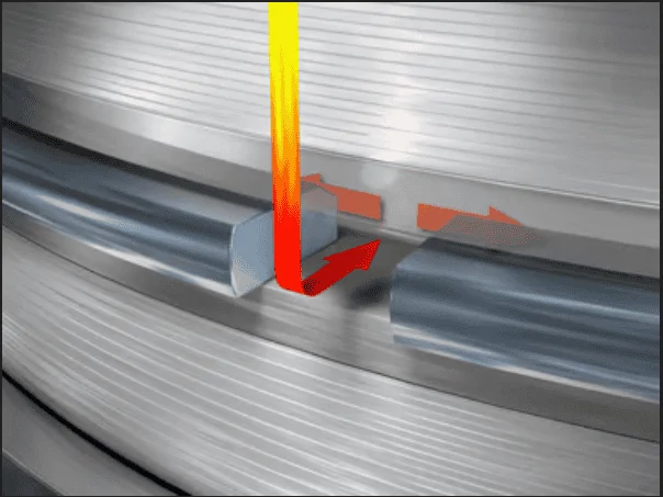

That gap exists in all rings, no matter the tension strength. Wouldn't widening the gap allow more combustion gas to bypass the rings. I know that the ring gaps are offset, but the gas flow will still follow the path of least resistance.

Low tension piston rings have been in use for decades now and like the pistons themselves ring designs have been markedly improved over the years - these changes have reduced internal engine friction losses by as much as 40% - and yes result in improved fuel economy. There are scientific papers that do evaluate the effectiveness of the changes and many engines today are able to handle higher thermal levels from boosted engines and gdi . Like nearly everything in the ICE engine in the past 40 yrs has been redesigned for improved efficiency and lower emissions. This has allowed consumers to drive heavy powerful vehicles that are more fuel efficient than lighter vehicles of decades past.
So yeah just drive it and enjoy.
https://www.underhoodservice.com/advances-in-piston-ring-technology/
