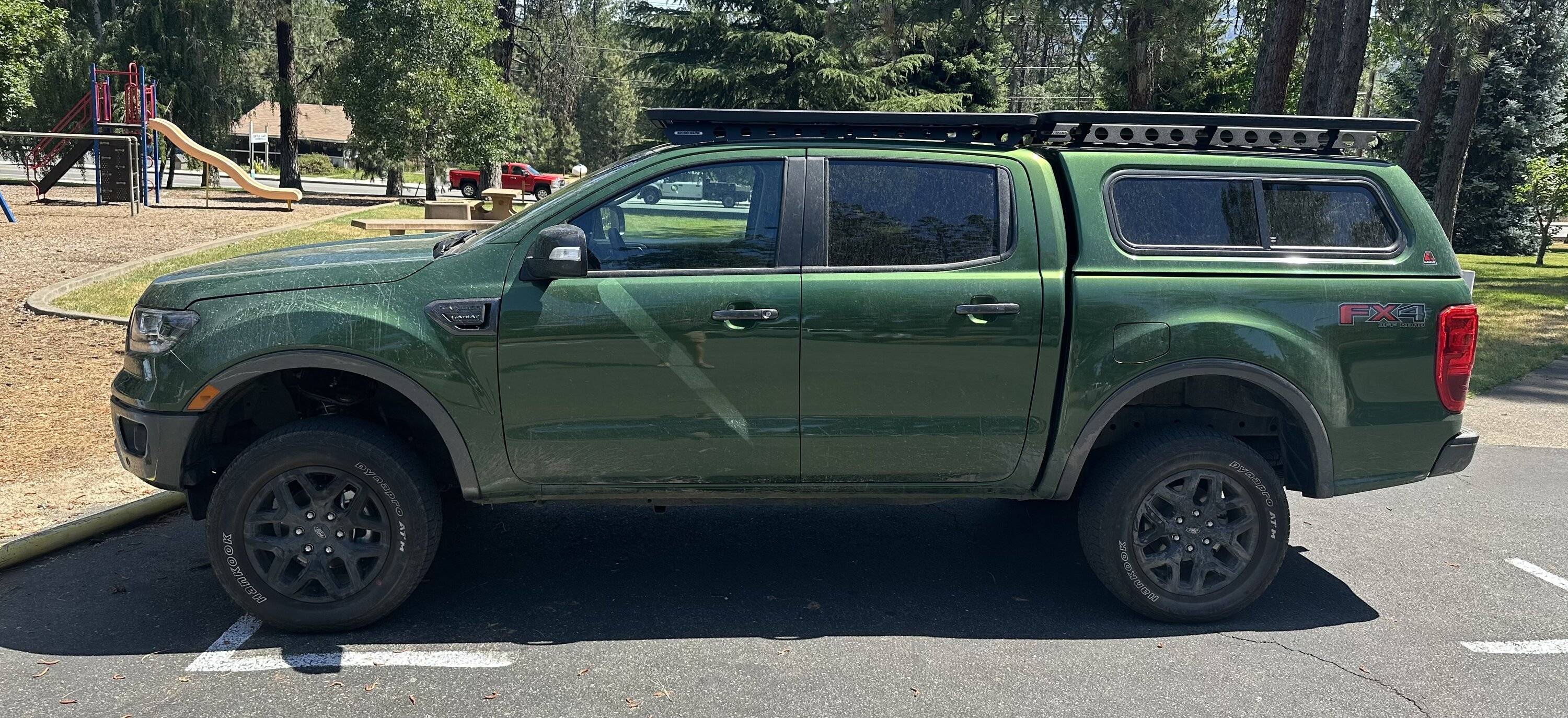

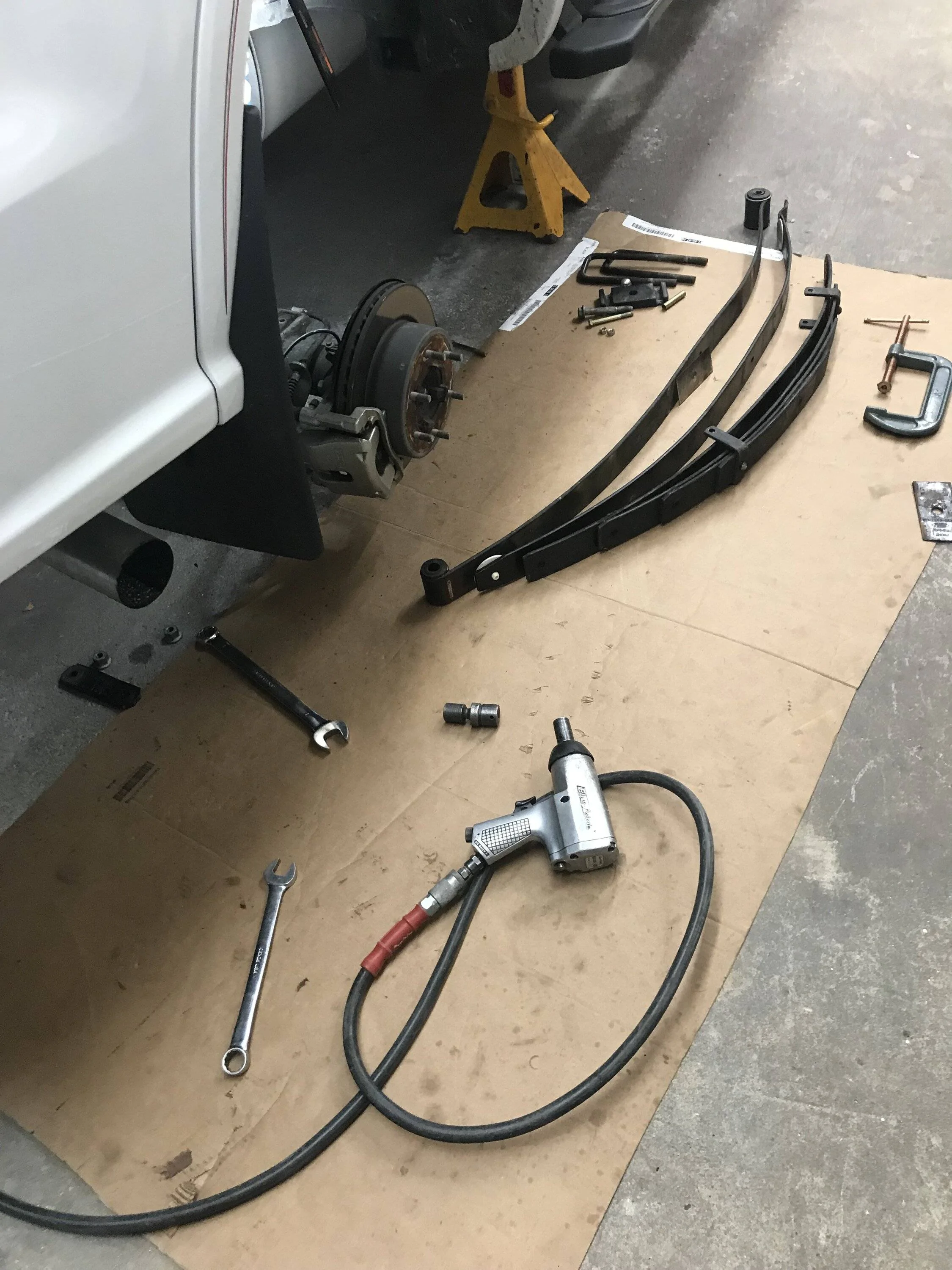

Switched to Icon multi rate rear leaf springs and the Eibach Pro Truck Stage 2R shocks (front coilovers and rear reservoirs).
The Icons with the additional leaf did a good job bringing the rear back up to stock height with all the weight on the back. I was a bit surprised how much of the coil adjustment the shop had to use to get the front up to level, though.

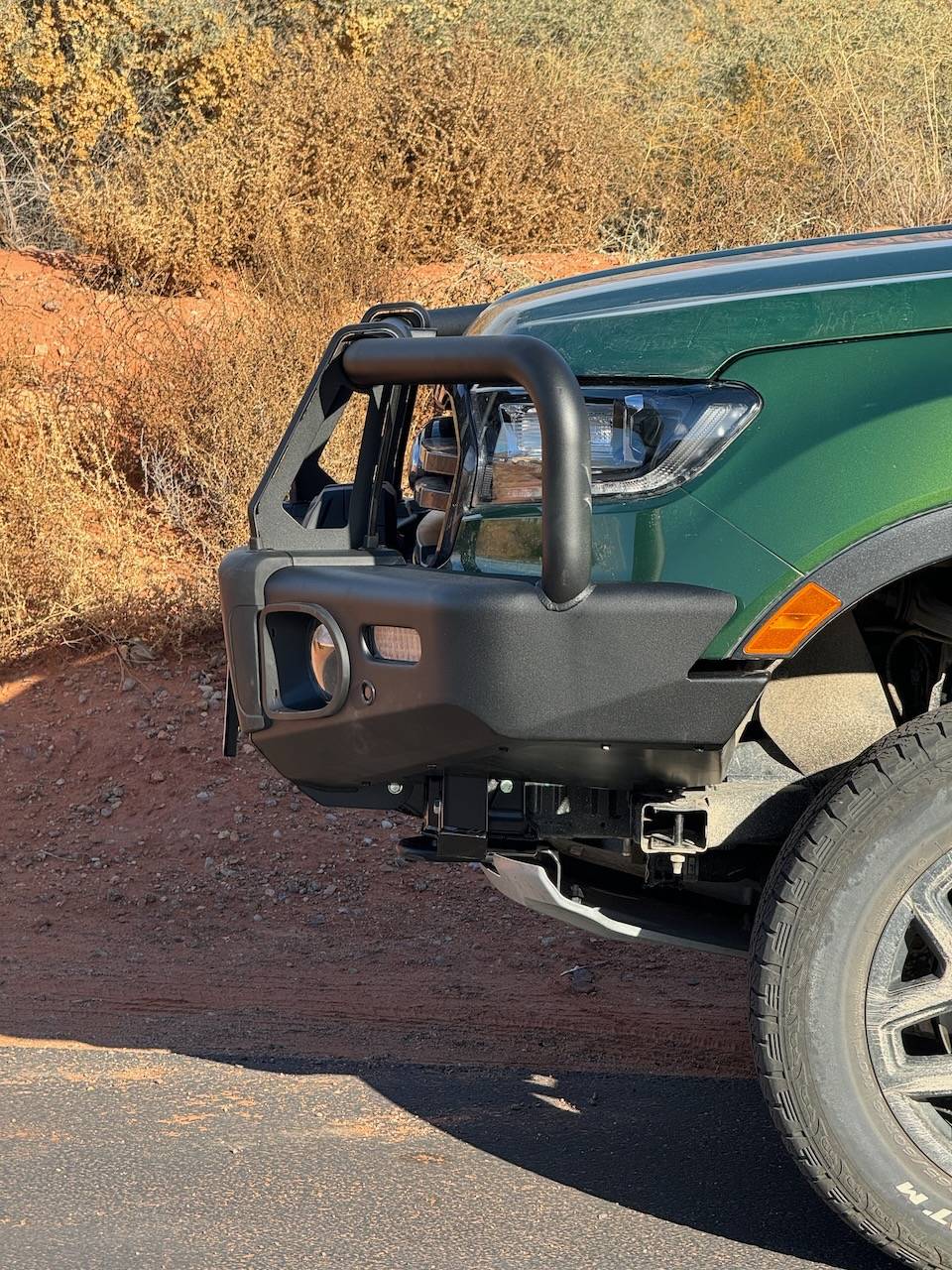

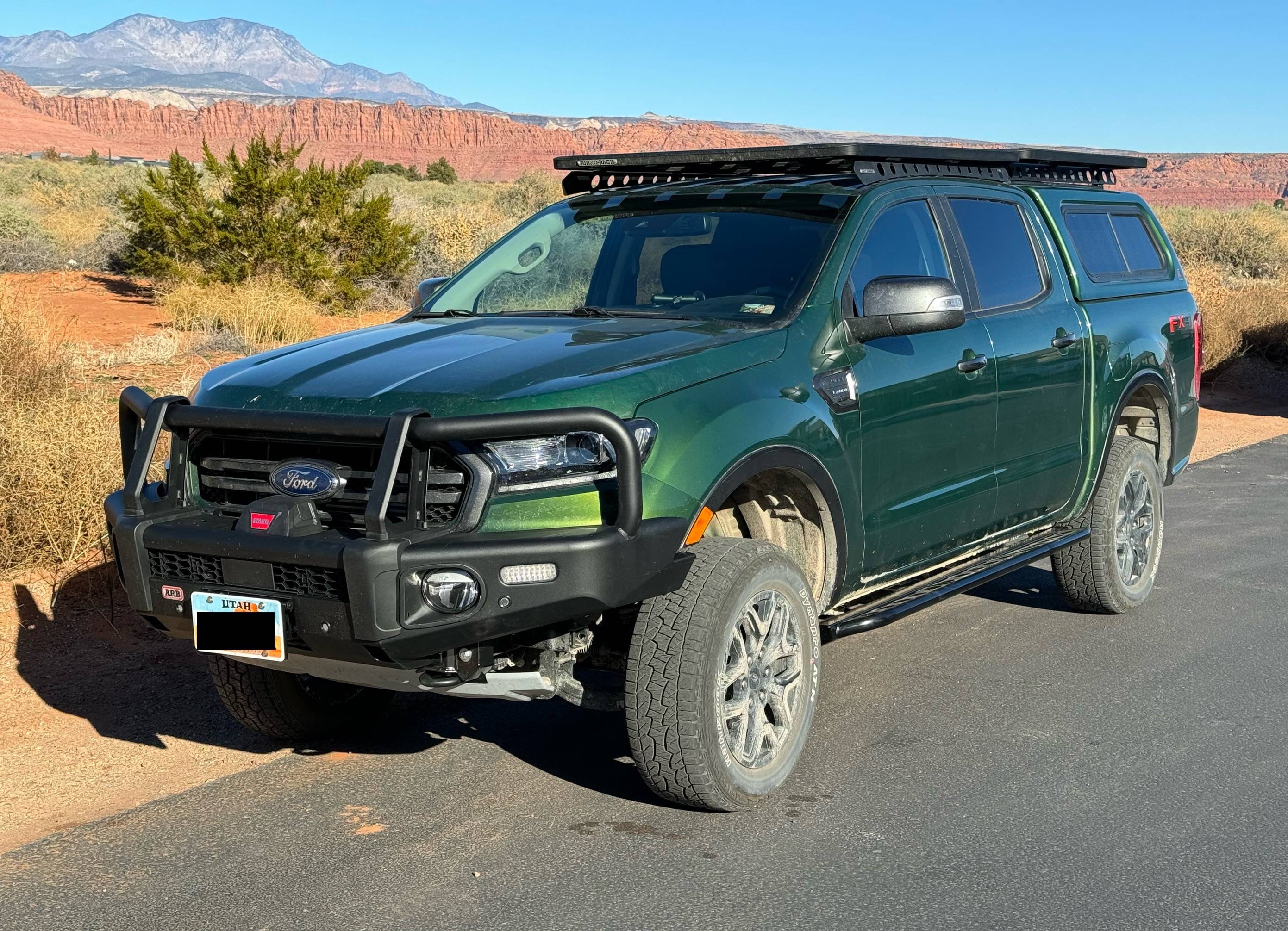

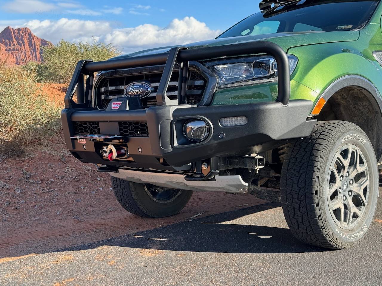

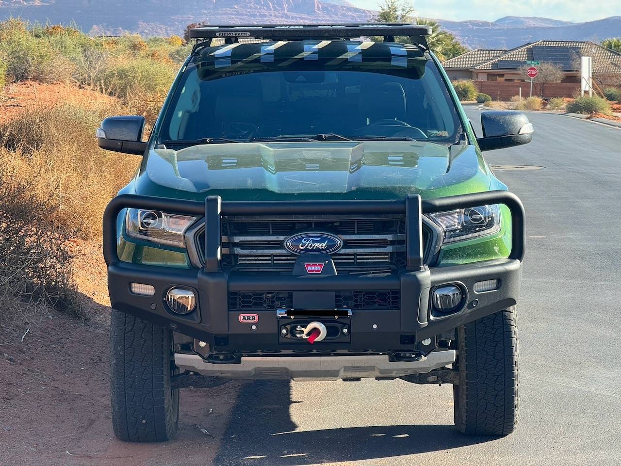

ARB Summit bumper and a Warn VR EVO 10S winch.
I was a bit nervous about the Adaptive Cruise Control and the parking sensors, but all seem to be working fine after relocation. Dixie 4 Wheel Drive in St George did a great job on this.

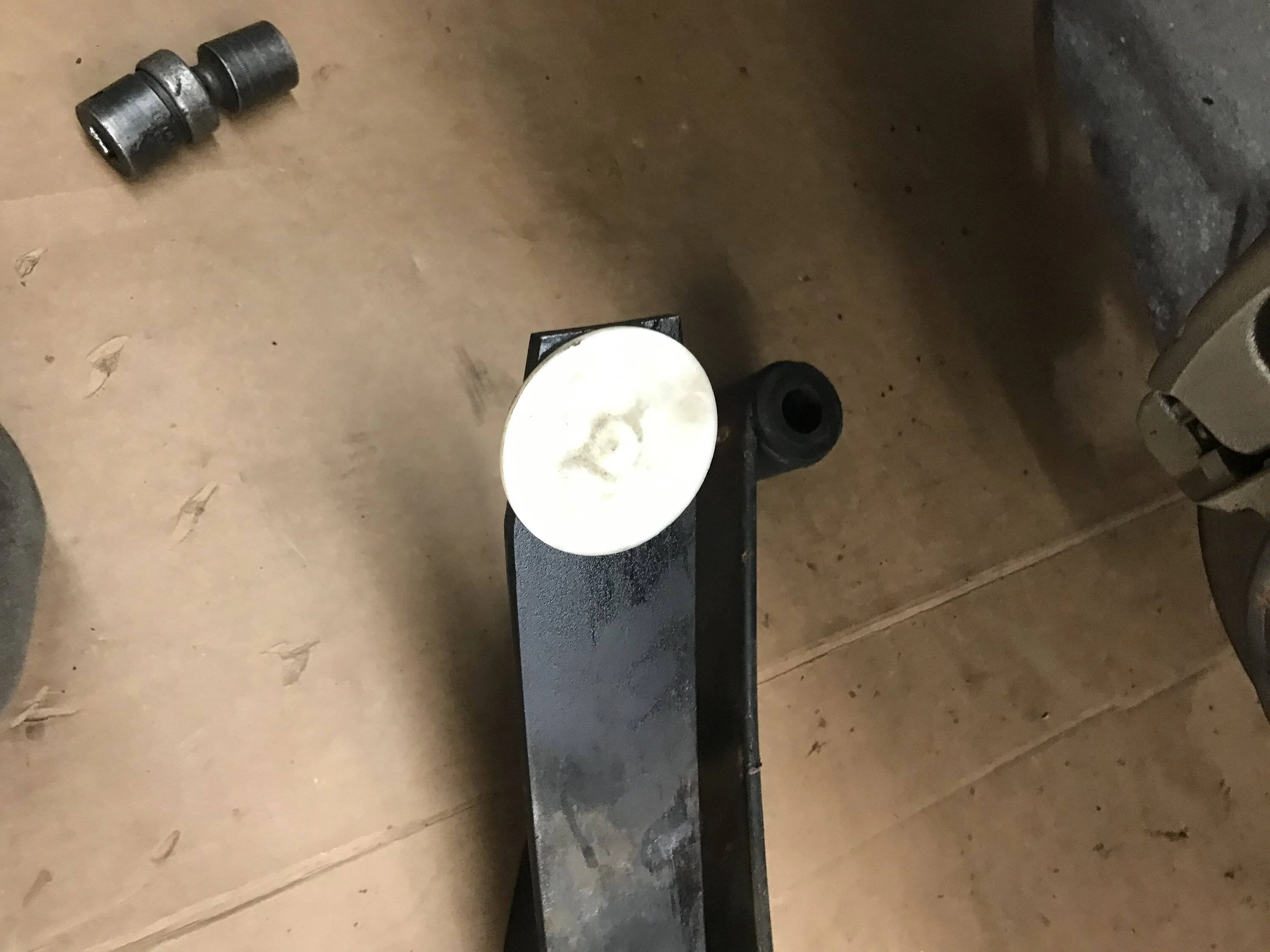

Black eagle, your rear springs squeek? Mine were really bad. Got no help from icon or stage 3..I removed the springs and added spring cushions under the leafs that didn’t have them..fixed it,
tip from a member here

@2021Ranger No squeaking that I’ve noticed. I have the Icon leaf springs.
aaiceman
Aug 4, 2023
2021 Ford Ranger Tremor
If you don't mind me asking, how much did the bumper cost?
The bumper itself was $2350.41 shipped. Throw in the winch and installation and I was all in for $4704.48.
