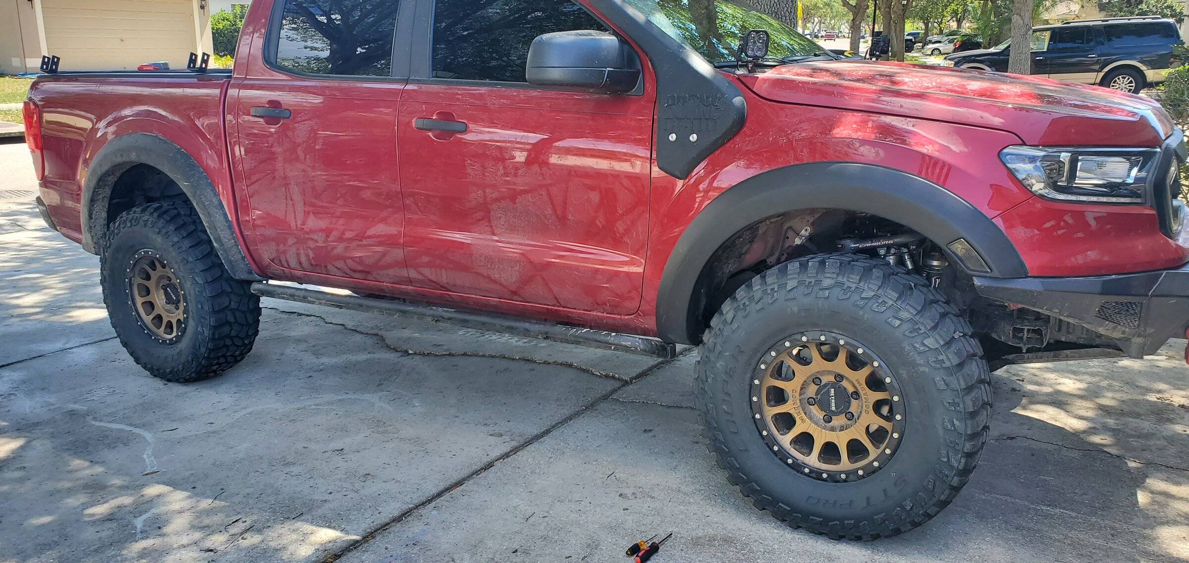

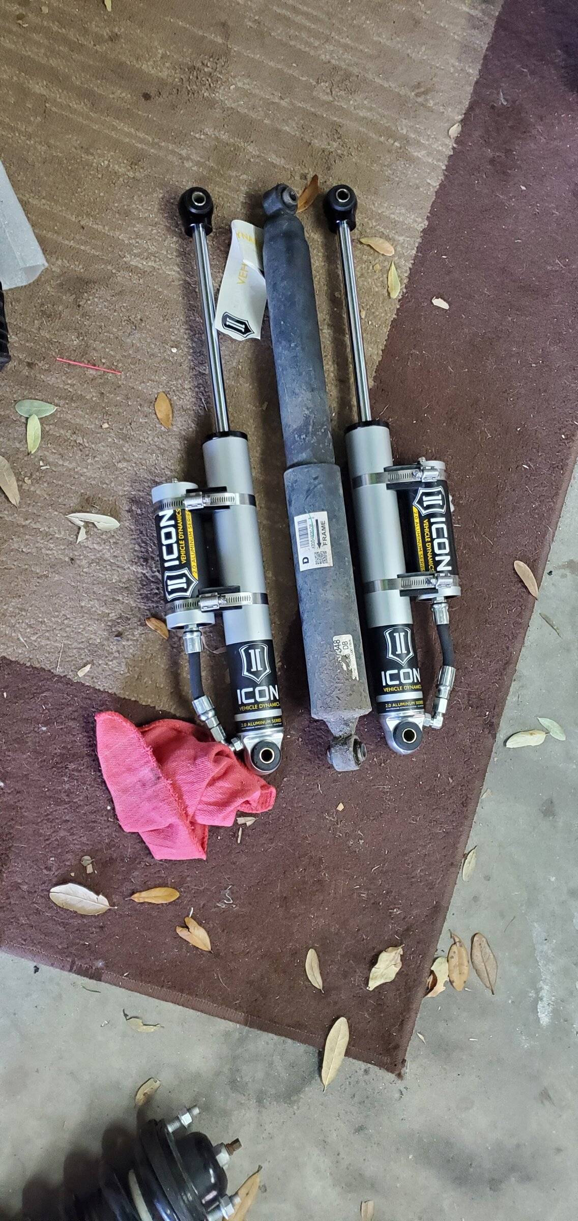

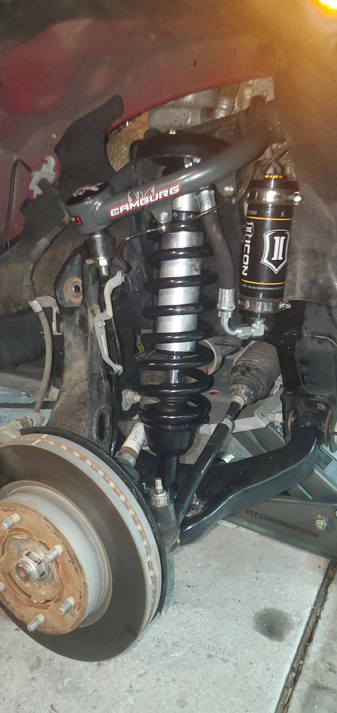

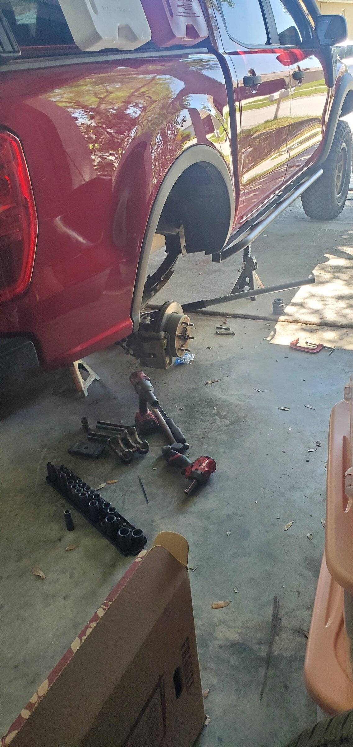

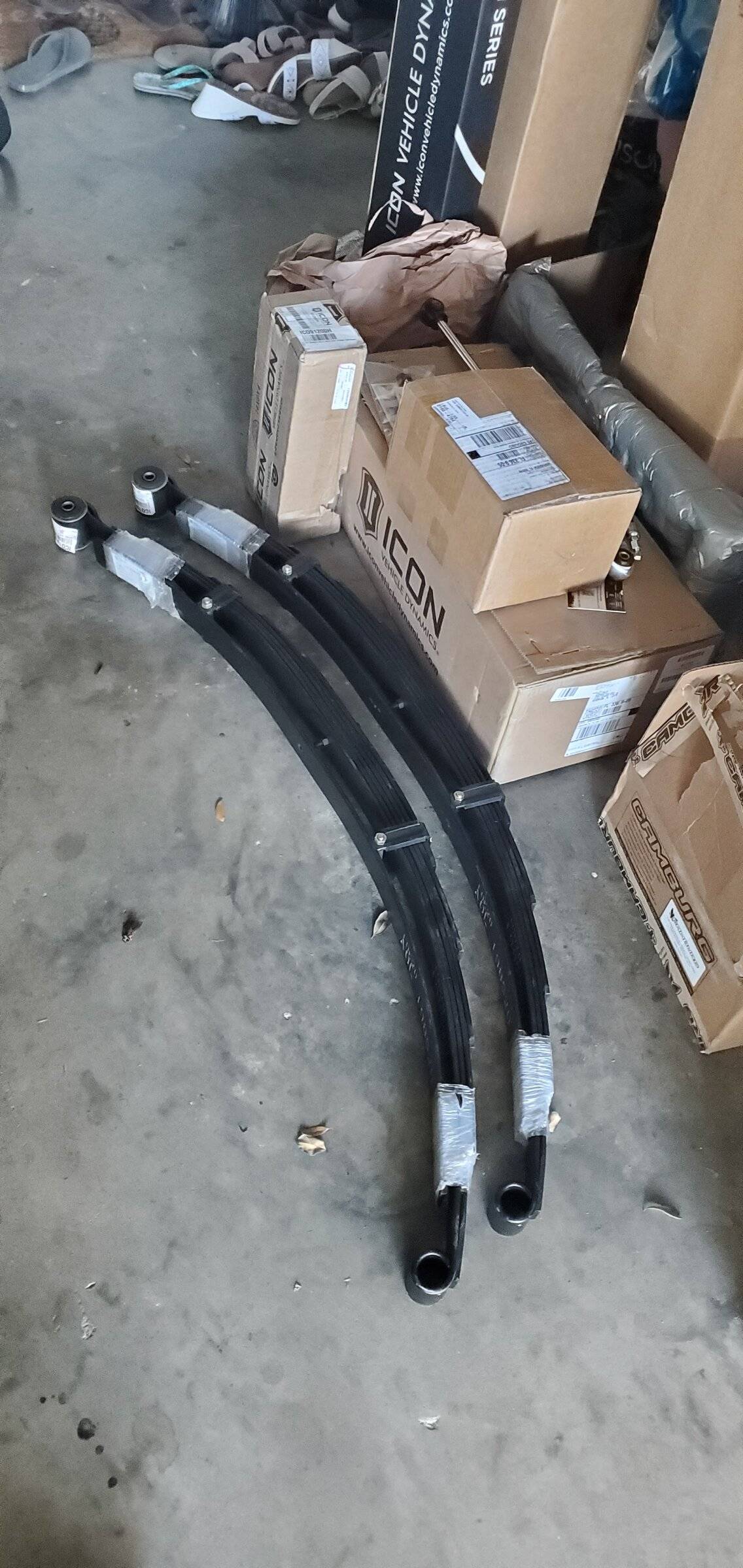

Added 3 more turns tonight on my Icon Coilovers tonight. Getting close to max lift on these. Already added a 1in bottom spacers
Are the ICONs setup you got can be adjusted while it is loaded? Or did you have to remove them?

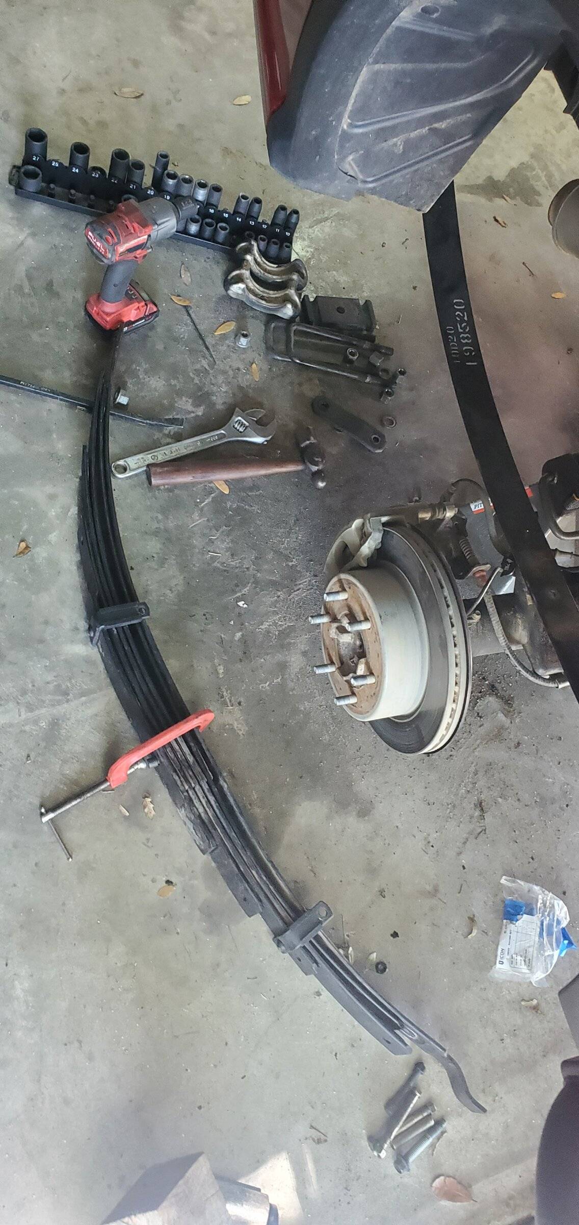

If you take most of the weight off the front with a car jack you can adjust the front. The rear you have to take apart to change the amount of leaf springs.

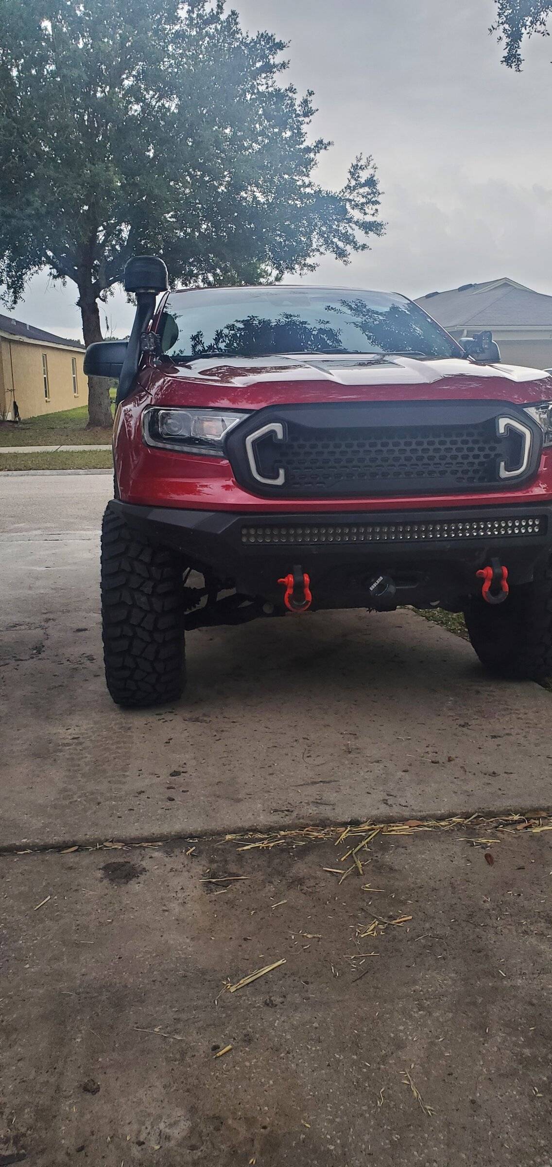

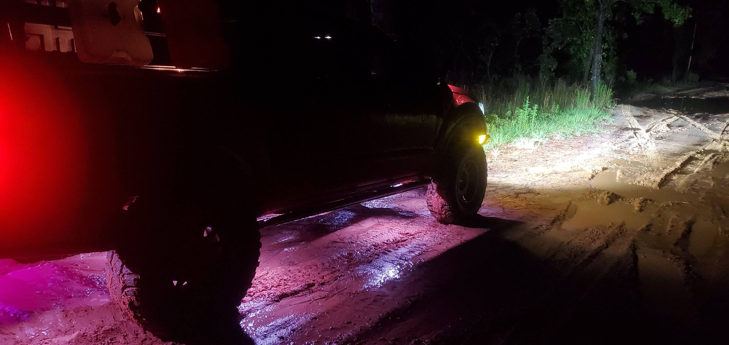

Went night offroading during a storm in Florida. Truck did great but man was there a lot of water. At one point my headlights went under water.

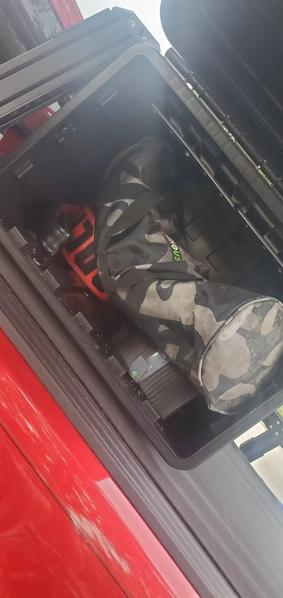

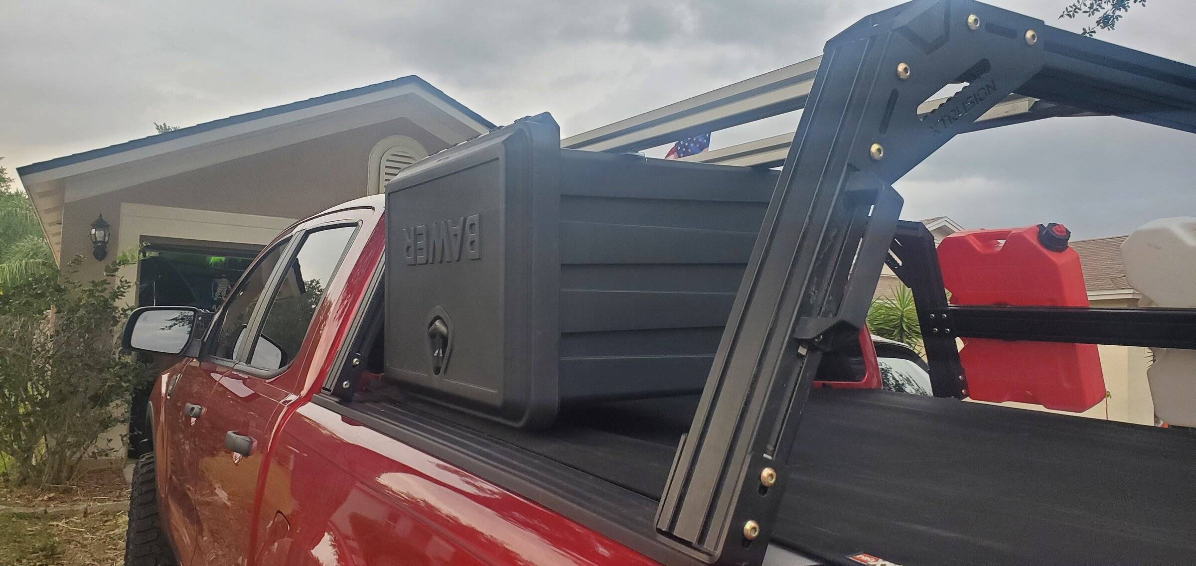

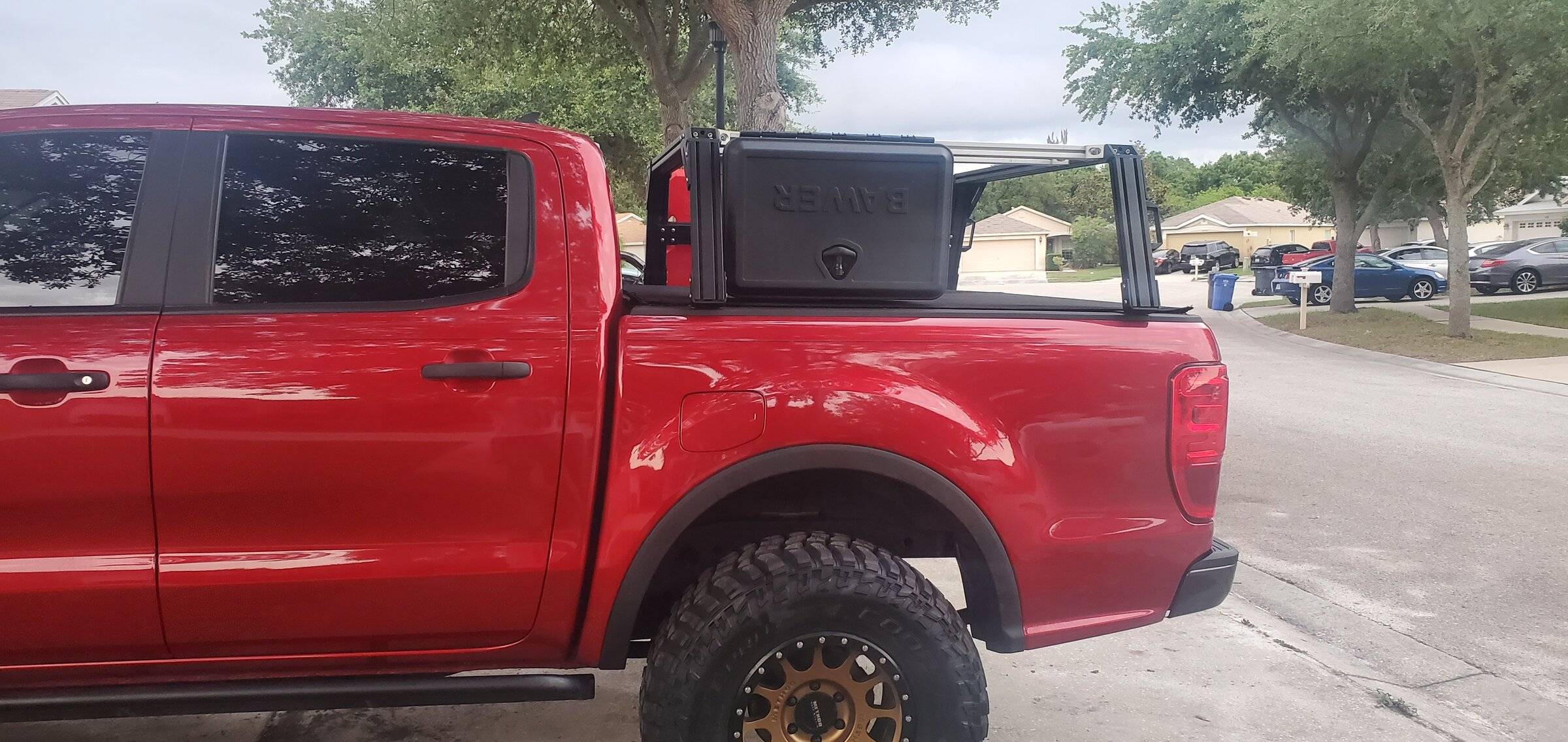

Got my quick access recovery gear box mounted. Still needs some adjustments. Need to order more pieces for the rest of my rack build. Bonus full frontal.
I know this is a little old but what mods did you have to do the the roll up bed cover to fit the rack? I have the same cover but been debating on getting a mid height rack but don't want to loose my bed cover.
I had to notch the bed cover rails where bed rack mounts are. My recovery box keeps me from rolling up the bed all teh way. One day I'll get a retrax

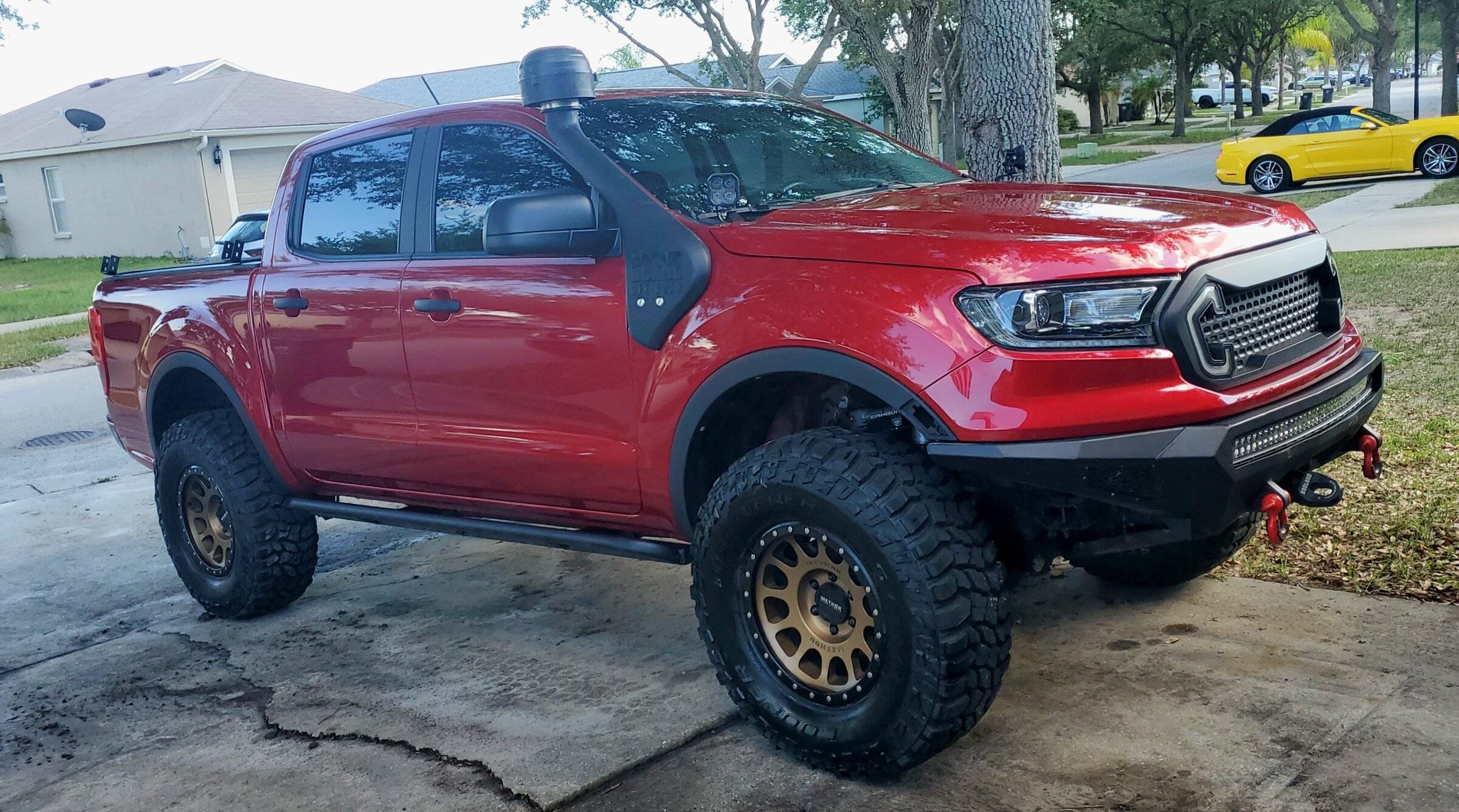

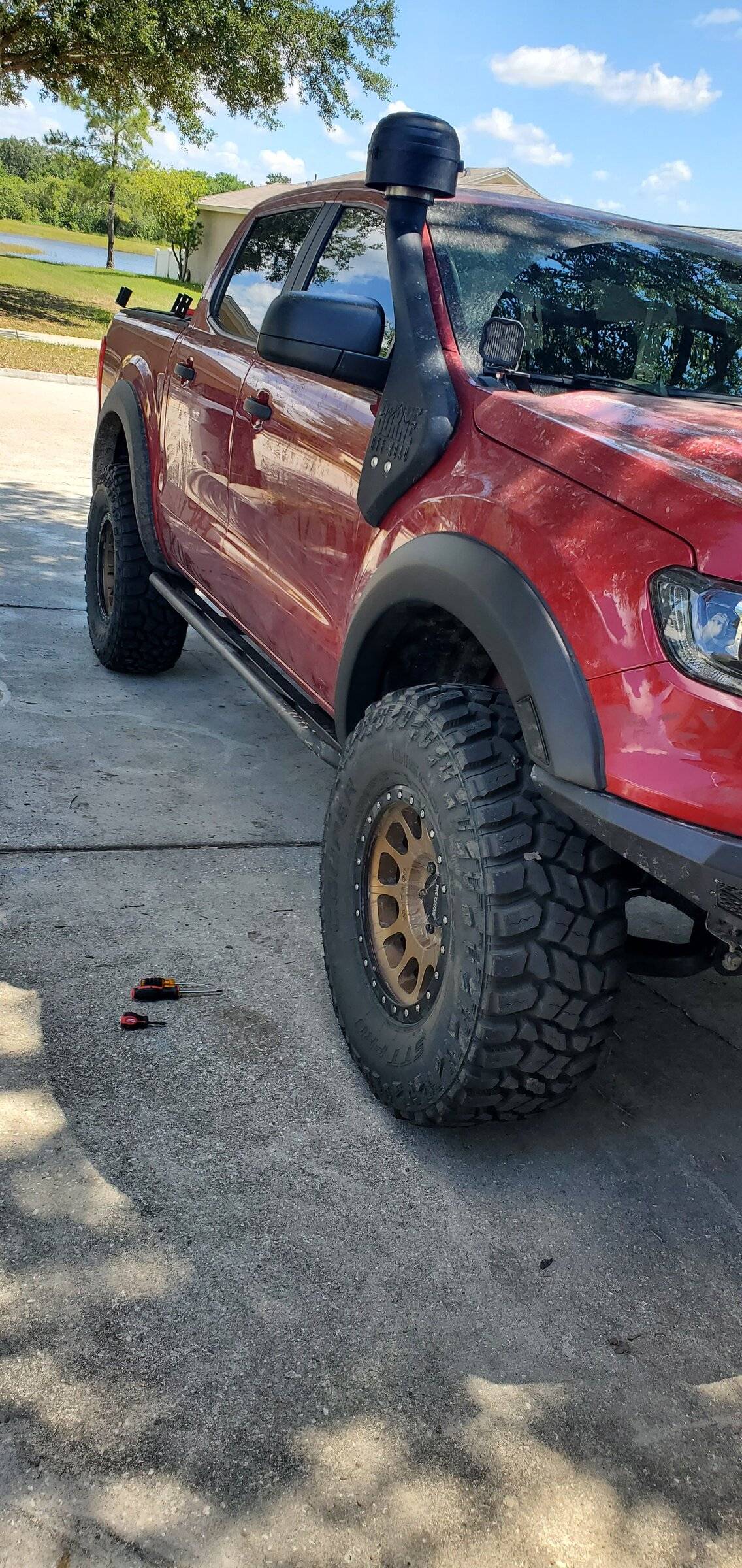

Now I want to try to fit 37s with 3.5in of lift. Also looking for different bump stops to limit travel. I have Icon now.
