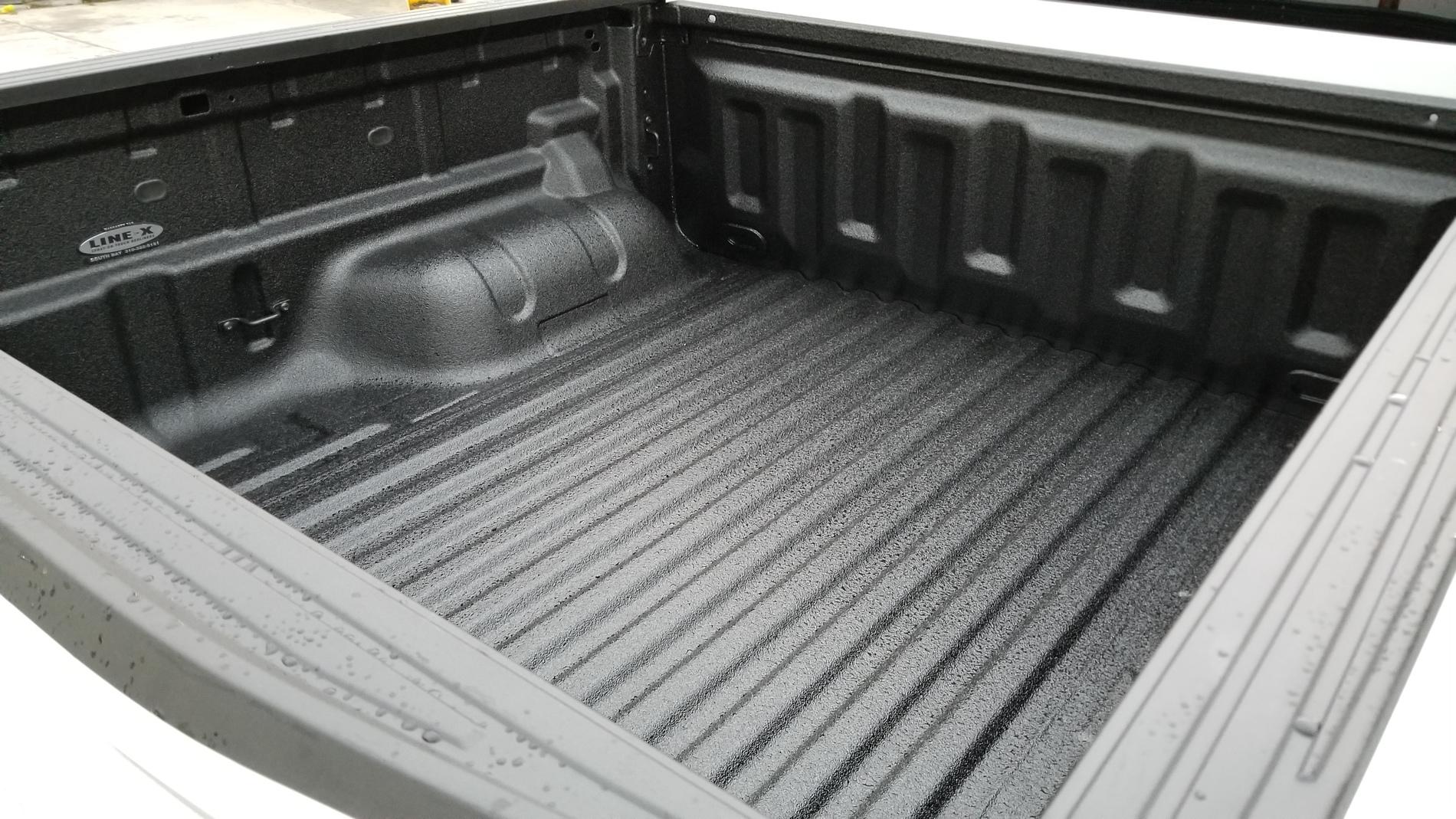

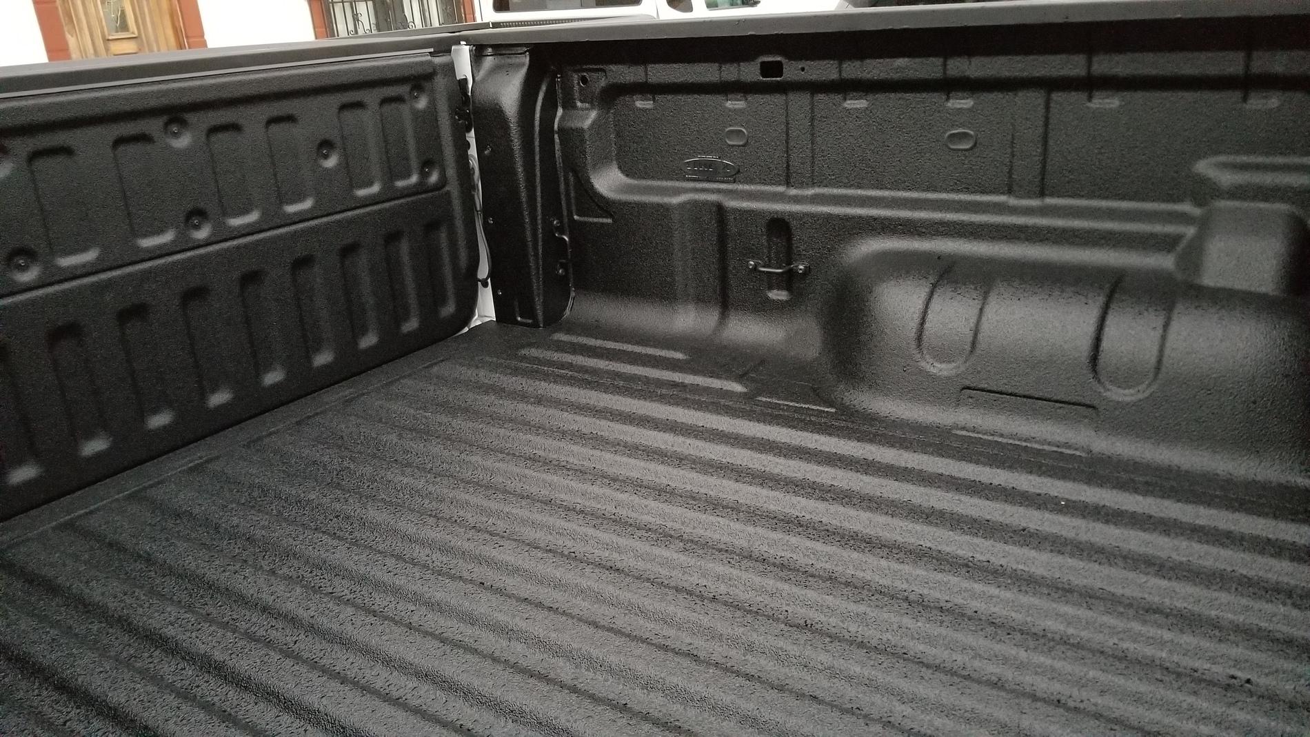

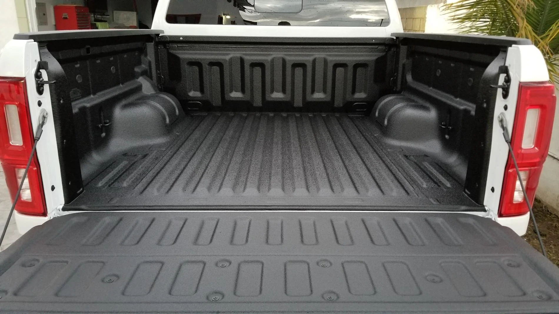

Got my bed coated today with Line-X Premium. As far as I can tell, they did a great job! Updated the first post.

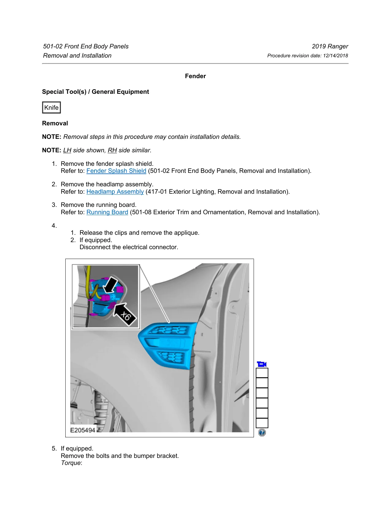

Thank you for the very well done video. I won't be getting the Raptor grill, but this will help me remove the the chrome grille that comes on the Lariat. I will be painting it Shadow Black to match the rest of the truck, and also will paint the chrome side vents. Does anyone know if the side vents are just held in with clips?
Also, in your video, you removed two screws after removing the stock grille, one each, to the sides of the grill opening, down lower. Does the Raptor grille use those 2 attachment points, different from the stock grille?
Thanks! Yes, the two lower bolts I removed do NOT hold in the stock grille, however they ARE used as mounting points for the Raptor grille. You don't use any of the 7 clipping points that the stock grille does, just the 4 bolt locations. Regarding the side vents, they are just held in with 3 or 4 clips, if you pull straight out they should come out fine. Check @rangerdanger 's post below.

Thanks for the image, I have that downloaded somewhere as I downloaded all the manual links that were posted. Looks like it's a little more work than just "popping" it out, but not so bad. Can't wait to get the truck and then get it in the home shop for a little paint work.
