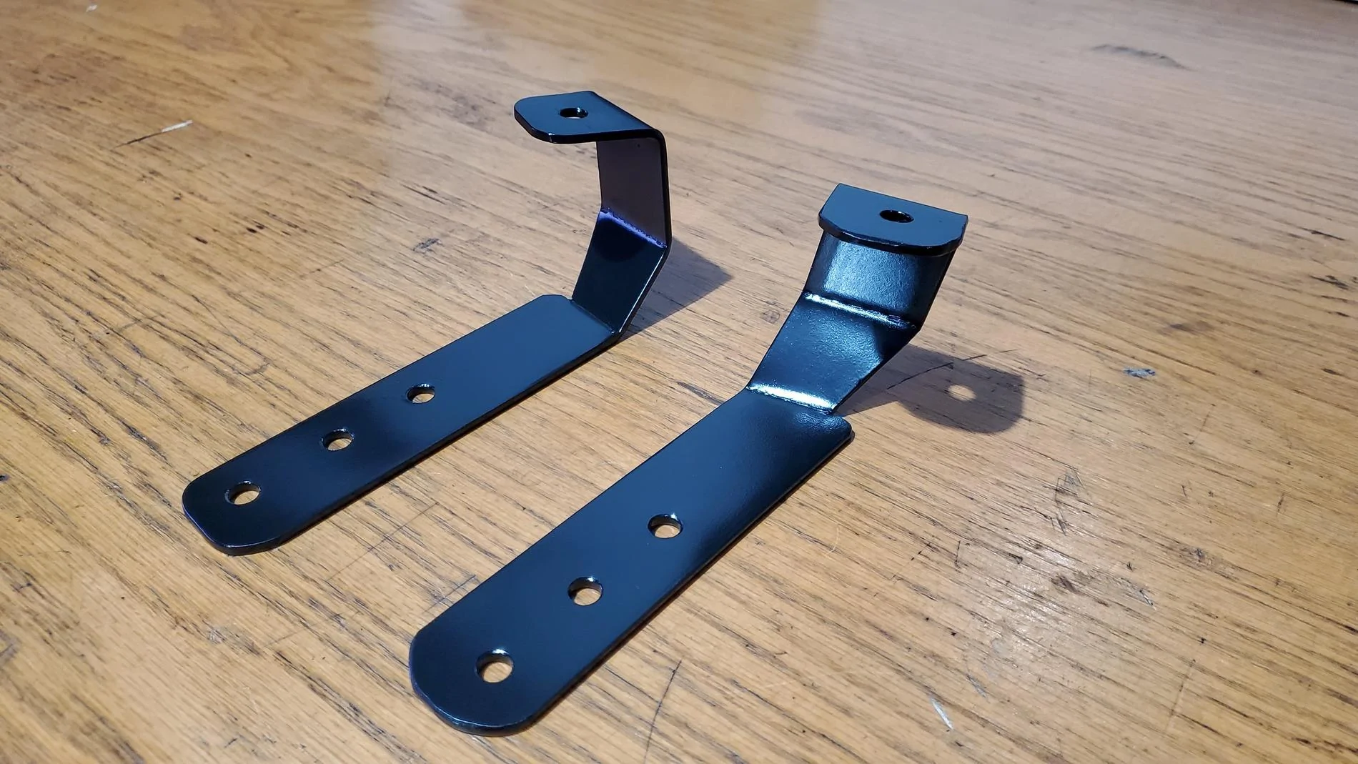

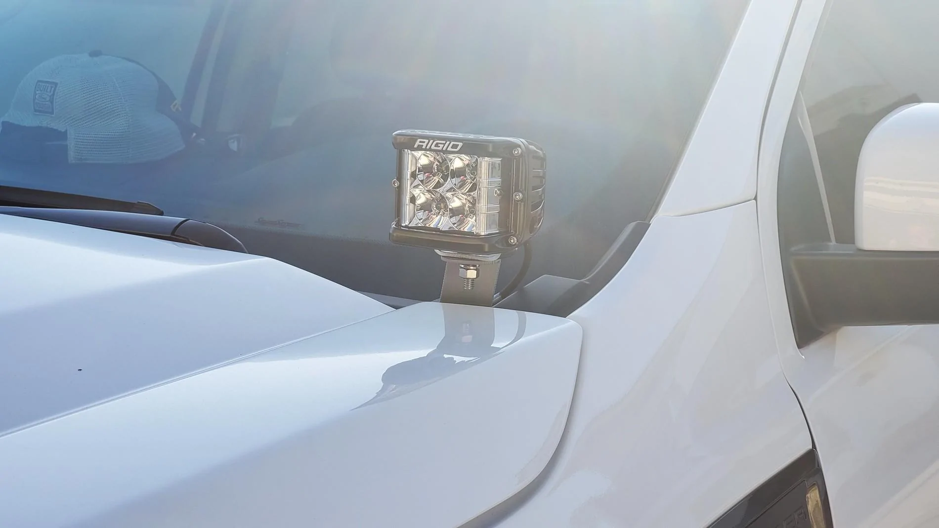

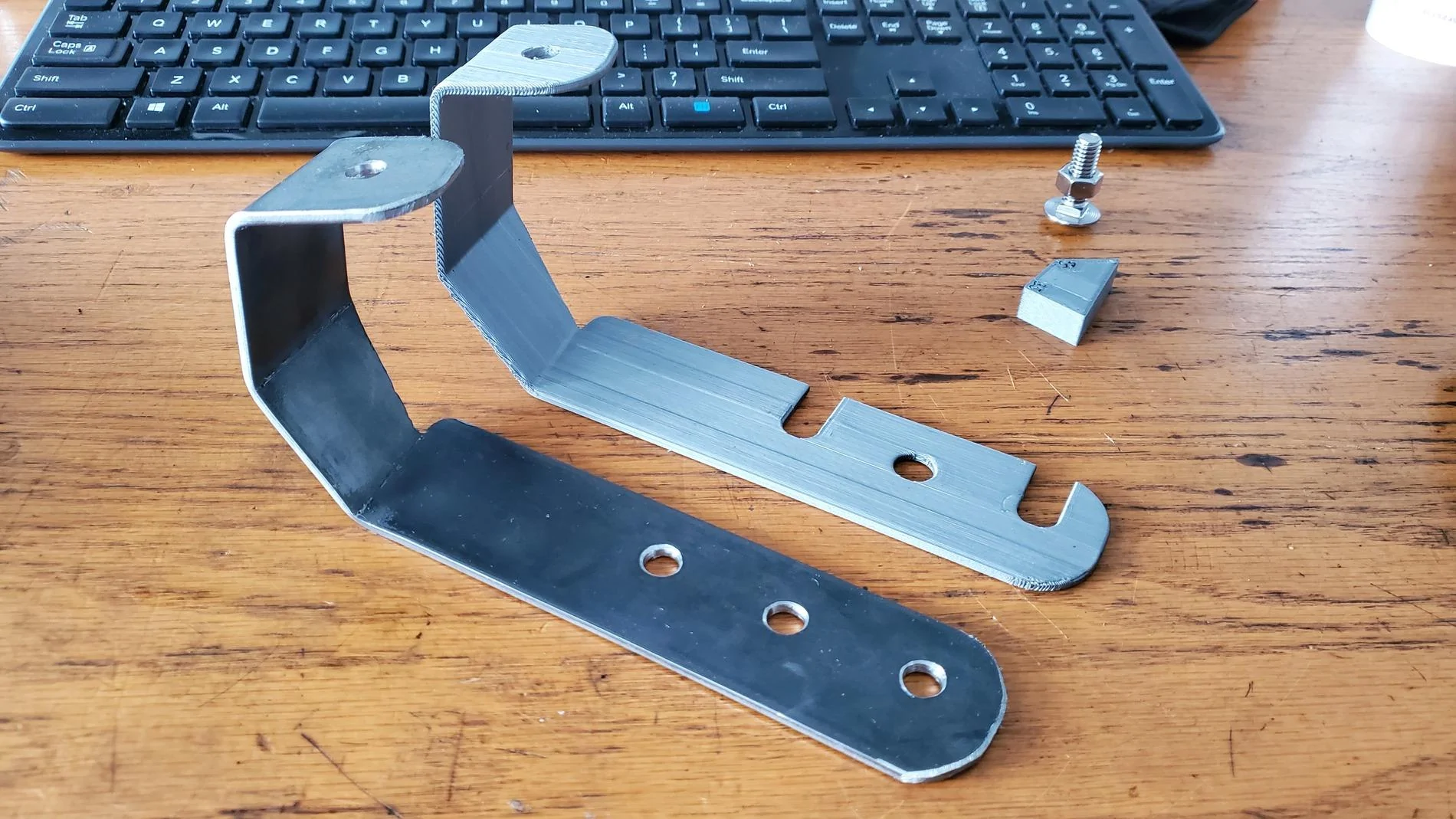

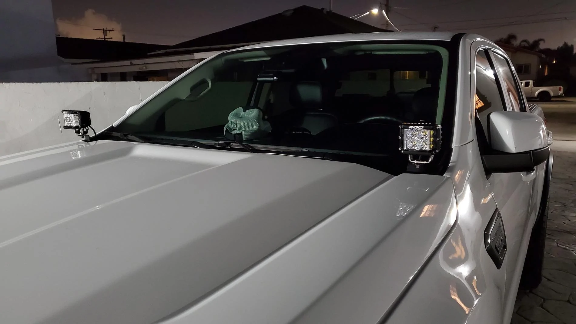

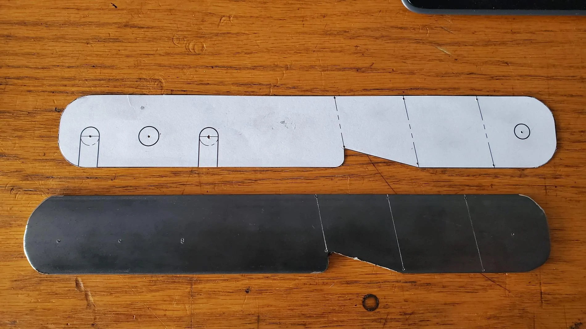

So, I did a thing. I didn't want to spend $140 on some A-pillar / Hood mount brackets, so I designed some in Autodesk Fusion 360, 3d printed it until it was right and then chopped and bent some metal.
3d print in progress: https://imgur.com/6xAHPo0
Test fitting the 3d printed piece
Printed out the template, cut it out of 1-1/2 x 1/8 flat bar steel
Bent it up and compared to the 3d printed piece
Gave em a good 3 coats of VHT Roll Bar & Chassis black
And here we are
Whattya guys think? :)
EDIT: Also, kids, don't use grinders/cutoff wheels without guards. You'll damn near chop a finger off like I did. But I saved 132 bucks! :crackup:

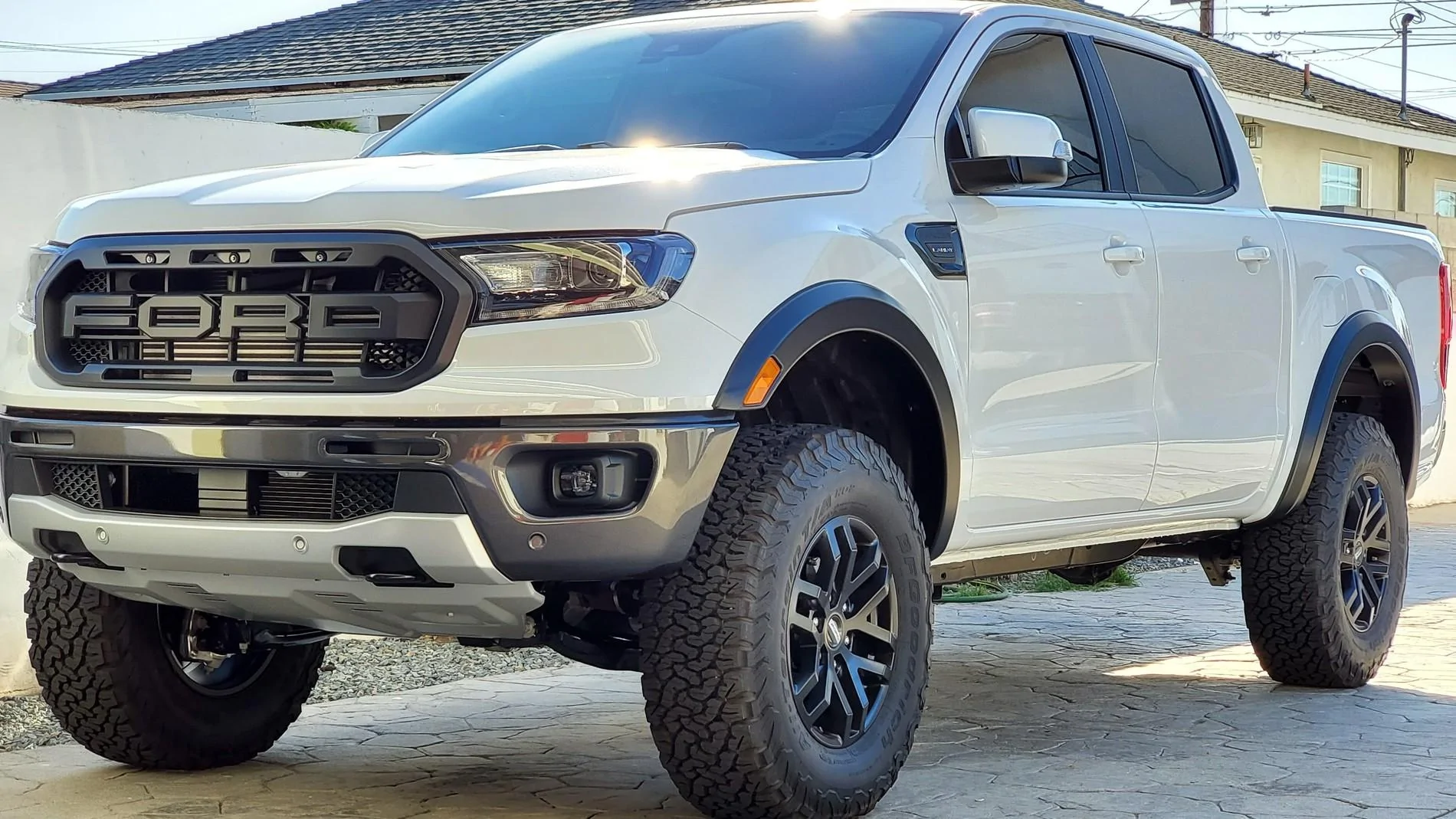

Me too, but I bought quality hubcentric wheel spacers and used red loctite on em so they shouldn't be going anywhere.
Yep, I used 1.5" hubcentric wheel spacers since the BFGs are so much wider than the stock tire, they were REALLY close, and I mean, uncomfortably close to the spindle. So far there is only minimal rubbing on the passenger side rear intrusion beam at full lock with the steering wheel to the right when reversing. I have the BDS intrusion beams on order but apparently there's some supply issue that's delaying them. After those are on, rubbing will be a non-issue.
The BFGs I have are LT285/70/R17s, Load Range C, 116/113S and ordered them from Tirerack. They are the same tire thats on the Rest of the World Ranger Raptor.
The rims are also off of the Ranger Raptor and have the same offset and backspacing as stock. I really wanted them to poke out a bit more than stock, thus the spacers.
