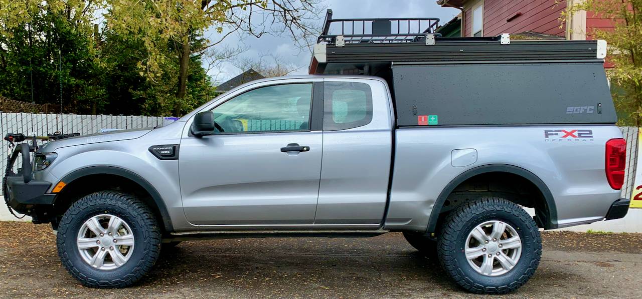

Couple of things. Those Bilstein's are great shocks. They made a world of difference with my heavy front end. You won't regret them.
if you have the funds, do the rear with some heftier Bilstein's as well. Especially if you're going to be towing. The stock capacity of the Ranger isn't great. I've got old man emu 600 lb constant load springs in the rear (but make sure you actually have a constant load, else you'll have a ridiculous rake).
Side note: You can do some pretty impressive off roading with the 4x2 if you set it up right. I've got an eaton-elocker on mine....and around $18k worth of other parts, haha. the 33's are a recent addition. Sweet.

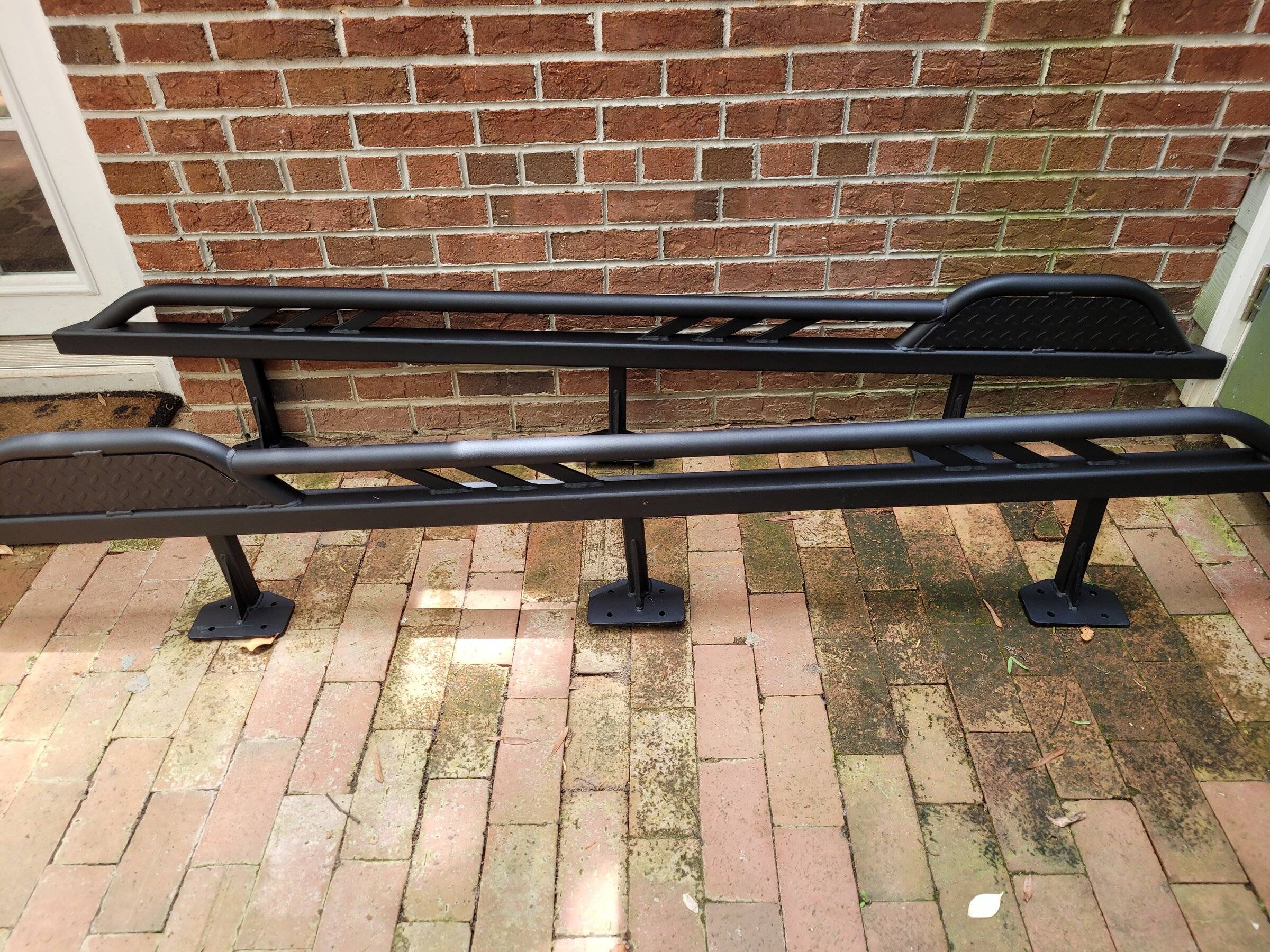

Yep, try ordering sliders. I might get my RRO sliders by the time I retire.......in a decade.
thatdarnranger
Feb 21, 2022
61
PDX
www.instagram.com
2021 Ranger STX
Infosec
D'oh. Really? Darn. I was just looking at ordering a set.

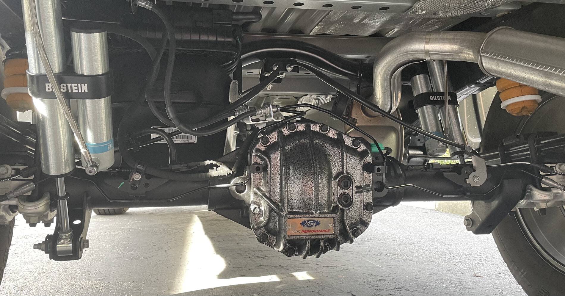

Just recieved them last week. Pretty stout. I would say they were worth the wait and I liked the price. Having them installed Friday.
BettaRanga
Mar 25, 2022
633
1,812
NC
2021 Screw 4x4 Lariat 501a Blk App Carbonized Gray
I’m doing the rears on Sunday!
