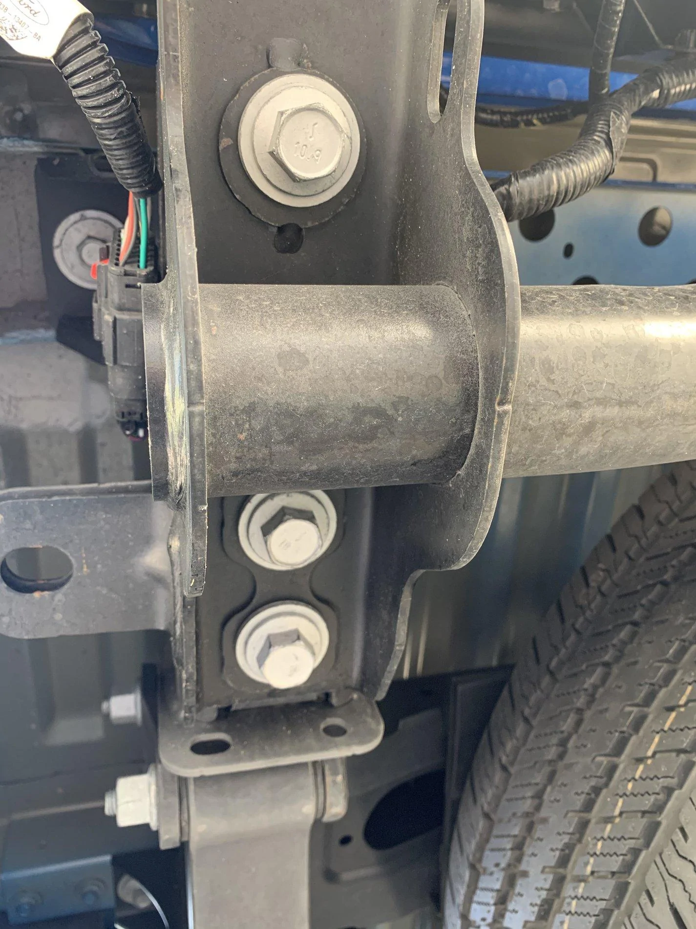

Well, the bad news is that I think this will not fit with a Trailer Hitch! Looks like the mounting bracket fits where the Trailer Hitch attaches! Thought for a moment I could slip it in between the hitch mount and frame, but there is a metal piece on the hitch mount that would interfere with the step mount! I’ll verify with the seller about the hitch.

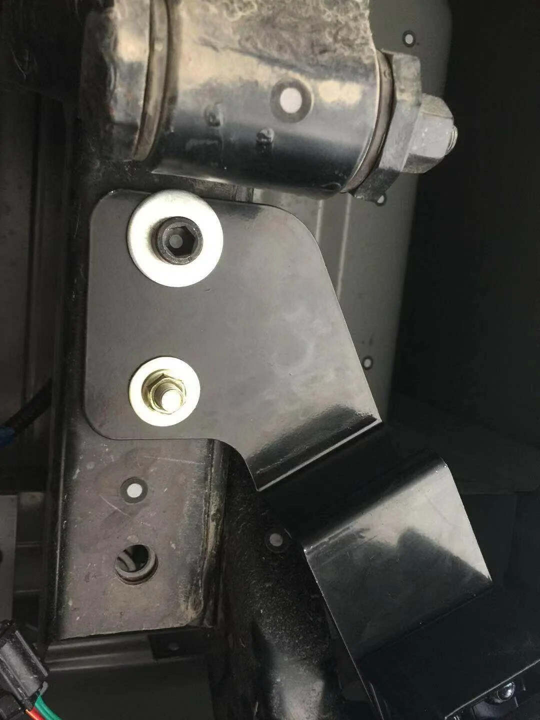

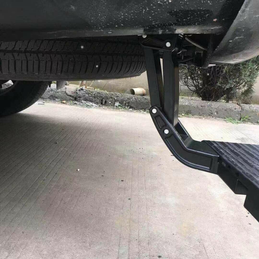

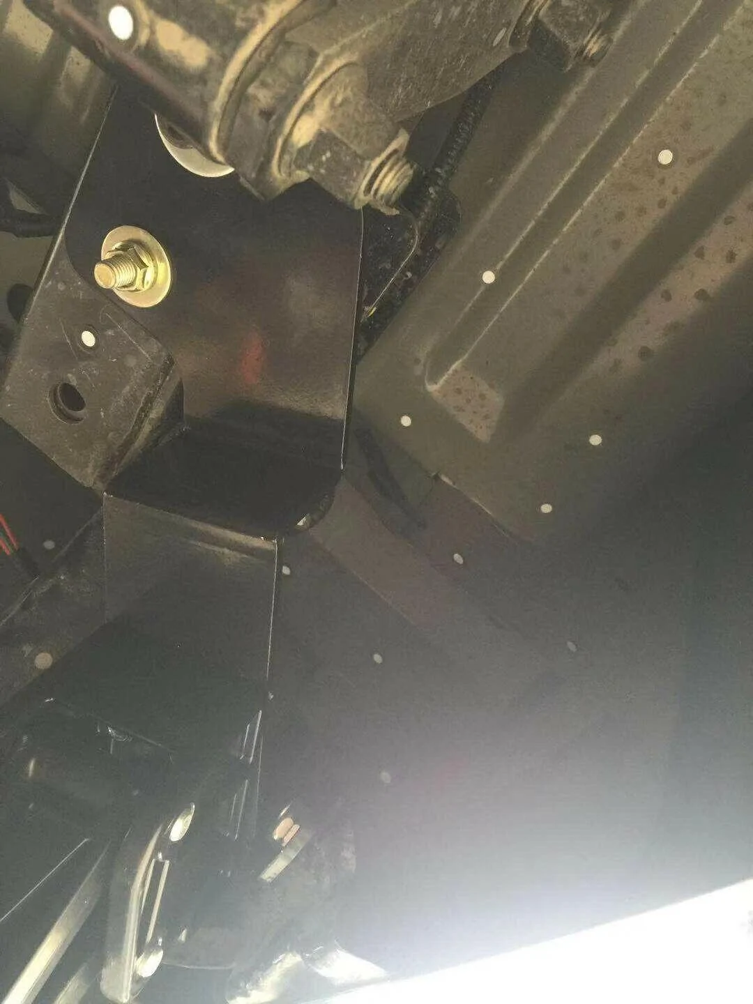

Here's some pictures of an installed Step provided by the ebay seller. Obviously NOT for a North American Ranger. Even without a hitch, there is a Bumper support Bar that attaches in the location where this Step is mounted. It attaches pretty much the same way a Hitch is mounted, so this Step WILL NIT fit our NA Rangers!

Here's some pictures of an installed Step provided by the ebay seller. Obviously NOT for a Ranger with a Trailer Hitch installed. Step mounts on the Driver side Hitch mount location.

That's what I'm think as well! But if you look under your Ranger, you'll see there aren't many, if any, options on where to attach the Step with the Hitch installed!! The Bestop example earlier in this Thread DOESN'T have a hitch!

There are definitely spots where you could probably clamp/mate a step to the hitch assembly itself, but that would require some custom parts.

You're right about that. These steps are Universal from the Retraction Section down to the pad. the upper section is specific to the vehicle it attaches to. A different attachment bracket could fit into the opening where the hitch attachment bolts are and it would work. The Attachment section with this one is obviously only for the non-hitch version and is well made for that purpose.

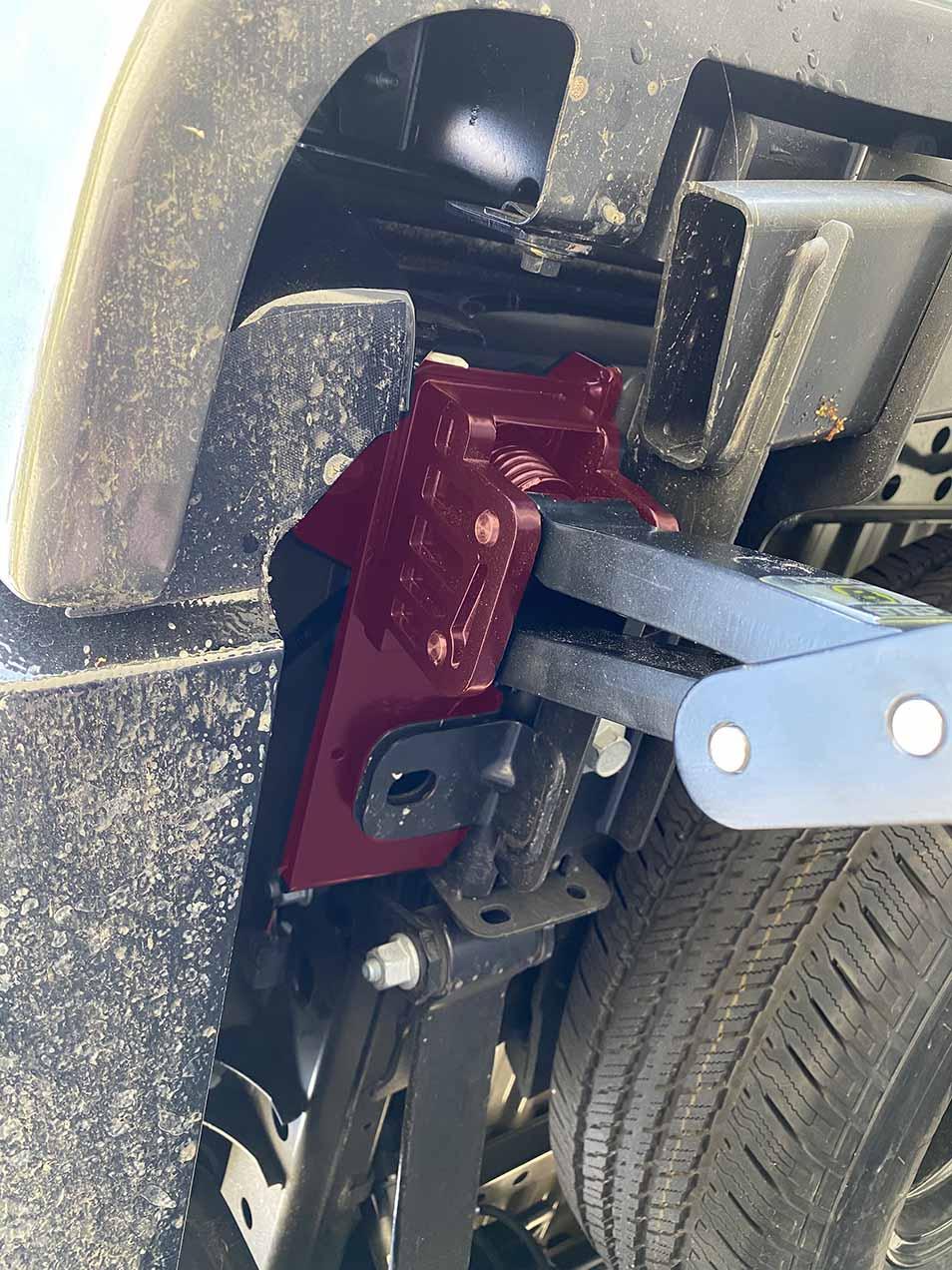

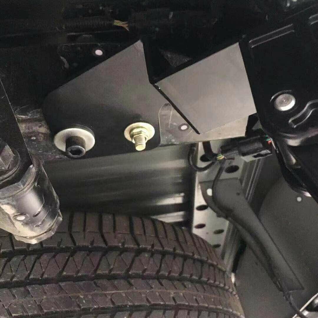

I don't have a trailer hitch on my truck but perhaps this picture will help you decide it the mounting bracket on this step would interfere with your hitch. I've indicated the bracket in red in this photo. It uses the bed hold down bolt and an oval hole in the frame forward of that frame tab. I'll also include a link to the install instructions which I found a little confusing till I had the parts under the truck.
Hope this helps.
https://assets.bestop.com/files/_bestop/7/4/4/75317_a.pdf

Could you post a picture of the mount from the perspective of this picture? looks like your step is to the LEFT of the Hitch mount area and may actually fit! The Rectangular tube on your Ranger is the bumper support tube, which is replaced with a bigger oval tube that supports the Trailer Hitch. If there's as much room to th eLeft of the Mounting location of the Trailer hitch as there is of the bumper support bracket, the Bestop step might fit. I've sent them a question on this so hope to hear form them soon.
