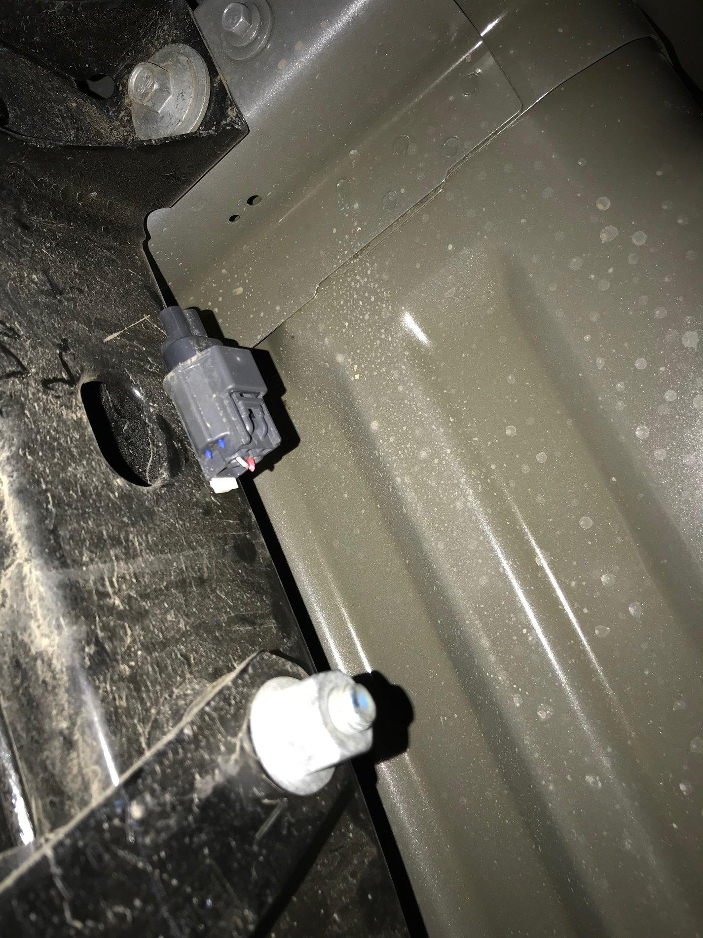

Yea, about halfway between rear tire and bumper. Should look like this pic, but the two wires on one end. This is the cut version we just left the piece there.

Thanks!! Exactly what I was looking for!! The dummy end I can source to make the pigtail

Yeah I used the bed outlet one as well. Cut the plug off. It is sitting just outside the frame rail on driver side. Two wire and just has a dummy connection in the other half.

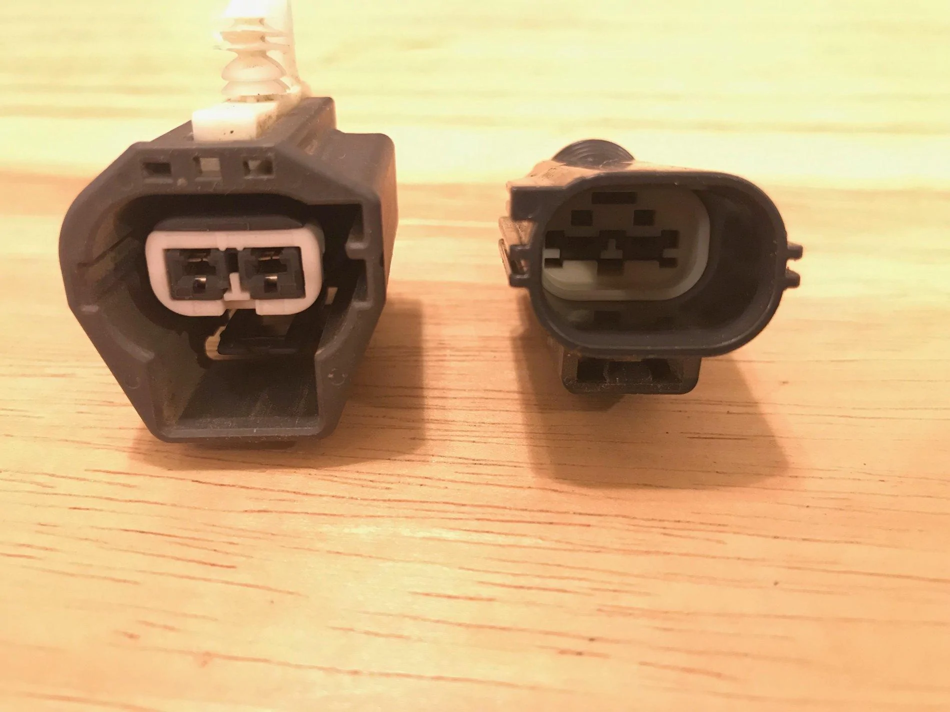

i wonder if it would be possible to find a connector to snap into this one - so you wouldn't have to cut the wiring? Anyone know where you might find one?

It kind of looks like either WPT-987 or WPT-994 - I searched on those part numbers and one is $24 and one is $31!!! Maybe I'll just cut the wires.... I'd hate to waste the money on a connector if I didn't know for sure it was the right one. Hard to tell from the pictures only.

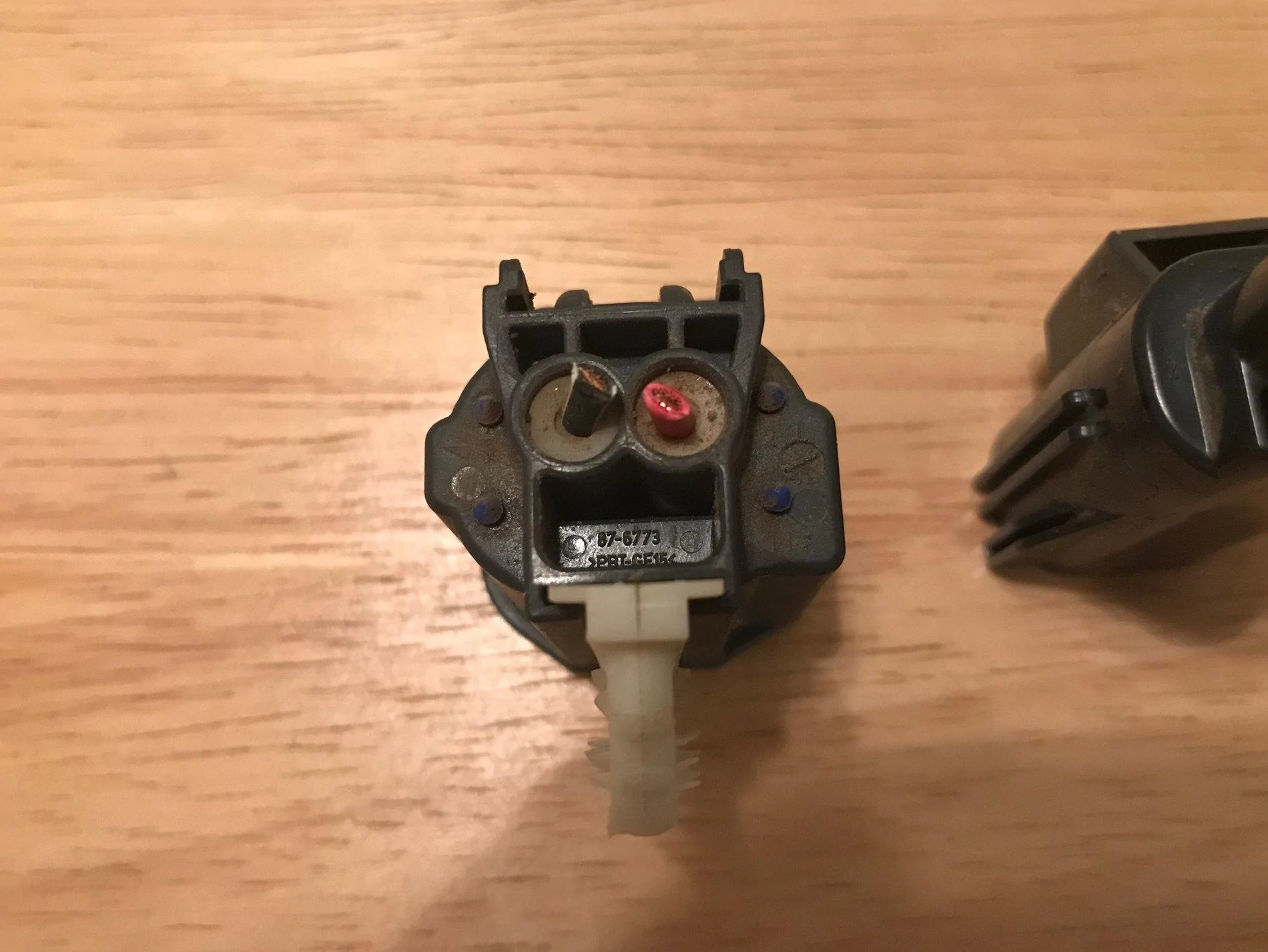

Ok, I woke up and started reading the thread and got a wild hair. Why not just reach up and pull mine off since cut the wires and it's got the end plug. Here's what I found. Connector end that cut the 12V supply wires off of has some stamped numbers. 87-6773 and >PBT-GF15<
Googling those numbers gives some interesting results, but not sure how to find the MATING plug. That just shows th eplug you have, not the one that plugs into it. In your pictures above, is the plug to the right just a cap essentially?

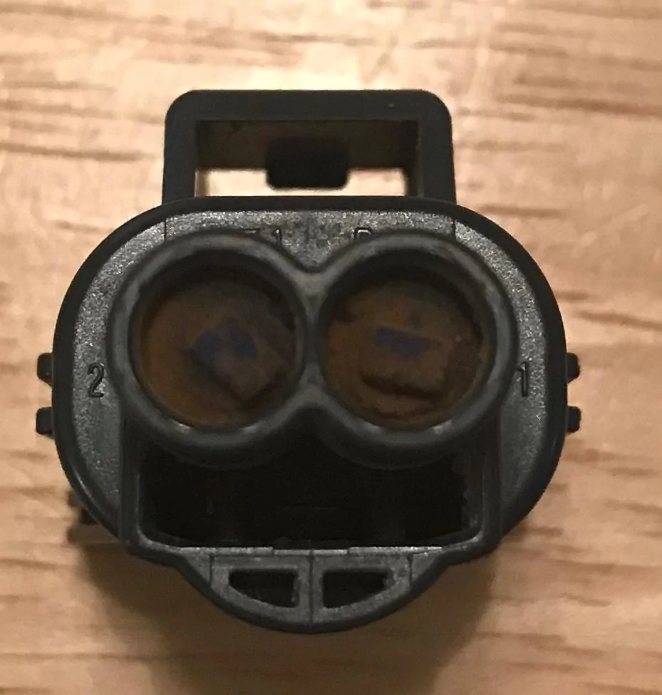

Yea, it's kinda like a cap, but it inserts into the powered end but the two wire ports are just plugged.
Are there any numbers on that plug like the other one?
