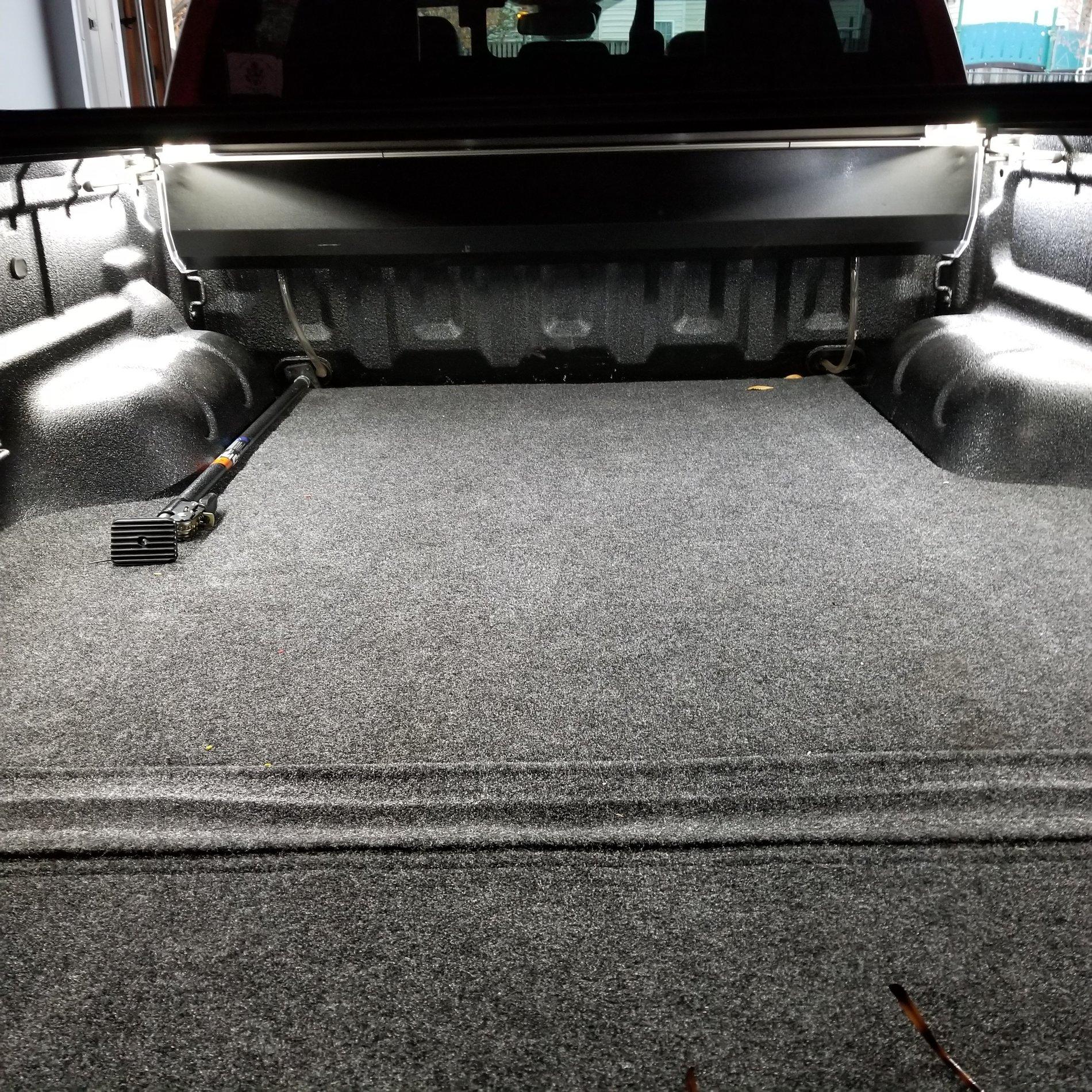

Found this kit on Amazon made by Nilight that comes with two 60” LED strips that fit nicely along the edge of the bed even with the Bedrug and tonneau cover mounting hardware. Really lights up the back with a simple switch, I’m very happy with how it came out.
Nice.... Needs some pillows... Cozy for a nap, lol....

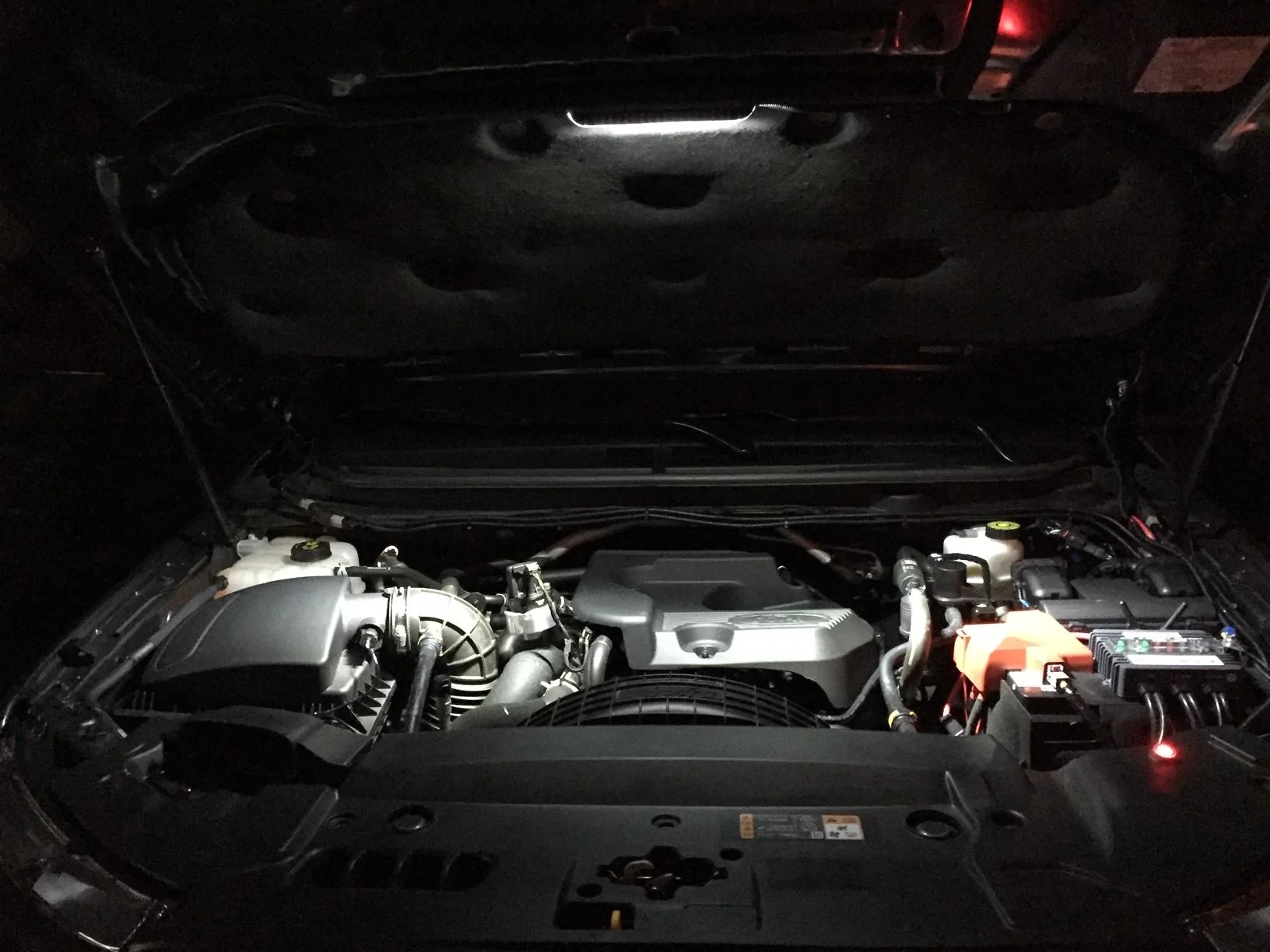

I put some bed lights in today. I used the dummy connector from bed power wiring harness. It was pretty easy, I pulled it off and made some connectors with molex pins like @RedlandRanger did. I also put some lights under the hood with a switch that is activated by opening the hood.
Very cool...I did the same for my hood but with a manual switch...

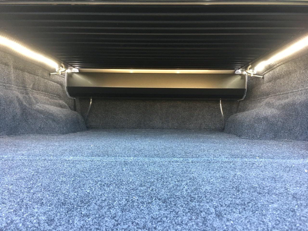

I just put in the 2 60" Nilight kits off of Amazon. $22.95 for 2 60" LED strips. Tied them into the 12V port plug like MT19Ranger did by making connectors by grinding down some male spade connectors. I only wished that this connection was live all the time. The picture is with my Retrax Pro cover closed.
Looks good, real good.
What sort of switch (if any) do these come with?
I'm almost certain if you were to get the schematic for the circuit you tied into you could configure it to be hot all the time. No doubt the plug you tapped into is also tied in with the interior 12 VDC circuit. If there is a relay in the circuit the task is made all the easier.
Perhaps another member has an electrical troubleshooting manual of which he could send you a copy of the circuit diagram?
That looks good! Is it only live when the truck is on and for a set time after it’s off?
