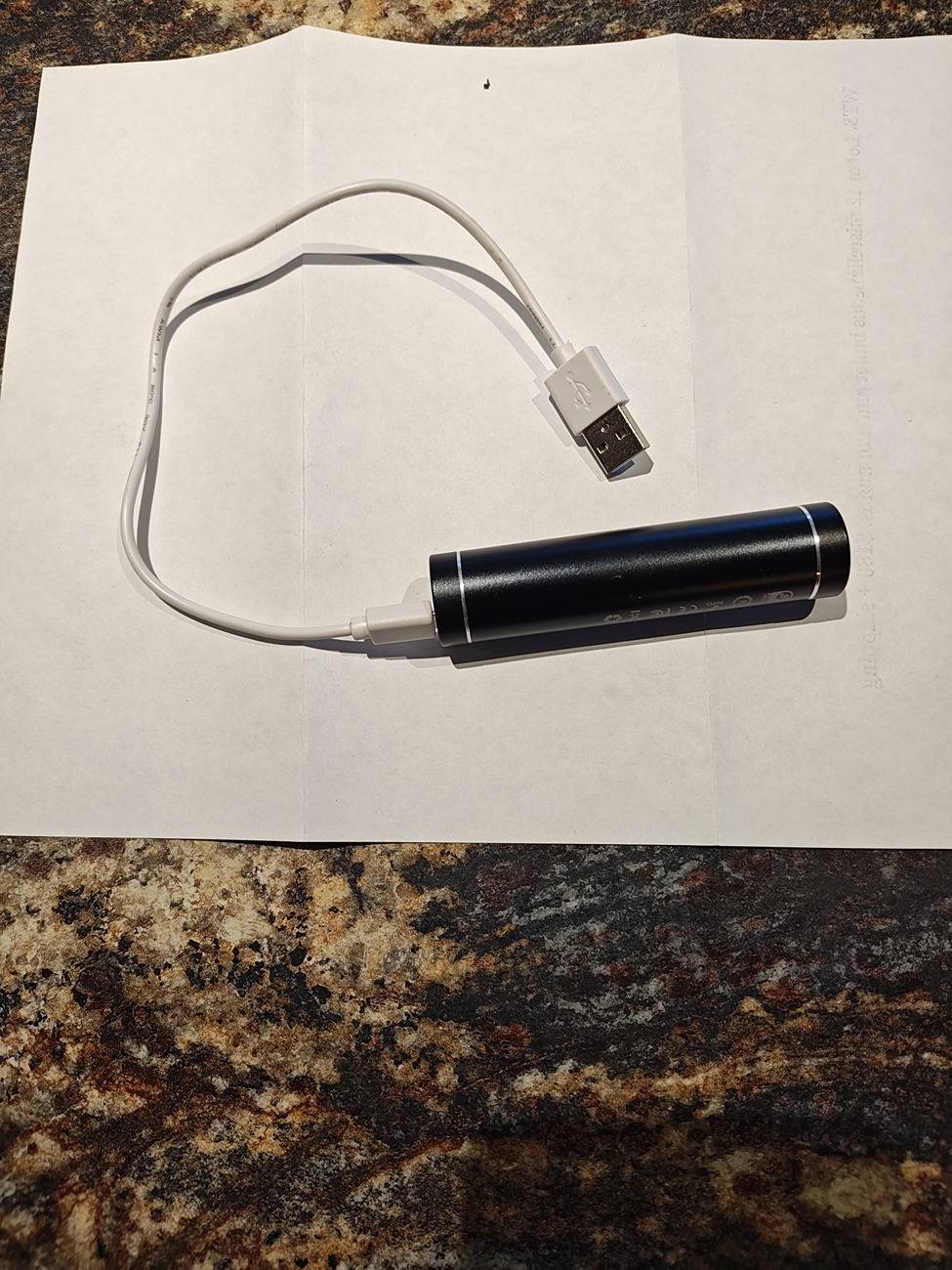

Could these be used to back feed low voltage to feed the controllers with a 5VDC USB power pack?
Or could I attach my low amp battery tender to the battery cables before removing them?

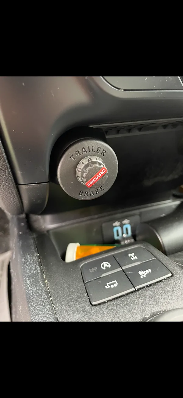

I took the one power socket out and installed the brake controller in that position. Clean and neat.
