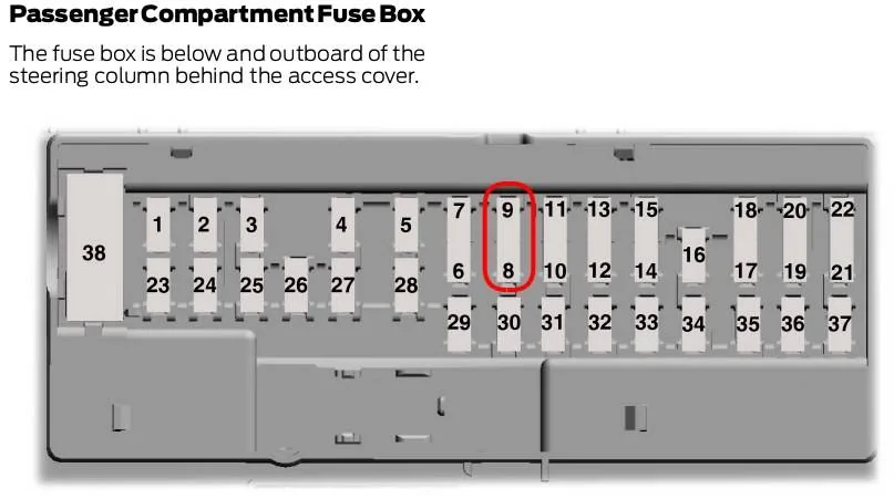

I pulled the Telematics fuse 9 (Driver's side lower dash panel fuse box), added a single 10A fuse in fuse slot 8 for the security horn. The fuse on the right is the original two in one fuse. I installed the 10A single fuse in the left most section of the shared double fuse 8&9 slot.
The panel is oriented vertical in the truck, not horizontal as shown in the owners manual picture below.
I pulled the double fuse in lost 8-9 and inserted the single fuse into slot 8.
SLOT 9 is the Telemetics fuse location.

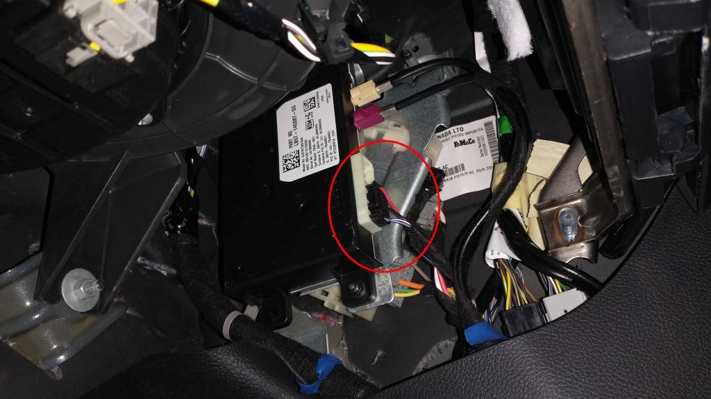

I then unplugged the cellular modem in the passenger foot well. I didn't even drop the glove box, simply looked up from the foot well and removed the big plug in the white socket. I left the 2 antenna cables plugged in.

Here's the Modem location in the passenger footwell and the cable that I unplugged.

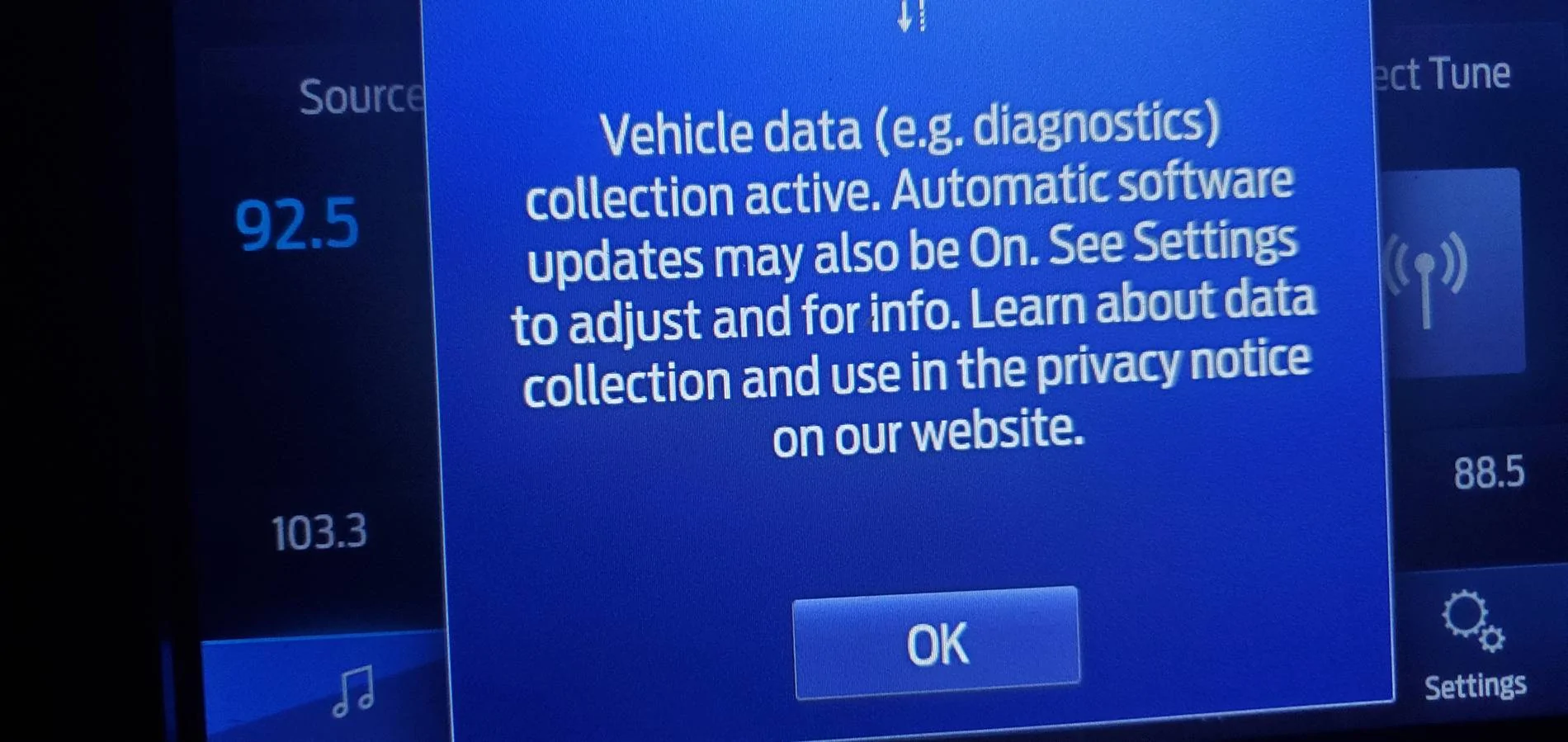

A screen pops up on my radio every time I start the truck
