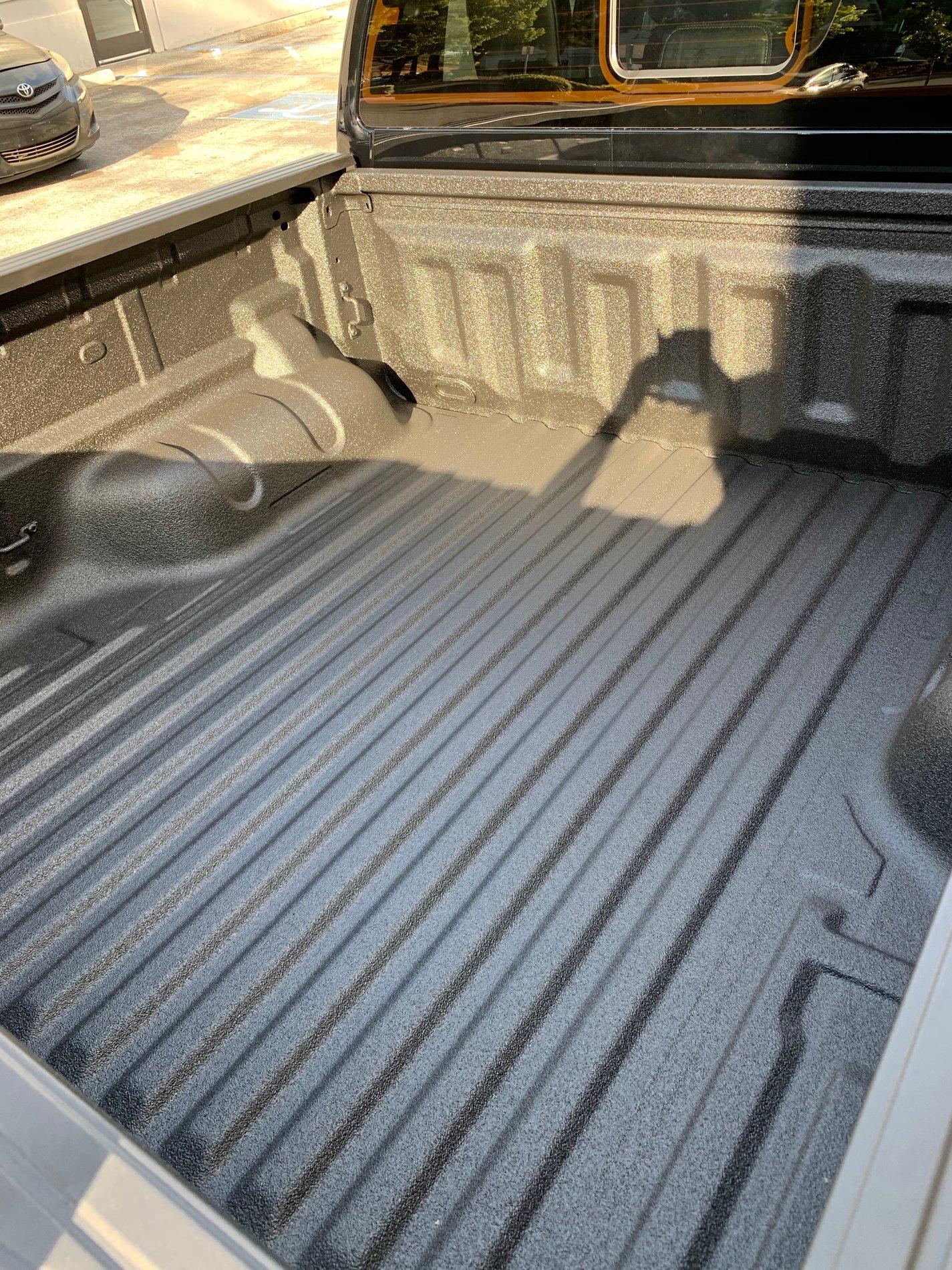

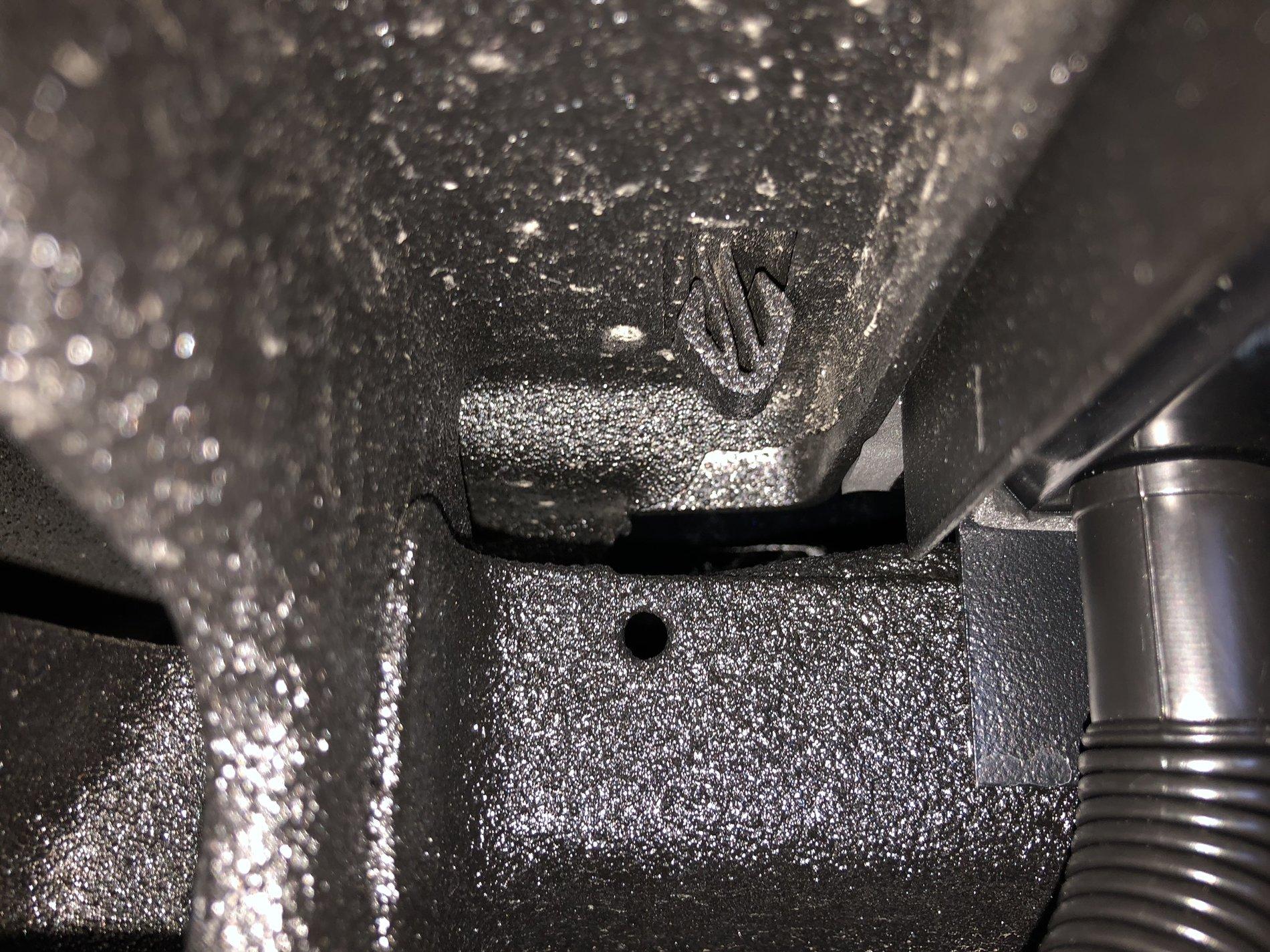

Has anyone installed this cover with a linex bedliner? Just got my cover the other day after having my bed sprayed. I see comments here about the bulkhead accessory rail included with the cover and that it should attach with pre-existing holes but I dont have holes on the bulkhead bar. I dont recall seeing them before I got the bed sprayed and they definitely aren't there now. Wondering if anyone else has a bed without the holes or a bed thats been sprayed that had them filled in somehow?
Washashore
JM
Apr 7, 2019
114
97
Cape Cod, MA
2019 SCab Lariat 4x4
The holes will be 4 inches in from the bedcap on each side. See diagram 3 in this link.. https://truxedo.com/images/Install Guides/1118322_InstrRangerBulkheadAdapterInstallationREVC.pdf
Ignore the comment about drilling (this only applies if you have a drop in liner). You should be able to clean the holes with a sharp knife or a file
